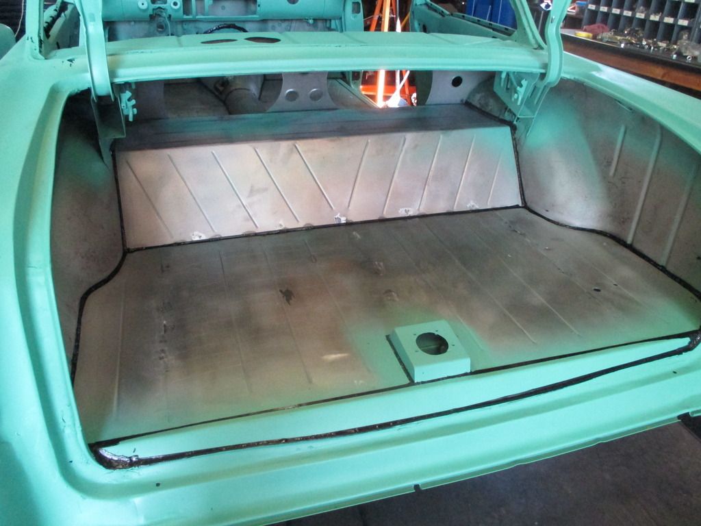

    rockers, floors, trunk, and inner rocker where very rusty and in need of total repair. it was decided to custom fab it all instead of going back to the way gm intended. while we where at it, the body was channeled down approx 3". rocker now rest fully on mother earth.
    stock rusty floors. rockers
    rusted threw the top shock x member
    trunk

    been making some good progress on this build the last couple weeks.
    got tit all mocked up, broke down, chassis sent to powder coater, body was blasted and primed. floors have been under coated with bed liner and seem sealed. final assembly has begun.
    fab brake lines
    interesting filler , old nails..
