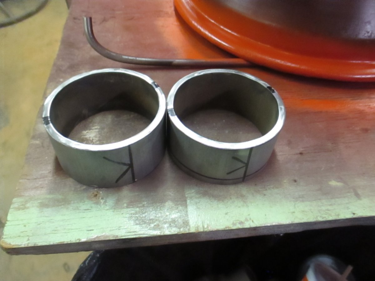

  3. King pins and bushing replaced backing plates drums and new bearing greased.
    The frount halftime is restarting to looking like something.

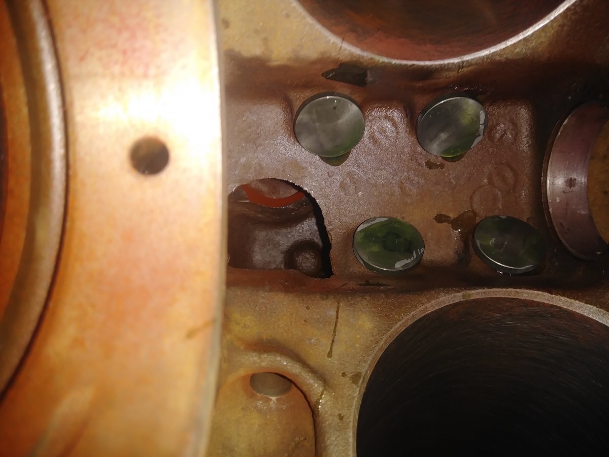

  6. Well I am wasting time due to mud dobbers. Thought ever hole was plugged on the engine.
    I went to turn it over by hand it felt funny then a clunk.mud fibers nest hitting bottom of oil pan.
    The only place I missed was the down draft tube,I figured the filter would be enough wrong.
    Now tore it all the way back down pulled rings,piston pin and been cleaning all the ***embly lub of everything.
    Making sure there was no dirt left.
    Those dark gray ares on the power forged pistons there from the box probley got wet setting on a shelf for 60 years.
    Okie Pete and kidcampbell71 like this.

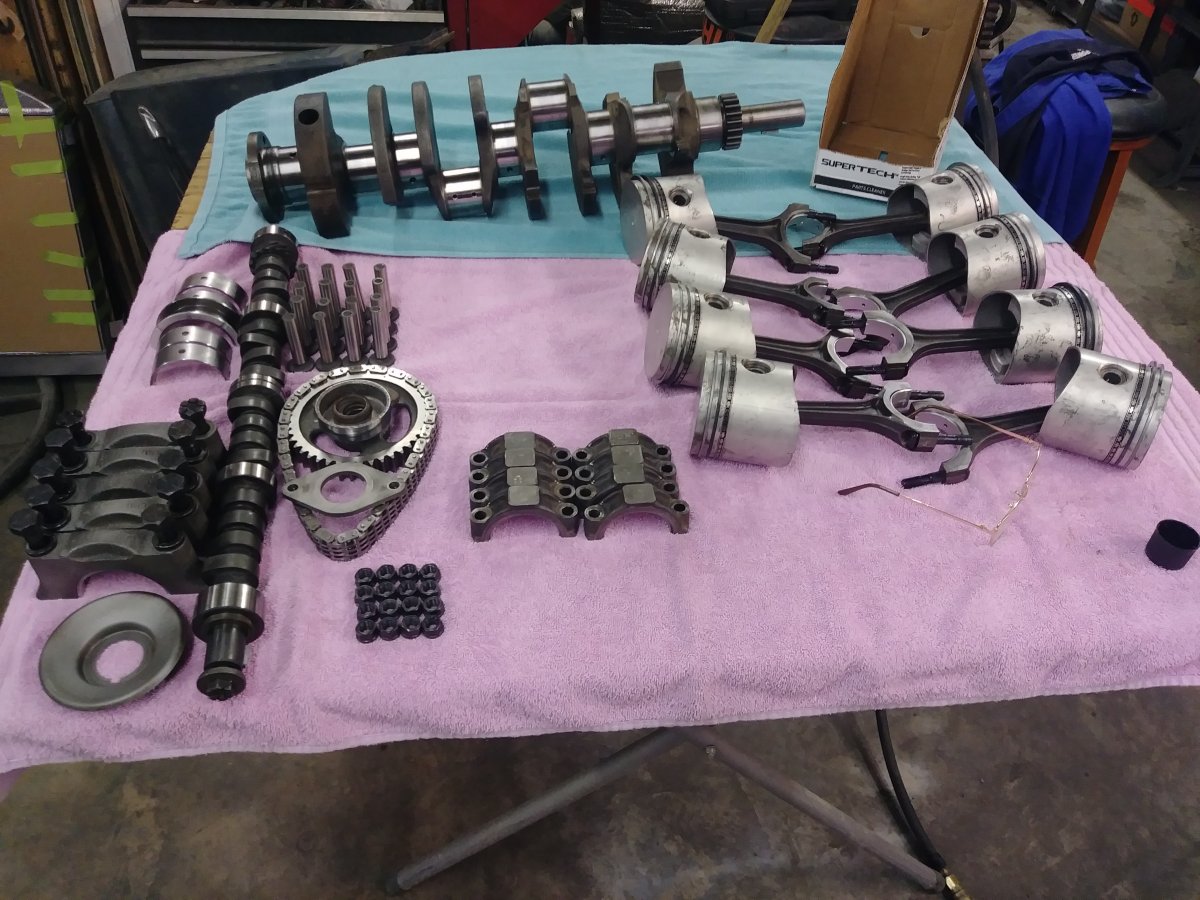

  7. Everthing but rocker shafts has now been cleaned.
    Temp put it together so I could paint it ford red.
    I like seeing unpainted gaskets and black bolts on my engines.easier to convince someone it was act rebuilt and not just wash and sprayed.
    This one got everything and then some.
    Thought the bell housing wouldn't look better in cast aluminium.
    Let the heat bake the paint tonight and put it back together sat.

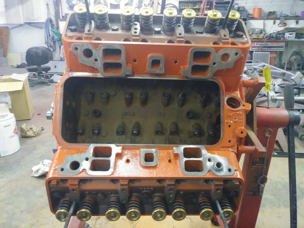

    First up I use Lucas ***embly lube.
    If you have never done a yblock before here some interest facts. There all solid lifters. The lifters look like Ford was playing a joke. The lifter is the first thing you install it goes on from the bottom.
    Looks stupid
    It slides in
    First 4 in
    My cam .C120 supposed to be a NASCAR grind in 57-58
    Here is the cam in place with out it the lifter will fall out

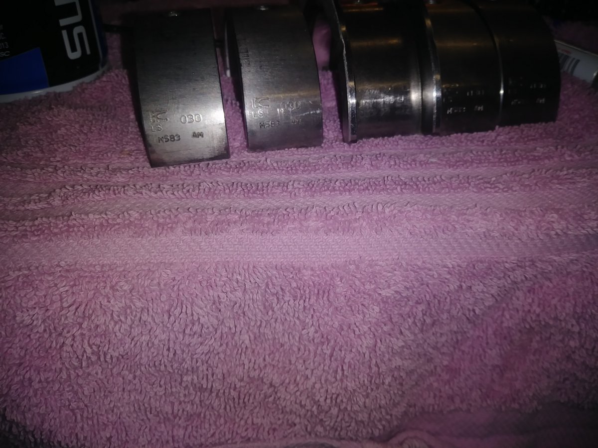

    I use King bearings crank is.010 on rods.030 on the mains
    When there turned make sure the filit cut is still there
    And of course spend the exter to shamfer the oil holes
    There a lot of part on the cam first a thrust washer tq bolt to 18# then a sleeve followers by the cam gear. A counter weigh The fuel pump excerenta .another spacer washer and then the bolt
    Here is some total screwed up the dots on the cam and crank gear face the driver side. There are 12 pin between them see them in purple
    Here is some thing else to watch 1head gasket goes face up 1 face down look at the left Conner top see how the gasket is round well that backwards the gasket need to be turned over on the driver side so there is a conere at the frount on doth sides
    Here you can see the head gasket corner near the valley pan on both sides. If 1 is round like the rear it is on wrong it will probably overheat.

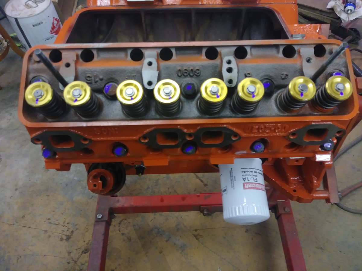

    Alway use new valve springs I also us aluminium retainer to drop some valve train weight
    I mark everything with paint to verify its done this one purple on bolts and retainers
    As any thing is tighten the last time it gets marked no guising around here

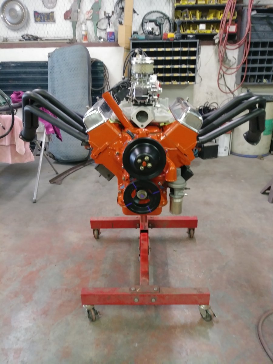

  9. Yblocks why do they have to be so different
    Bottem done
    Marked the balance every 90 deg to help adj valves
    Another od thing there a rear main cap and a rear seal cap.
    Timing cover done using the pump with the filter built in.
    Here is a hint when the timing marks are set per the books. Basic at 3 position with 12 link between then drop the distributor in on# 6 cly.
    To adj valves turn crank 1 tune that # 1 cly set the valves #1 rotate crank clock wise 1/4 ture (that's why I mark the balancer) adj valves for next cly in firing order repeat. 20180429_141336.jpg
    I used a msd distubator so I will have lots of spark
    This should kook mean coming downs the road.
    Engine is ready.

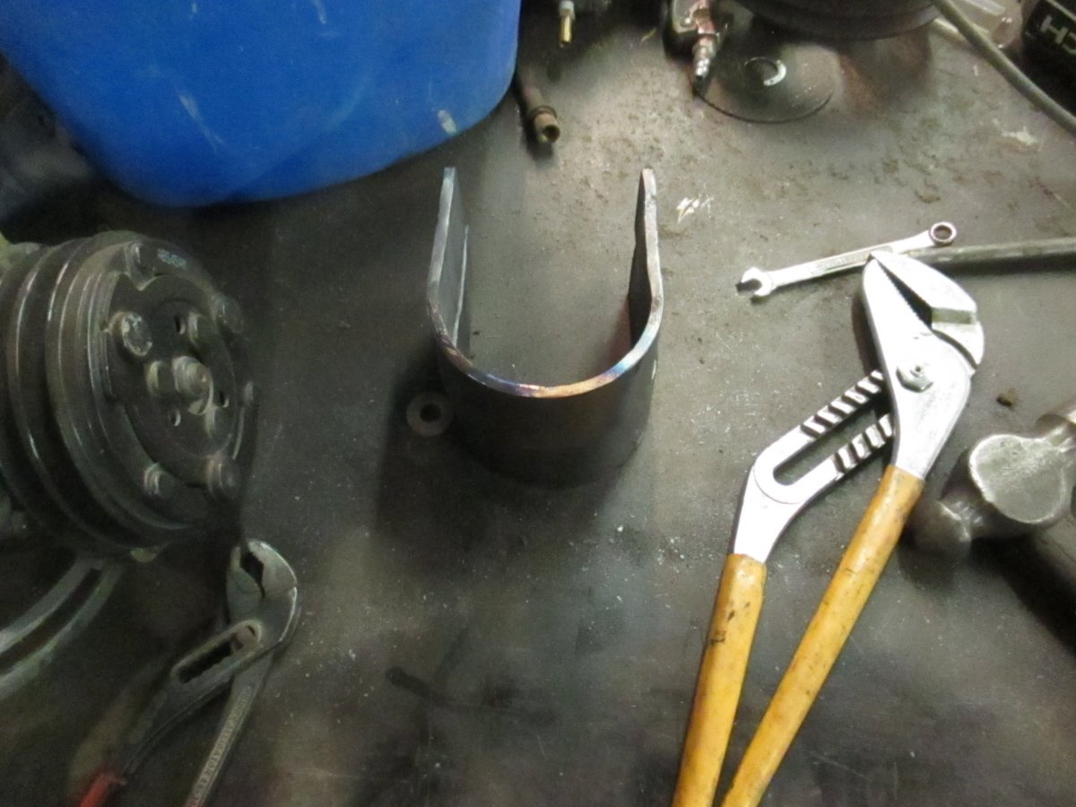

  11. Simpel alternator mount. One of those high dollar generators that is an alt would look better lol

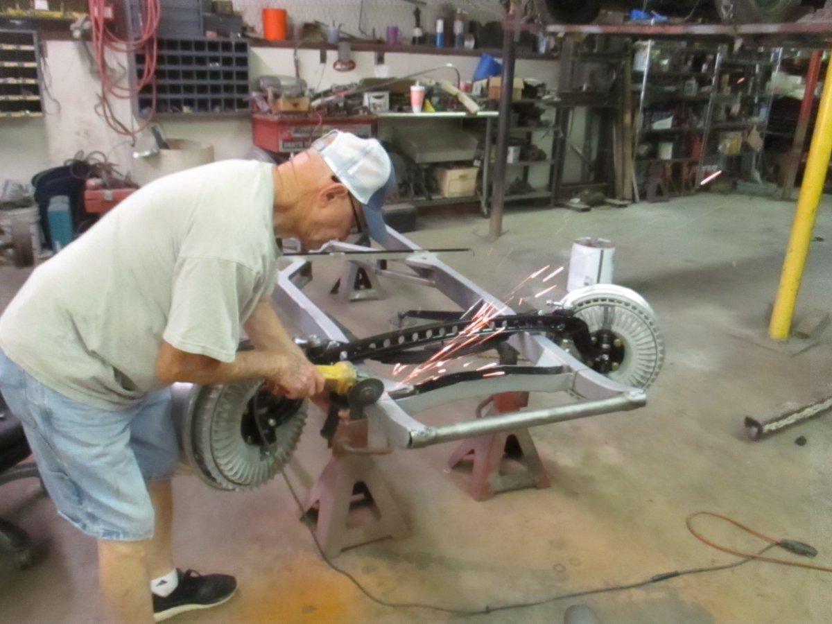

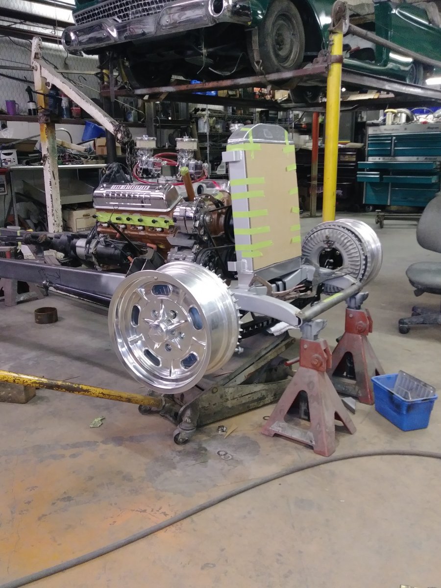

  15. well vacation is over now back to the 100 degree Texas heat. me and Glen sat and looked at it and it was just to high for our taste so since the Speedway wish bones are set up for a spring hanger I decided to use it. IMG_1448.JPG
    flipped the frame over and looks like I might be able to ***** the frame horns and kept them.
    Layed out a line
    and turned glen lose I just did not have the hart to cut the
    few minutes later and now there gone
    put some of it back together
    set frame where it would work
    final height 6" between frame and ground at the front, 8" at rear , 5" at pan
    I figure it will still drop 1-2"more when done should be just right for me anyway. now I have to dig out the sedan body everything changes around . decided to put it on this frame and take the old frame cowl, door and ***le and see if it will sell

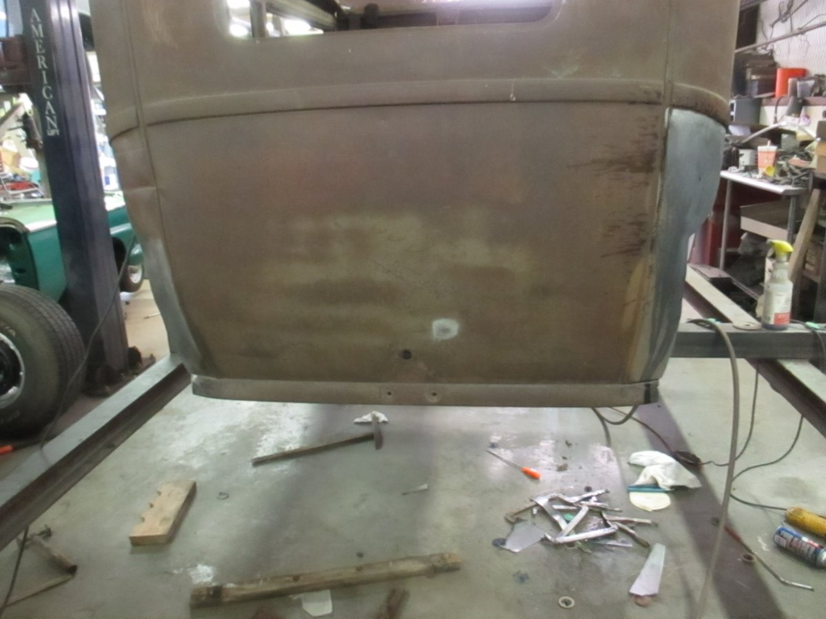

  19. Here is one of the reason I like thinking about cutting before I do it last night I thought I had my mark right to cut the fenders after thinking about it ?
    Iand cooling off I realized I did not figure the rubber on the front tire
    new cut line is 5" lower then yearerday
    not sure If we will use the original rear cross member and spring but there worth money so we will hold on to them for now
    it still amaze me how much tension is on these rear springs
    Okie Pete and OFT like this.

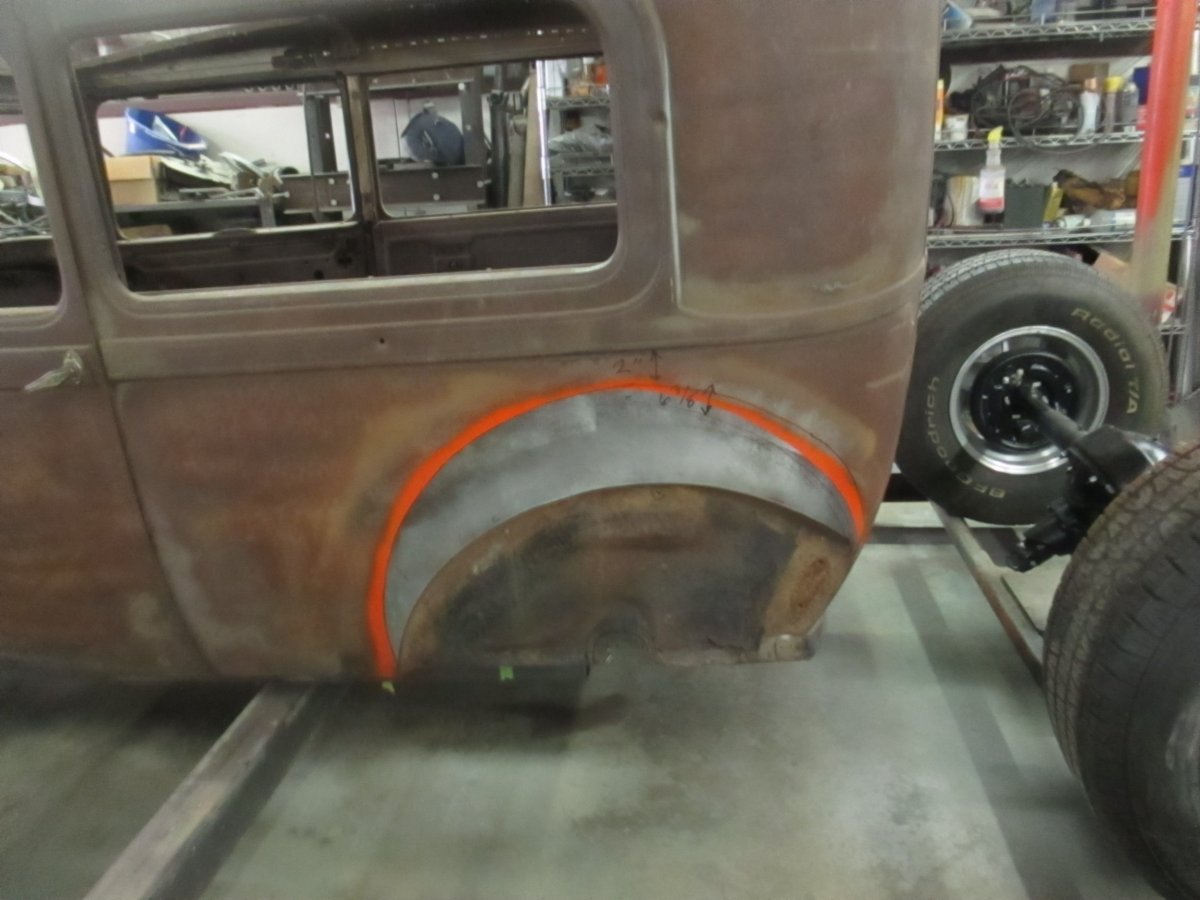

  20. You look at it and look and finely all you can do is just cut it.
    wheel wells are cut right or wrong that's where the tire will be .
    got the rear seat pan out next some bracing and figuring out what type suspension it will have in the back.
    the picture that's taped to the body is close to what I am looking for as far as ride height.
    wheel well is cut out 1/2 " larger then the tire and there is 2" from top of tire to the body when it will be at ride height.
    IMG_1509.JPG the mess made from a simple job
    nice big hole to fill in
    for being 90 years old not a lot of rust
    some wont like this but the drag link is going in front of the radiator it wont fit be hind it or under the frame . It is what it is looks like I will be able to reattach the frame horns using a pc of heavy wall 3x3 c channel pointing down.
