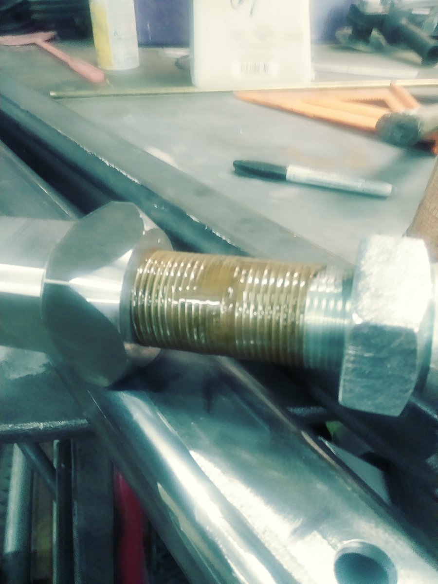

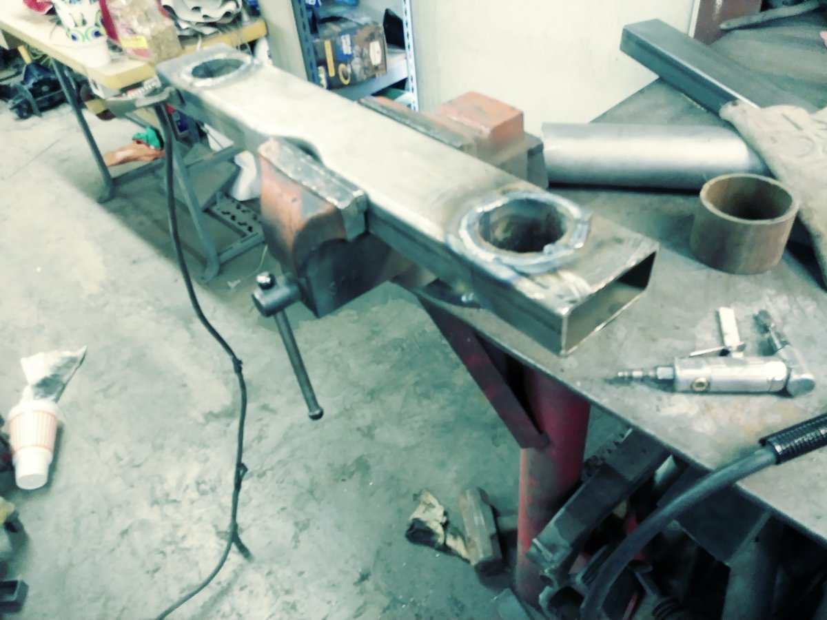

  17. 2X2X1/4 sq tubing for the truck arms
    Grind out the seem so the bung will go in.
    I also drill 2 5X8 holes to roset weld
    Front of truck arms done
    Next the cross member same 2X4X1/4 the frame is made of. A notch in center for trans clearance and 2 holes for exhaust to go through tubing in holes is 3"of 1/4 wall. Still need mounts for truck arms.
    Also 6 of the body mounts ✂ out of 2X3X3/16 tubing

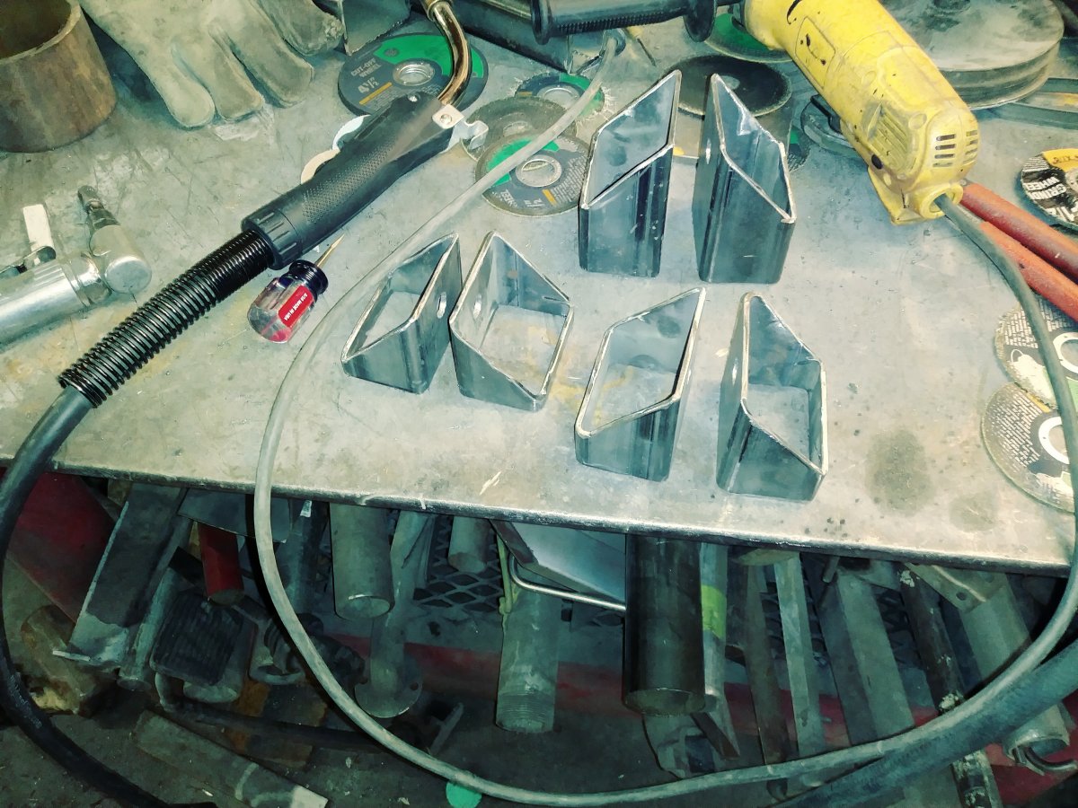

  23. Time to make some axle pads
    I need 2.5" more drop so I made the axle pads out of 2X4X1/4 tubing. Boy they look warped and twisted.the notch for the axle tube has to be at an angel becouse the rams are at an angel.
    Here is a side view since I had to notch the pads at an angel figured I would build the drop blocks right in.
    Took some serious work the get to the point of welding the lads on.
    I put the rear end in the car install the blocks Ubolts set the pinion angel clamped Everthing down tight and tacked the pads(blocked)in place.
    Pulled it back out and welded it up.
    Put the rear back in Got it close to where it goes for now.
    When I get the frount done and the body bolted down I will squair it all up.
    If you pool close there are holes in the pads that will be used for alignment bolts the arms need to be drilled and taped at that time.
    Need the spring or bag and wats link yet.
