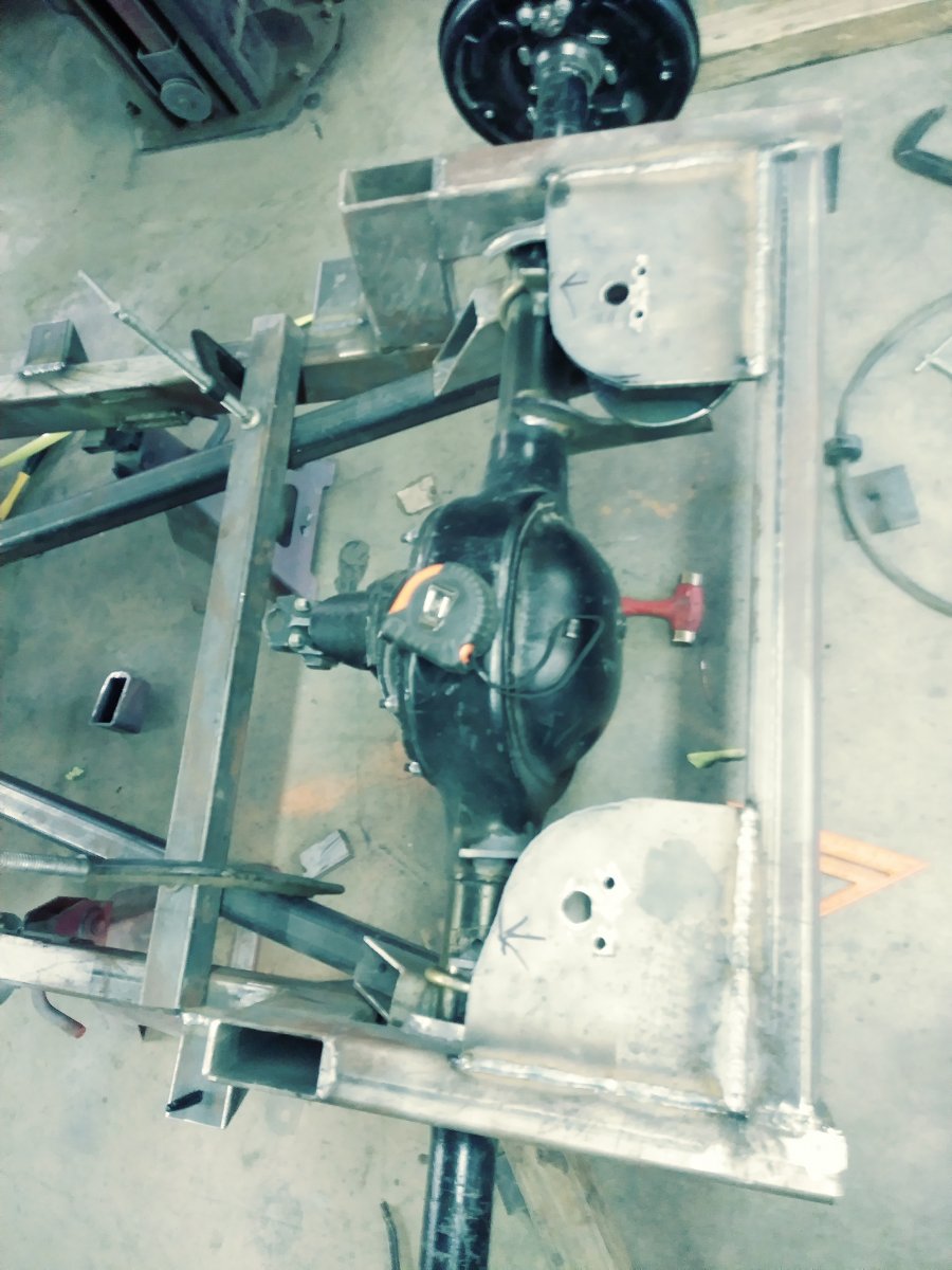

  1. Working on the rear kick up on the frame.
    Normal the top is parall to the frame.
    This would mean the rear seat would need to be raised at the frount to make it comfortably(flat seat is not).
    I may run the top of the kick up down 2" at the rear.
    This wouldn't also slope the rear seat down at the back 2" giving more head room.
    3"X3/16 band used for trans tunnel sloped on drivers side so I have a little more room for the gas pedal.
    brEad likes this.
  2. Let the fun start
    Welded the body mounts to the frame and pulled the body.
    Got the frame level again
    Installed the kick up got them squared up and level
    Now need to weld them.the top of the kick up runs down hill 2"for them seat bottem

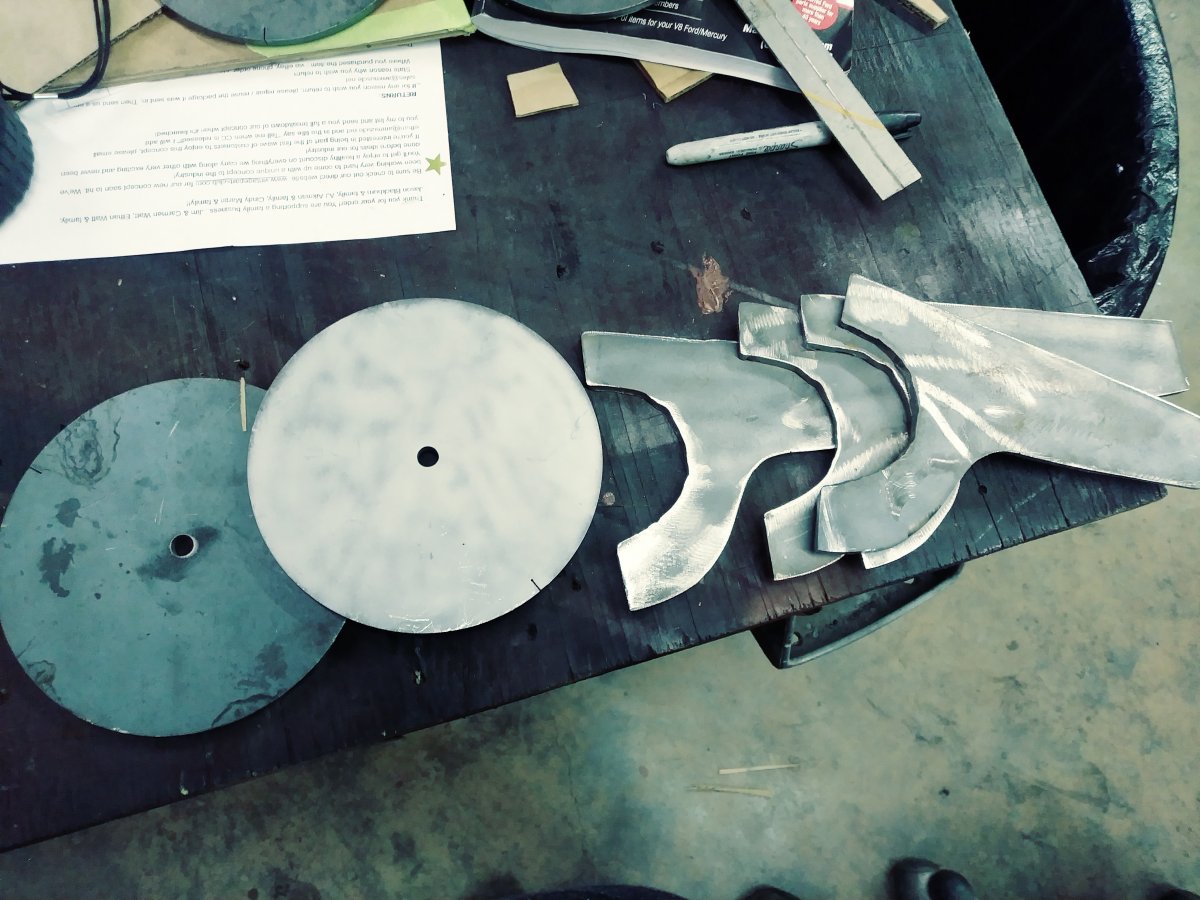

  3. I seam to go thru a lot of 1/4"plate.
    Air bag mounts are nothing fancy just simple pc cut from 1/4"steel
    Lower mounts installed
    Bags set on
    Upper mount again real simple they will tie in to trailer hitch

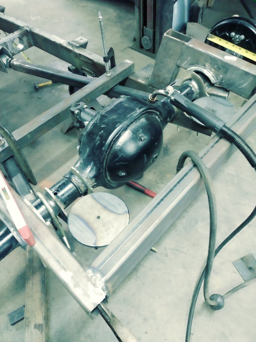

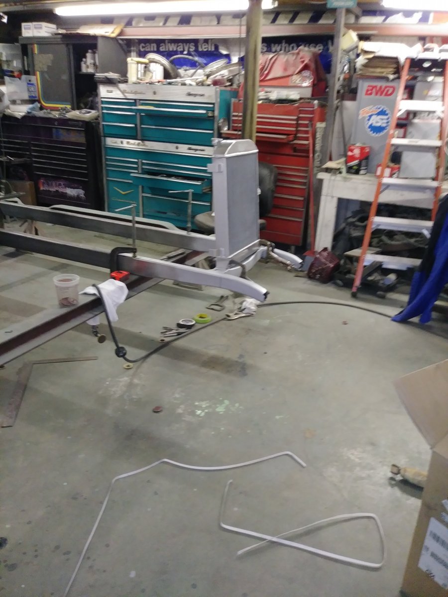

  5. I have been slacking off 3 week vacation now time to get back to the MODEL A.
    So far Everthing but 1/2" of the master clyinder bracket is above the frame.
    Rear kick ups are in and body back on frame so I can do the subframe under the seat.
    Also go the u support for the rear axle to trave in installed.
    Better shot of the u there 2"x1/4".
    20181019_125836_Film3.jpg Need floor under seat yet. Lots of wielding and t******* to do once Everthing is fit.then blow it apart clean up the brackets.finish the welds.bead blast and paint.
    Another shot of the u
    And this is at ride height.

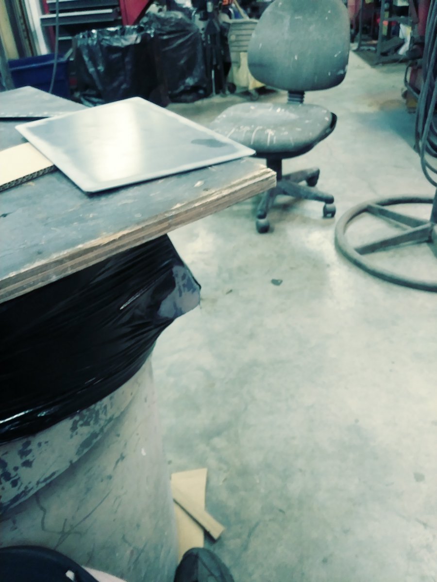

  6. More of that cut-fit-welding going on.
    Using 11ga sheet metal to fill floor. Resesing it 1/4" for the sound dreading and Dynamate.
    brEad likes this.

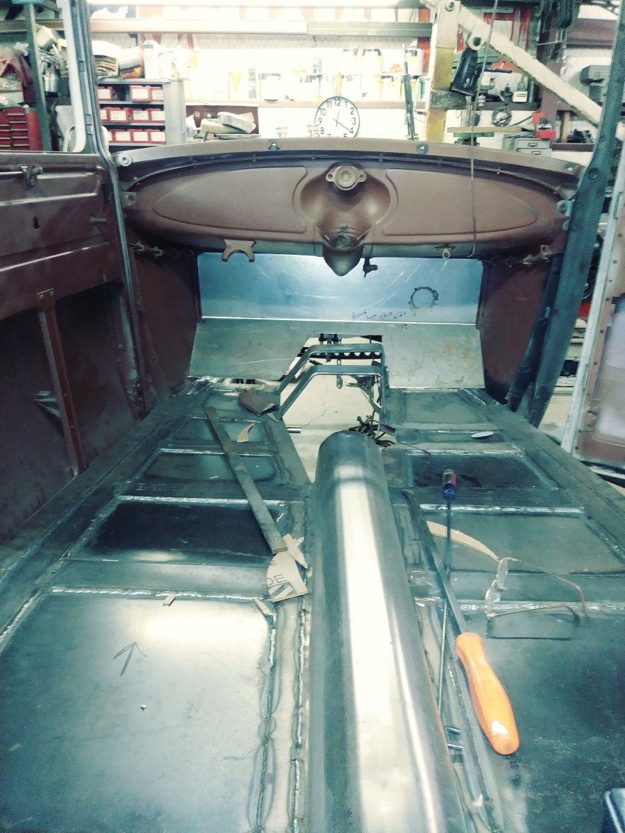

  7. As I said in the beginning I would work on it about 2 hr a day 14 hr each week to see just how long it takes to build.I have had a vacation and spent 20 days in mn with family problem. Just like everyone runs in to.
    Now I'm back and working the floors.
    I'm cutting 12ga inserts to fit in side the 1x2 tubing . way heavier then it needs to be but I know it will last 100years and if I get in an accident it's that much safer.
    There getting welded in solid from the top only.
    Just as you get going we all seam to run out of parts. I ran out of 12ga so on to the tunnel it is 14ga which is the heaviest I can do with my brake.
    I will mark the loops and drill holes to spot weld the tunnel to the loops.
    I will also weld the bottem of the tunnel solid to the 1x3 tubing

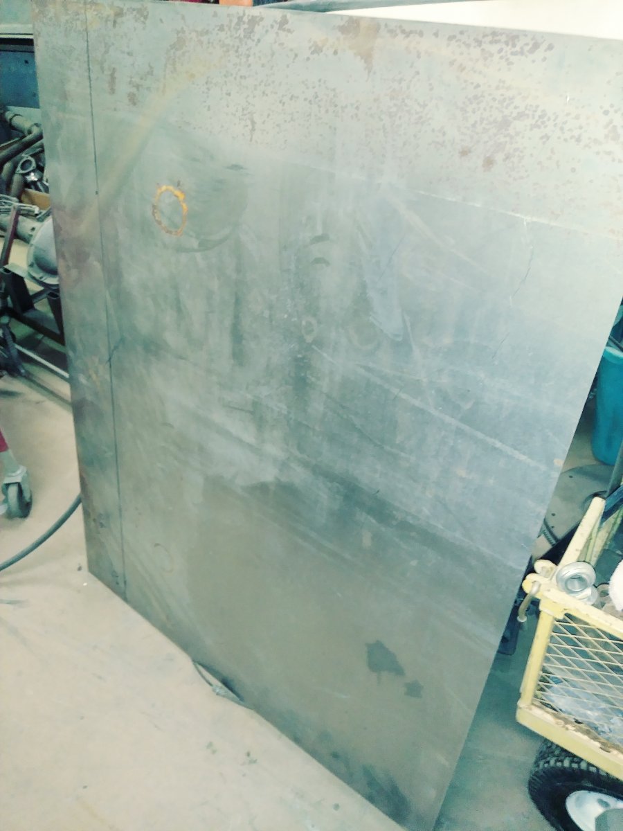

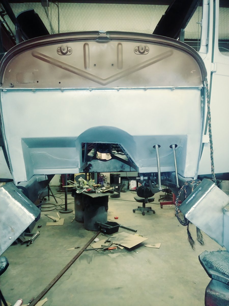

  15. Time for the fire wall
    20181121_130836_Film3.jpg unbolt the top cut the sides levin 3/8" to weld to
    Throw it on the floor and cuse it for cutting you
    Start t******* the edges
    Cut up some cardboard for a pattern
    Make sure it can be put in
    Tape The pattern to make it stiff an make sure it will go in in one pc
    Now it's time for the hard part
    Turning thus pc of 16 ga in to the cardboard templet.

  21. Its bent and put the engineering back in looks like it's right So out with the engine again and finle t******* band welding
    brEad likes this.
  22. Same old story cut weld grind.
    I will us the stock fuel tank I am going to move the sediment/fuel filter to the drivers side since the fuel pump on the yblock is on the drivers side.
    Bolted in the top like ford did it. I left 1/4" of the stock fire wall on the car and welded the new fire wall to it.
    That way it can come out in the future if needed.
    Adding some bracing for strength.
    The comers will be rebuilt with 1x2 tubing.
  23. Structer back in on driver side
    Structure made out of 1x2 tubing
    Same thing on p***anger side some 1x2 x14gtubing.
    Plate over it with 11g
    A little grinding and the front Conner are done. Now to the flaired/curved trans tunnel

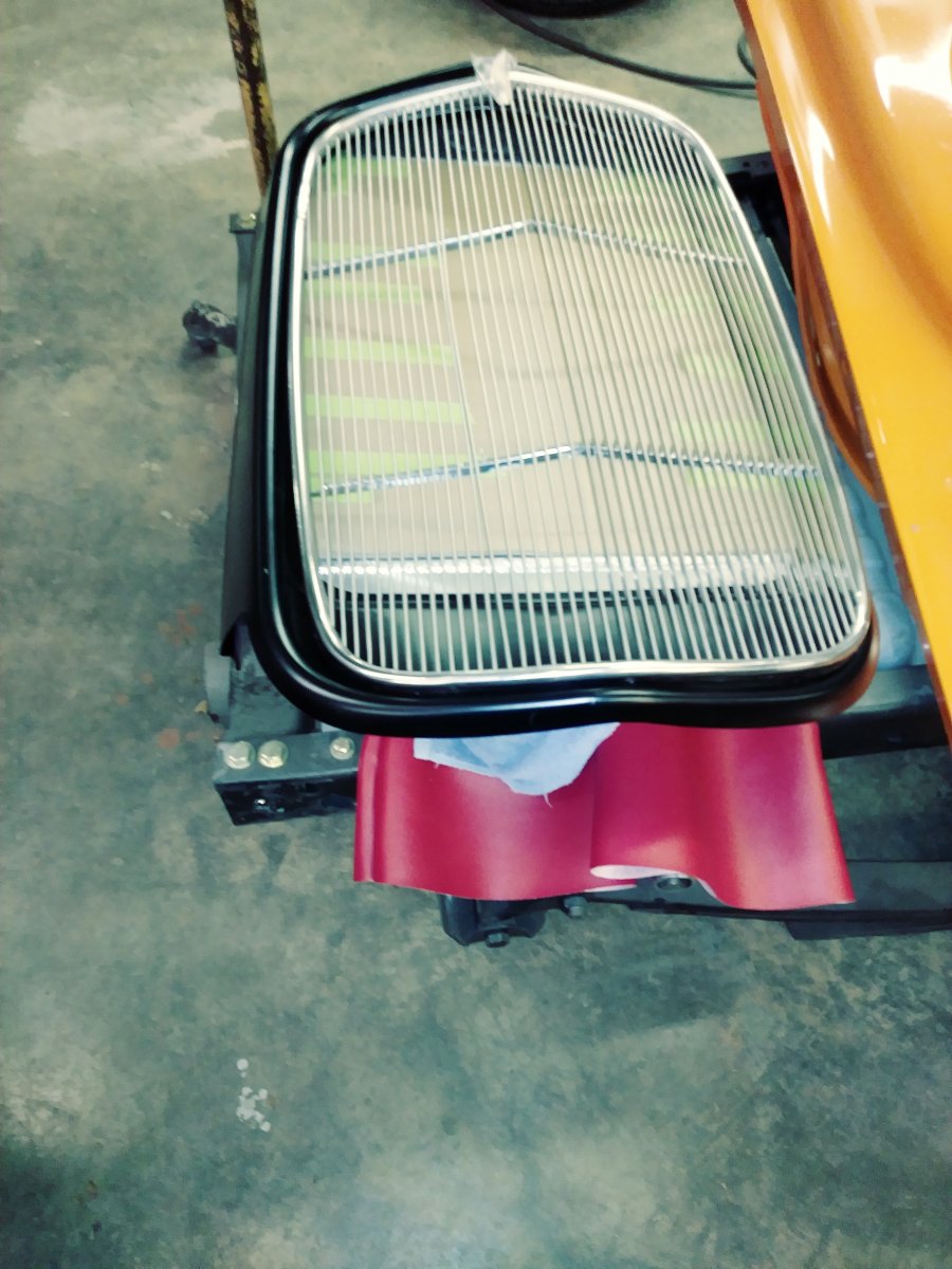

  28. So I get cash for Christmas and decided to spend it on a 32 grill and shell$200 for China grill will work for me.
    It fit the radiator I bought last year.
    Other then shipping damage looks good.
    Now it has to go back and Hopfull FedEx won't let the rain dear play on the next one

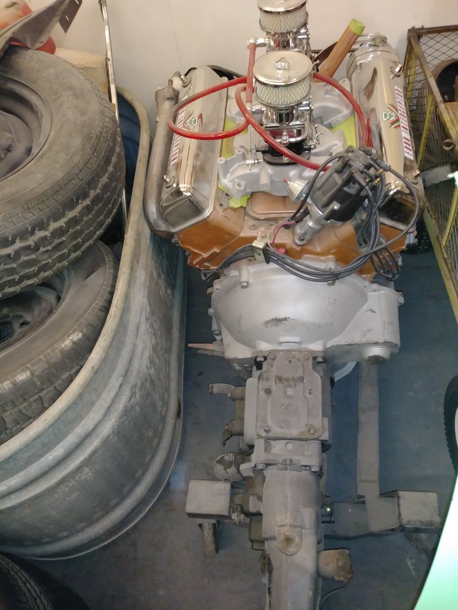

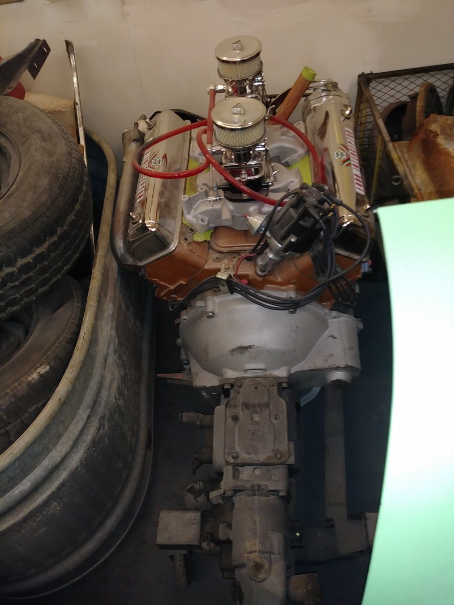

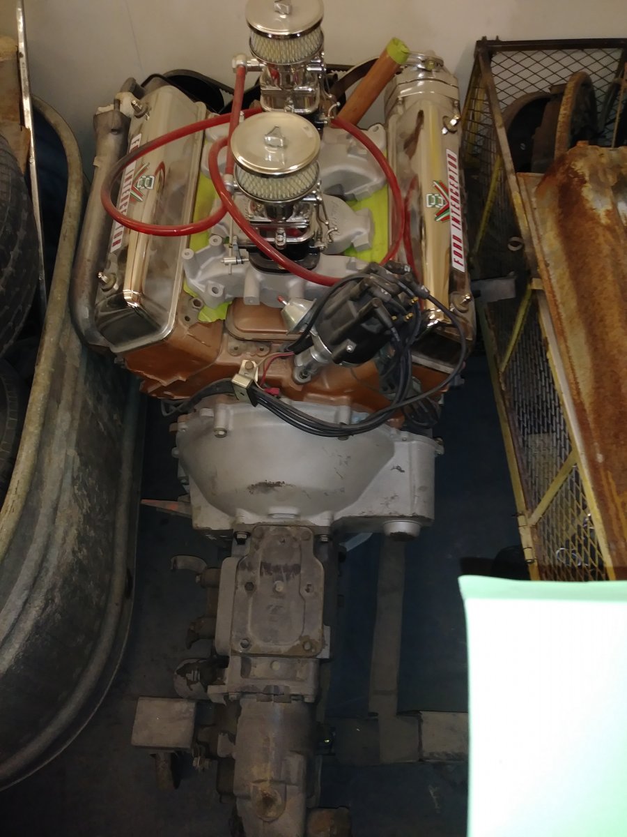

  29. Some people have requested more Piture here they are 20181219_081918_Film3.jpg 20181219_081807_Film3.jpg 20181219_081953_Film3.jpg 20181219_081941_Film3.jpg 20181219_081918_Film3.jpg 20181219_081859_Film3.jpg 20181219_081923_Film3.jpg 20181219_081946_Film3.jpg 20181219_081758_Film3.jpg 20181219_081910_Film3.jpg
