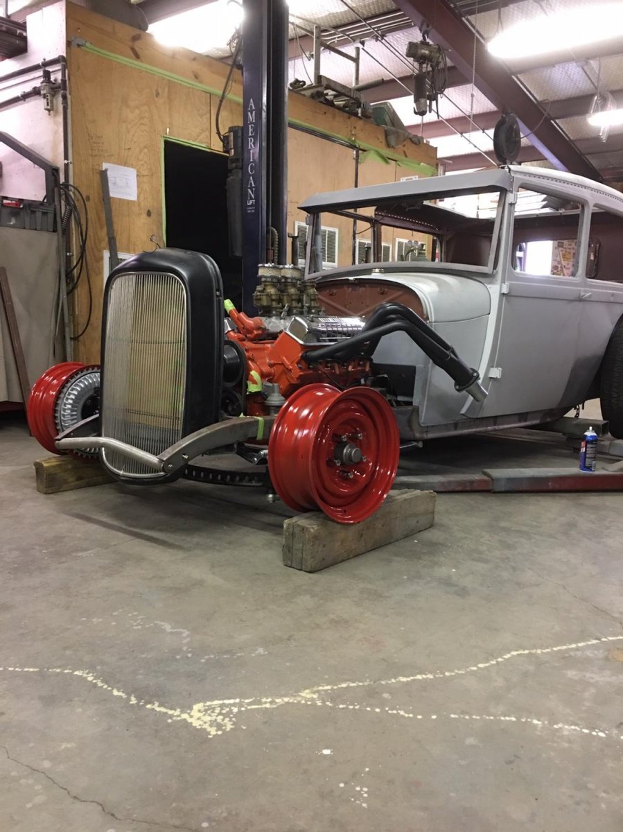

    I could not find the rims I wanted 4.5”x15” 5on5 lug pattern so I took a set of 6” wide and cut them down.
    Changed from bags to coil overs

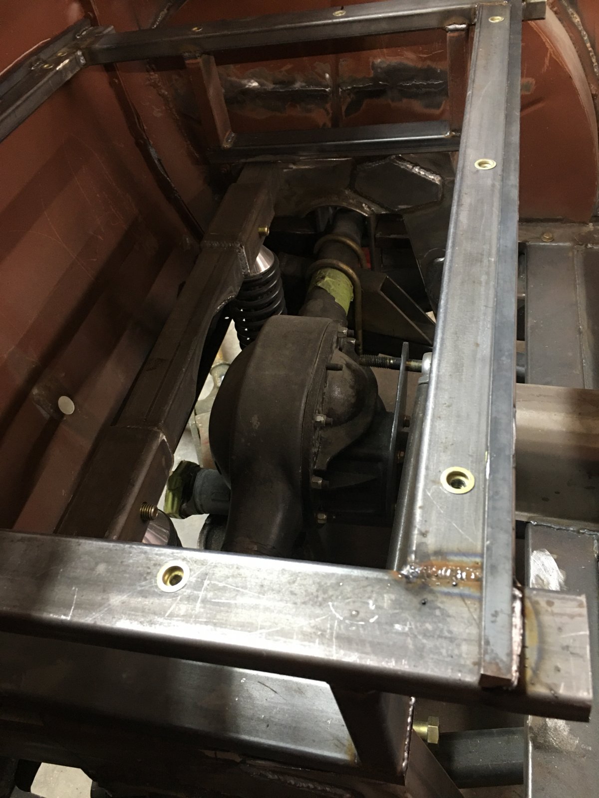

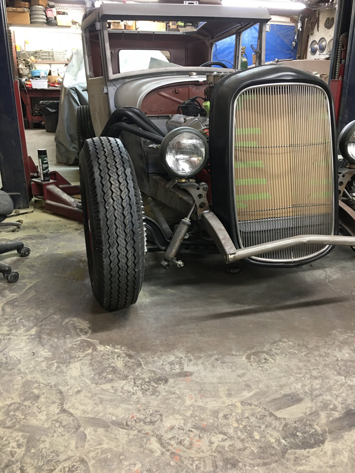

    There were a bunch of changes done away with the 2x4 rails and use 32 rails instead
    [​IMG][​IMG]
    It was a lot more work but it look better setting over the 32 rails 4”
    I’m wind up with 5.5” ground clearance
    Here it’s at ride heights but the tire are 3” off the ground
    Coil over bracket are mounted a little different but it fits
    I will have 3 master cylinder 2 for brakes 1 for the clutch
    Not my favorite location but you have to have a battery only have a 1” bump to make it work

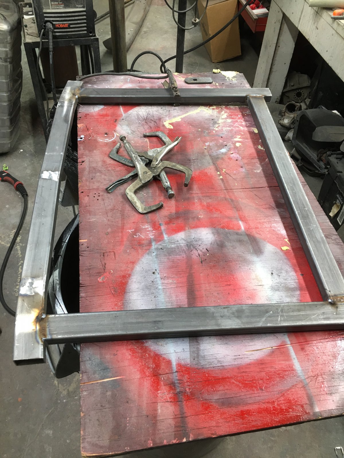

    Everything I am doing is to keep ever inch of interior room I’m 6’1” and 359# so room is nessary [​IMG]
    Bottom Veiw of battery box

  8. i had some fender well exit headers made for a pickup .see in my avatar. and they look good stuck out a little farther then I liked. and lets admit it not very practical.
    so figured I would just run the cast iron one that worked till i mounted the gear box .
    so now its either:
    custom build headers very time consuming
    a set of lake pipes. easy to build and $169
    or a set of cast iron ram manifolds $390
    looking like a set of lake pipes. seen on ebay set of lake pips for sbc are only $100 wonder if i could cut the flange off and make them work on a yblock?

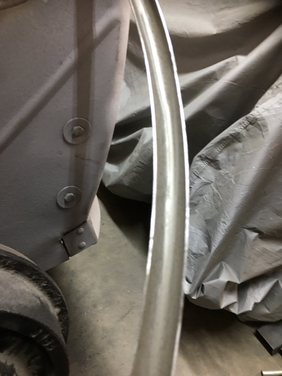

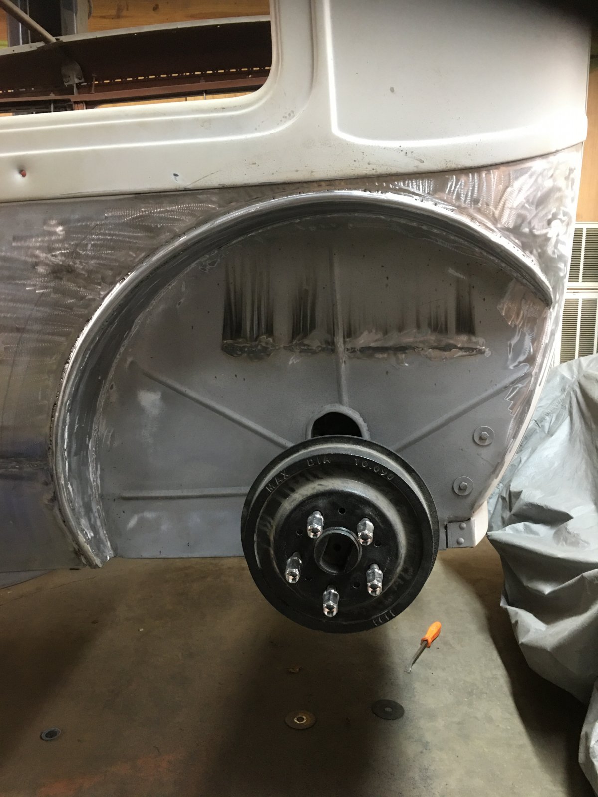

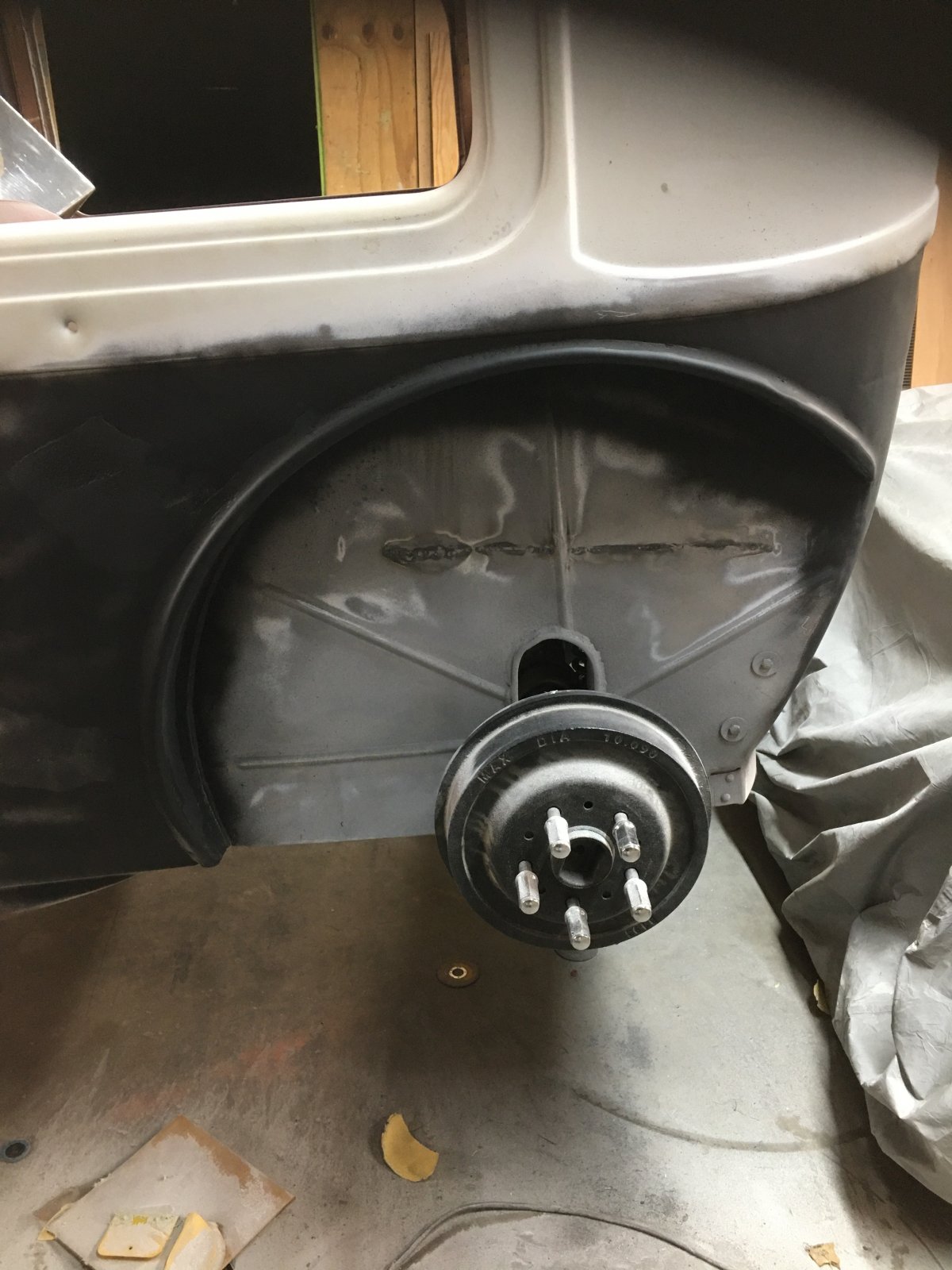

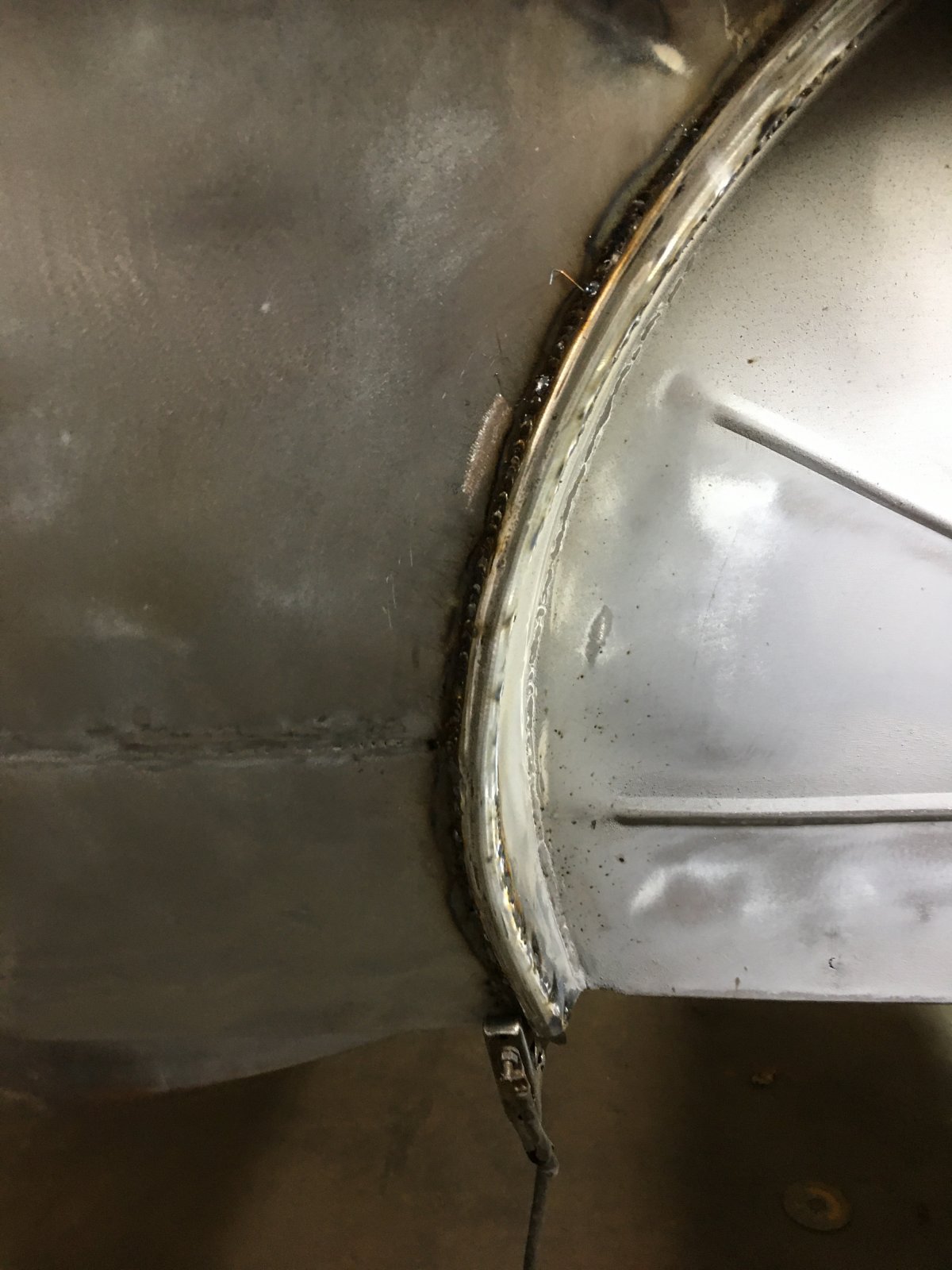

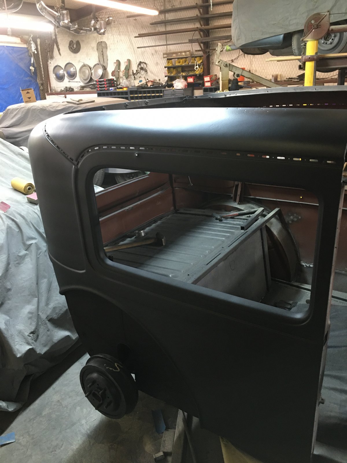

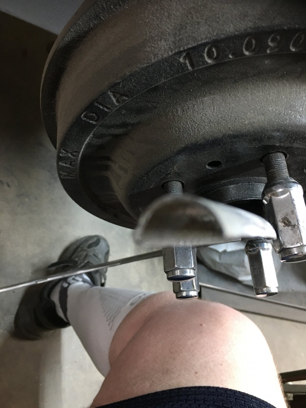

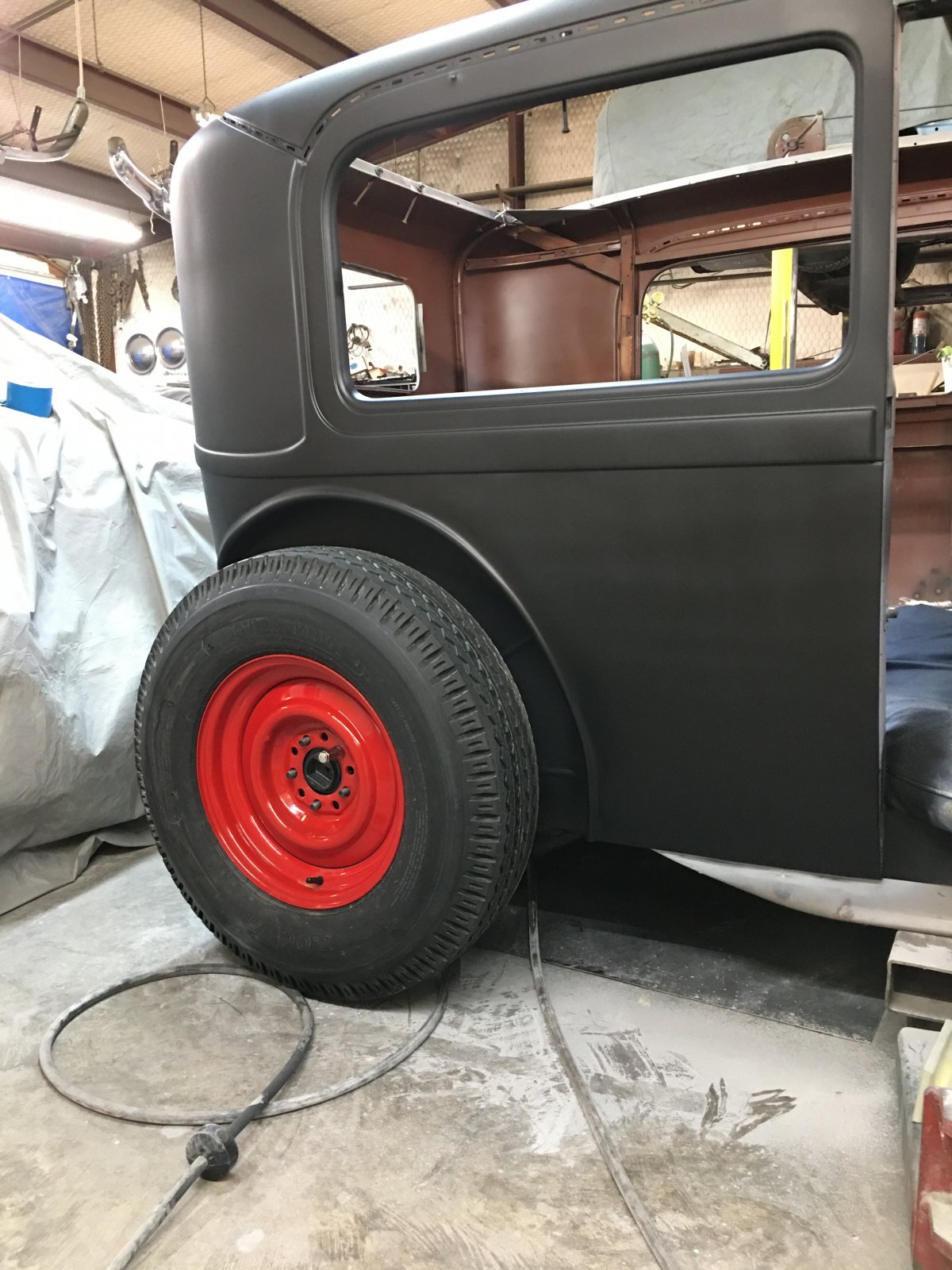

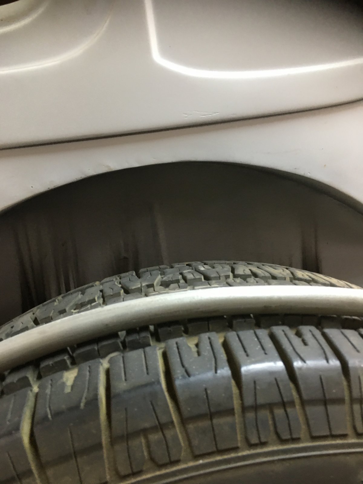

  10. I did not like the sharp edge on the wheel well so bent some tubing and split it in half to make a bead . Took several hr to weld each side but it dressed it up .

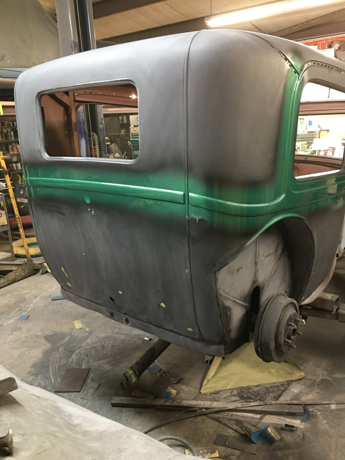

    Along with the ready of the theam of using left overs it looks like the car will be yellow and the bead work green. Not sure I will like it but the paint is a very good quality and best of all it’s free F8A10086-3E01-471A-8CD6-BEB9D7701D21.jpeg F8A10086-3E01-471A-8CD6-BEB9D7701D21.jpeg 0605CE87-A310-46DF-BBB0-A96B62F7FFFB.jpeg 51DF0DE1-06FC-4EBB-A438-3E2C7FD54AD0.jpeg DCDE4BB6-CFE3-4743-B903-B7885FE3042D.jpeg B6B7BA79-6311-4796-9225-CA85AACF3BAC.jpeg A387709C-81E7-41E7-BD1E-9BA1765695F3.jpeg 896B62E9-59FA-4D1B-9DBA-C8CC112D4351.jpeg 29CBAB90-7610-4D46-BFE7-27EC5BABEDE2.jpeg 94FFFCAB-55FE-45A5-AC2A-8A3EDAE84267.jpeg 045F4EC9-8E73-4D71-B871-FA76FA9398B3.jpeg ACD7D9ED-F21D-405B-A8AA-6C6DFBF5B27C.jpeg 0AF6A71D-4BC3-4449-870A-3C3F51B8339B.jpeg
    I always start with dynagl*** or something similar over all welds it does not absorb moisture like bondo does
    9CDFE164-697B-44E2-BE3D-9A3C4445D8CE.jpeg 4937E58F-45D6-43D7-B152-2614D339AADE.jpeg FE704856-49B3-4721-956C-4306063B88CA.jpeg E1C7D14C-8210-4559-8EB2-6F6BF96FF890.jpeg 99EC6D75-7761-44FD-A6B6-E86643AFDEDD.jpeg 3C798A16-54F8-443A-B8B1-E4526305B5CB.jpeg 76470924-472F-4DF2-91C0-655663280699.jpeg E99BFC74-DBE6-4D36-AFFA-935B944ABC00.jpeg EF4CC1DC-264C-43E8-A5DE-A041C6C5ABB6.jpeg 36E4308E-9653-46EC-B67C-AC7C27AEBE46.jpeg 0761413F-FD7D-4B6F-AACD-267A755DB9F0.jpeg DCFB6105-0E67-42AD-874C-2B345EA52FCB.jpeg
    the green is 3 qt I had left from my 59 ford
    D1933811-4BDC-4190-B9DB-6C6DA21DE76D.jpeg 3FE25B6A-EA59-475A-9709-78F59AD7981C.jpeg
    I have 2 gallons of this fulcryl 2 paint so may as well use it
  11. well, this is a large test panel lol.
    not sure about the yellow possibly if the window area was all green it would be better.
    it defiantly would stand out. and the paint is freelol 275554320_1193541294515046_2849451740714644604_n.jpg 275554320_1193541294515046_2849451740714644604_n.jpg 275513779_1192243144644861_1972501453308553288_n(2).jpg 275497973_1192243124644863_2227702990054159003_n.jpg 275497973_1192243124644863_2227702990054159003_n.jpg
