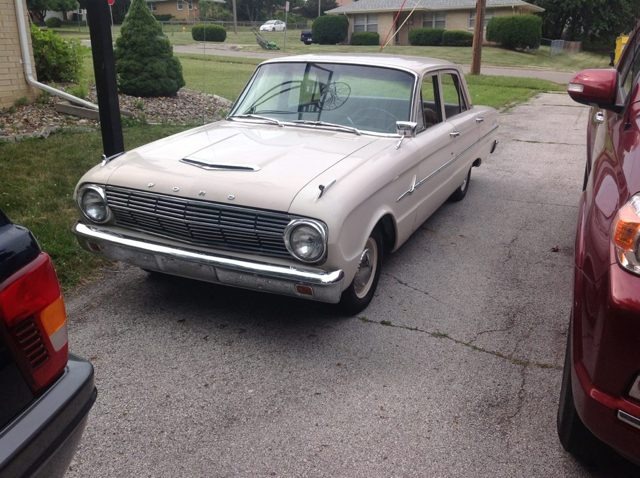

    Well it's sitting in my driveway now so I'd better get ready lol. Looks like Macs has a good line of replacement parts when I need them. I saw they have an electronic ignition to replace the points. Is there any reason I shouldn't do that to replace the venerable points that you all have been mentioning?
    I drove it yesterday and it rides super smooth so I think the suspension should be good for a while with just some grease from time to time. It shifted good not too strong but still able to notice the shifts just right. The carb needles choked longer than normal (even after its warm) the guy said he rebuilt it so maybe it needs to be re-rebuilt he said the float sticks too so I kind of figured I would need to do this maybe I just try to find a replacement instead of messing with it. The doors and windows all work easily (rear windows are a little tight probably from not being used. Nothing a little use and oil couldn't fix. The doors and panels are all aligned well the only exception being the front p***. Fender which looks like it was off at one point and there is a small slice because of it. I'll get pics. There is also a little paint bubbling at the rear quarters behind the wheels but its not through yet so shouldn't be hard to fix.
    Also I realized it has front seatbelts but none in the back so I ordered a couple. Ill get pictures in a bit the neighbor is mowing so ill wait till he's done. Aww screw that pics in a few I'm headed out there now.

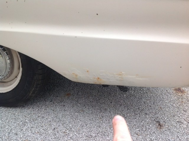

    Quarters behind the rear wheels
    Drivers side the color doesn't show it well it's about the size of a football but not too bad really

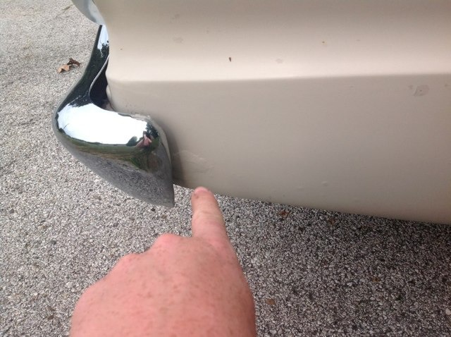

    P***enger side is pretty small

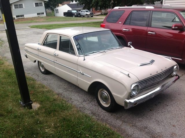

    Paint has a few pretty deep scratches and some flaking paint but really it's not to bad for 50 years old. Maybe it has been painted who knows.

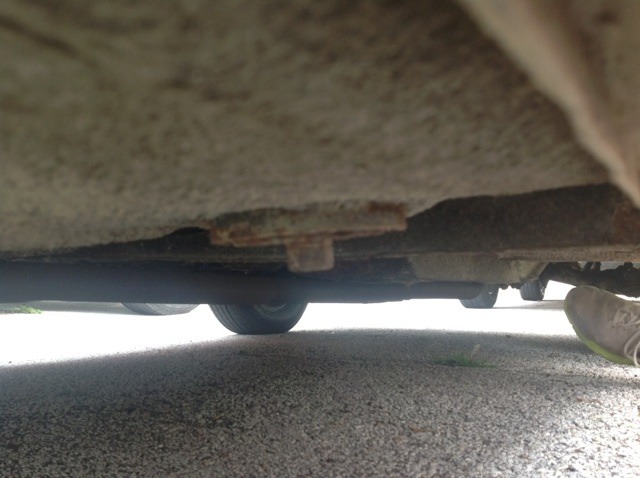

    Under side shots can't see much but the undercoating is mostly all there.

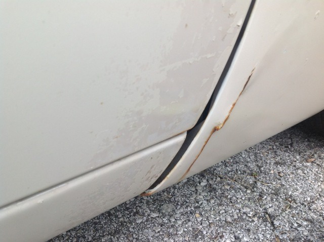

    Here is that slice in the fender

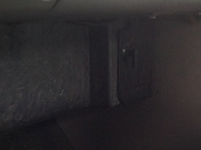

    Lastly what is this door?
    It looks like the a very opening that are typically found in muscle car kick panels. Or maybe it's just an access for cleaning anybody else know? There is one on each side.
    And the p***enger side still shut

    Check the wipers on that, they may be the va***n-operated ones. If you encounter a hill with them on, they will go slow and maybe even stop, until you create more va***n by cresting the hill. Usually, the steeper and longer the hill, the harder the rain.
    Those little doors on each side in front are your vents (a.k.a.: crotch coolers). No fancy ****ons or sliders on the economy cars, just reach down and open the little door until you feel the desired breeze on your lower extremeties. If the bottom of the duct is flat and there is no danger of something falling down out of reach, they make a great place to stash wallets, watch, keys, etc. when you don't want to carry them but don't want to put them in the usual spots, like the glove box (my first car, a '72 dodge Dart, had similar.) Oh, and watch opening them after fall/winter- they tend to keep all of the sand, dust, dry leaves, etc. there until you get hot and unsuspectingly open the door. Multiple experiences on that one.

    That little door, and the other, is a fresh air vent.
  28. Those kick panel doors are air vents, right?
