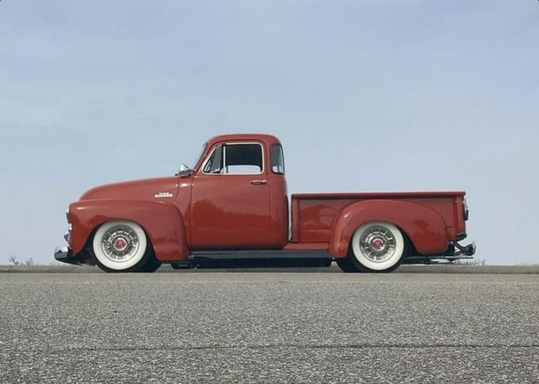

    I had a local artist draw this up for inspiration and plan to go for a late '50s, early '60s vibe with a Tiki motif. Since this was drawn we have decided to do some light dechroming for a more mild custom feel and to go with a '51 Chevy Truck Burgundy color which should look sweet.

    A few inspiration pics.
