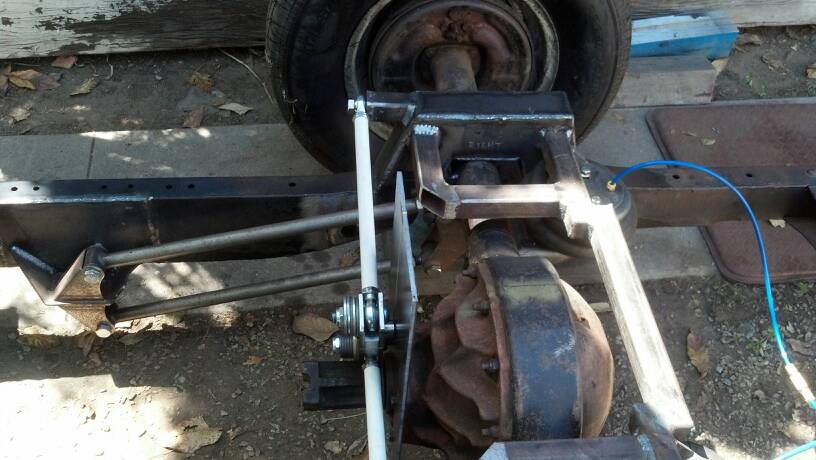

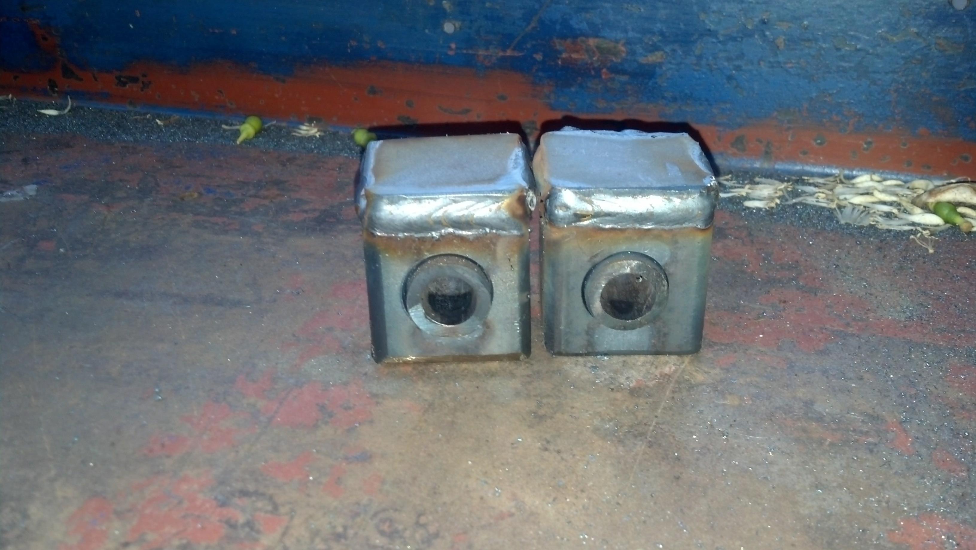

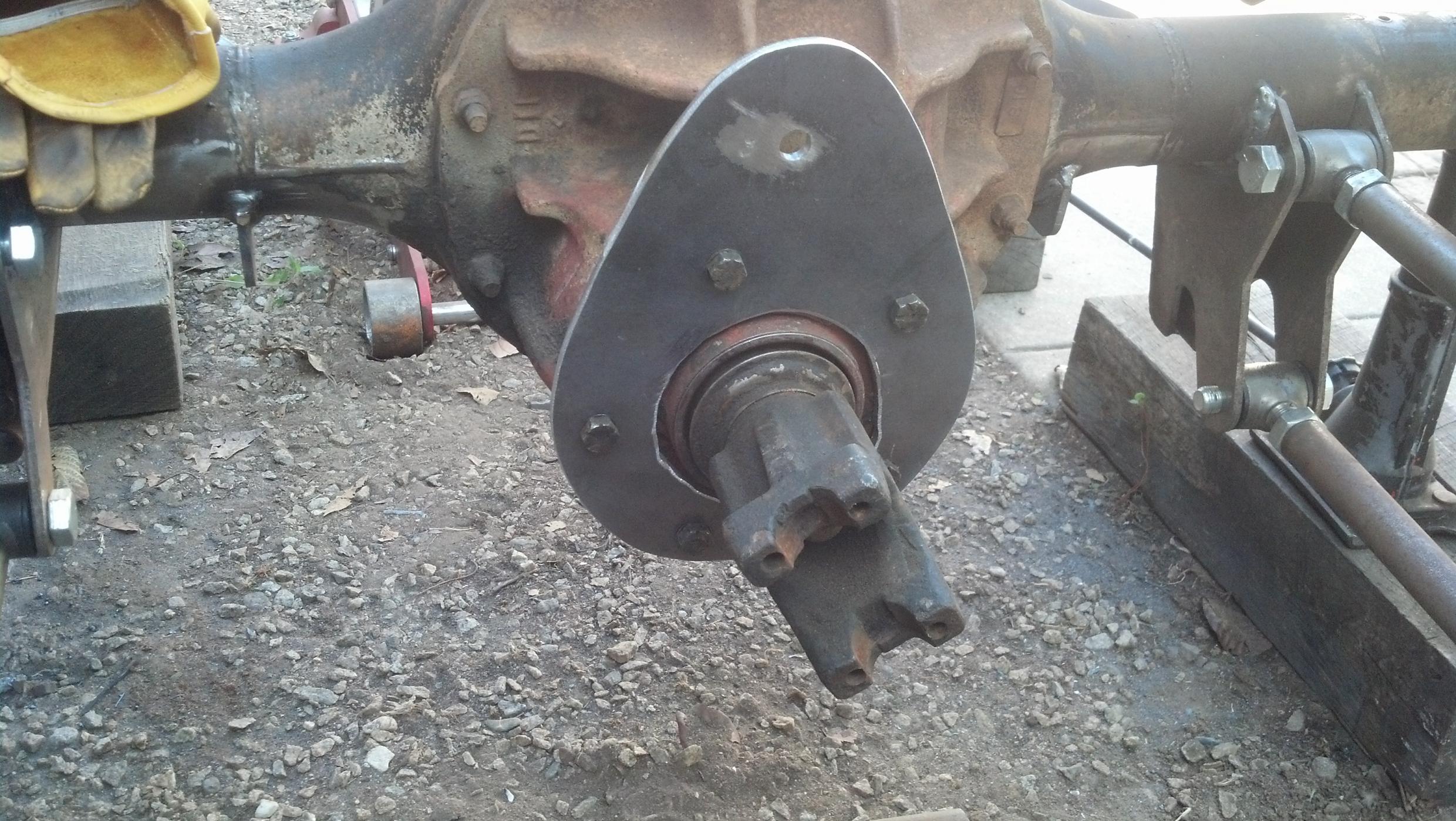

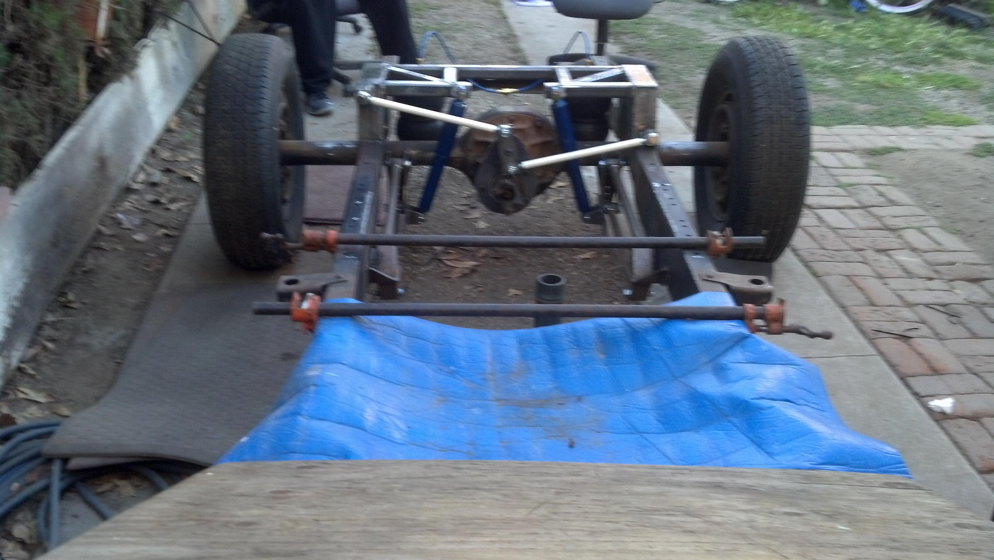

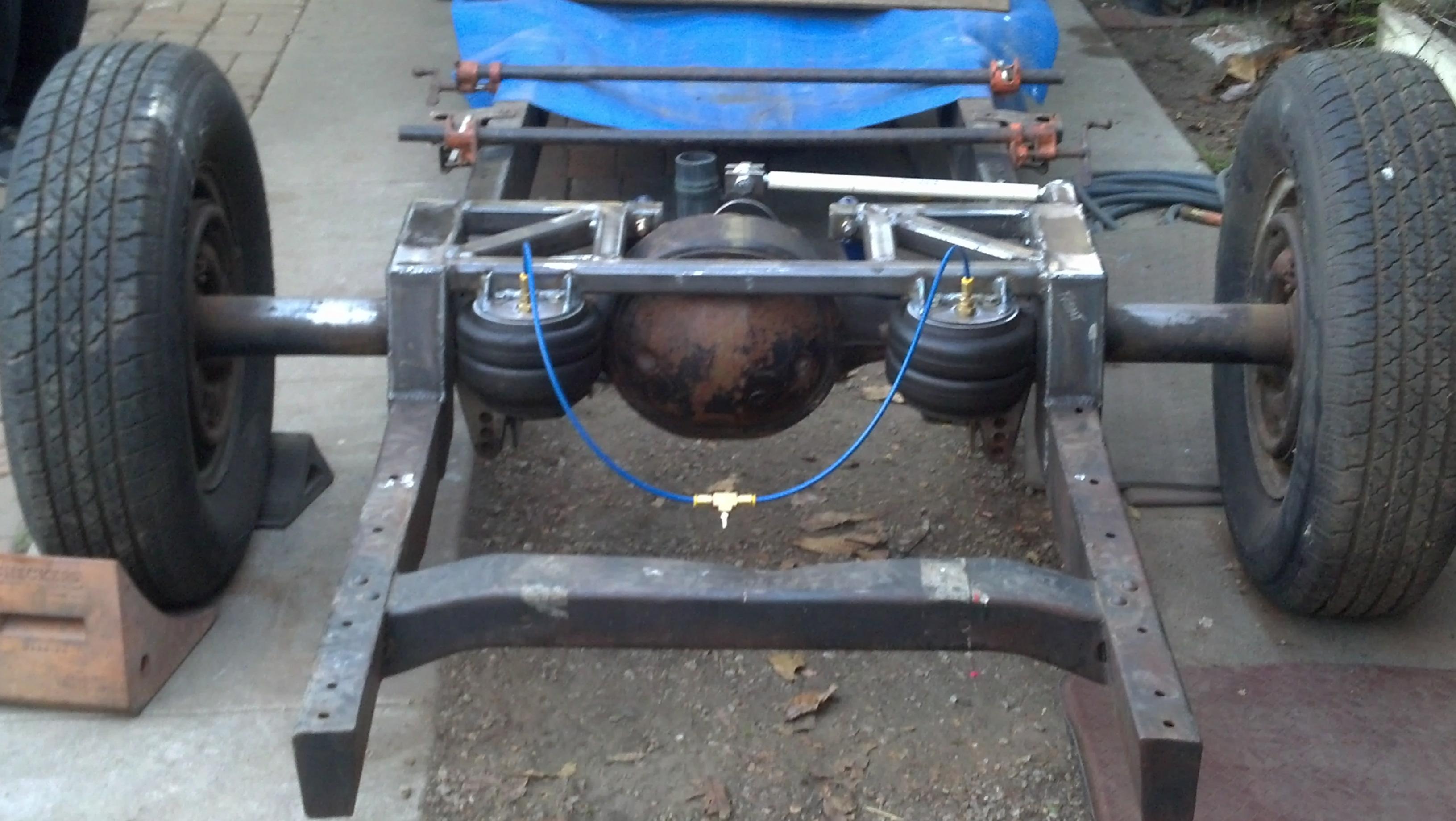

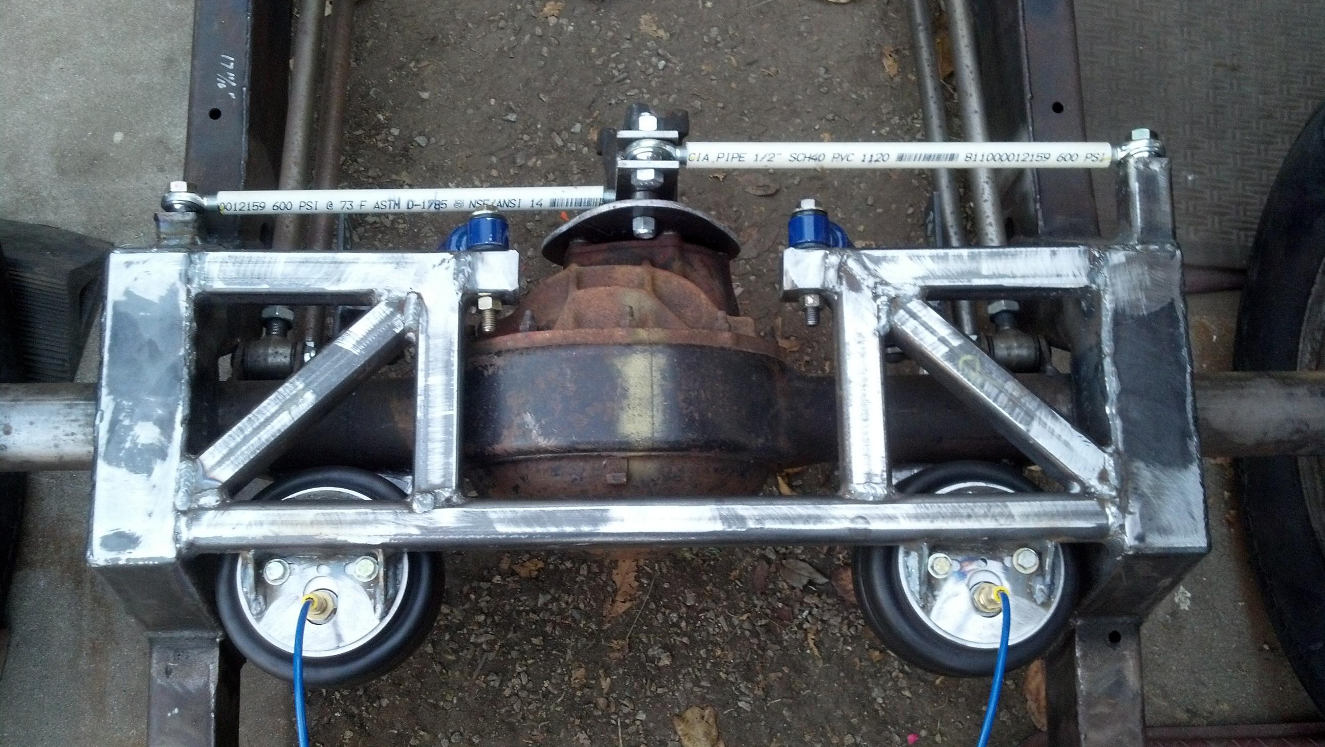

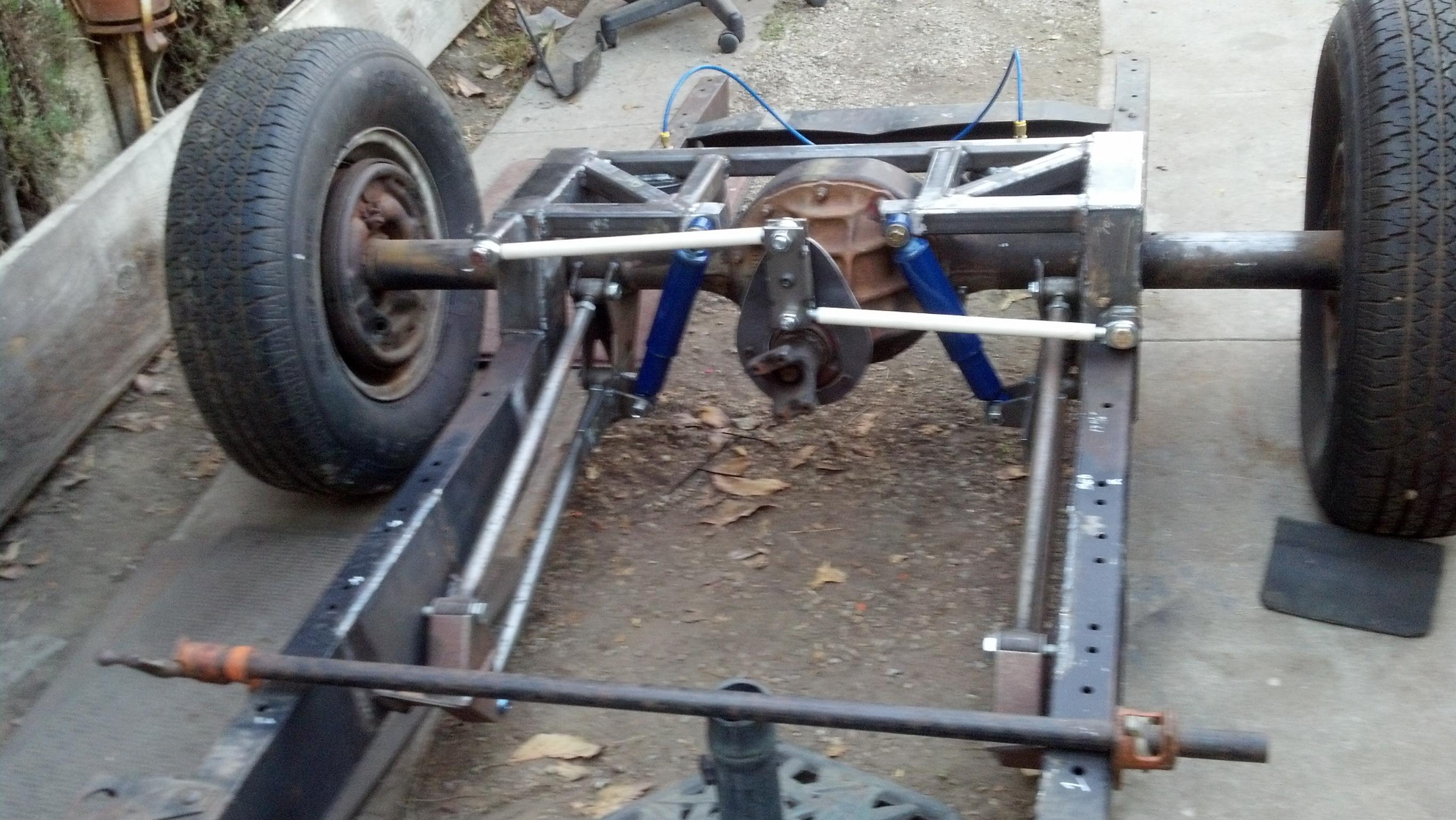

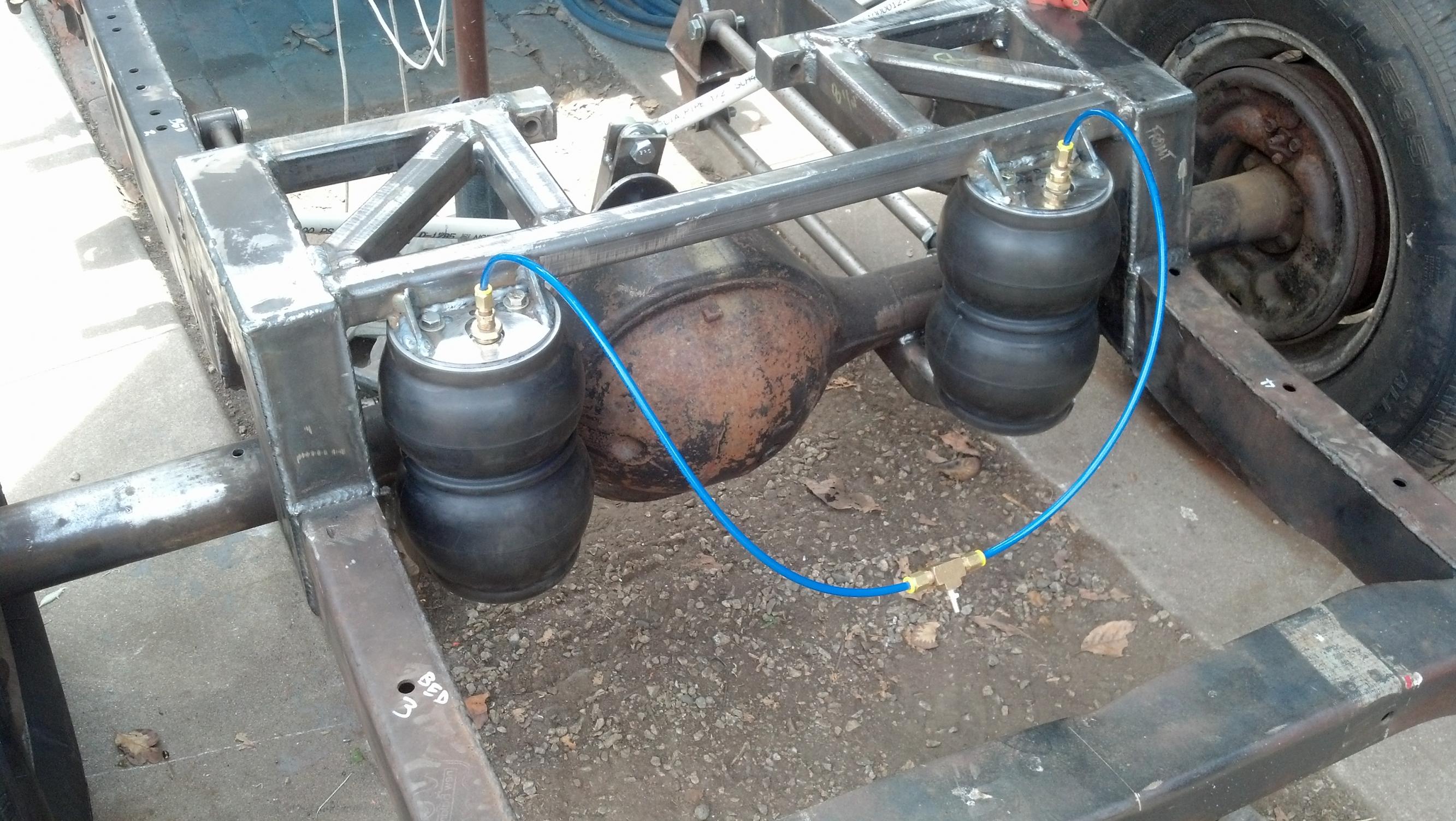

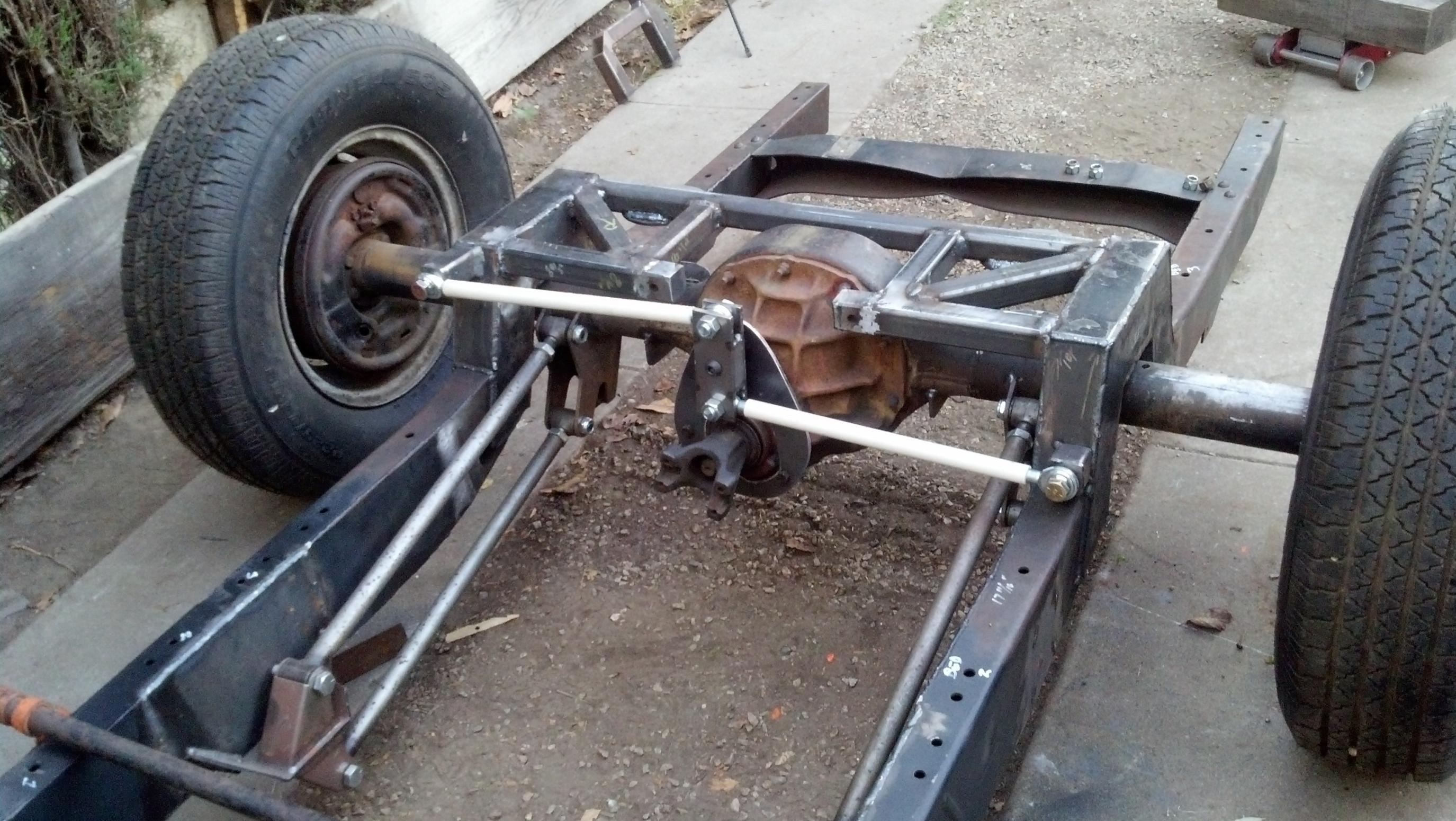

  1. So I finally found something that will work with keeping the diff center. Its a pinion mounted watts link.
  2. I made the links out of PVC pipe for the mock up and I also have to trim the plate but it's coming along.

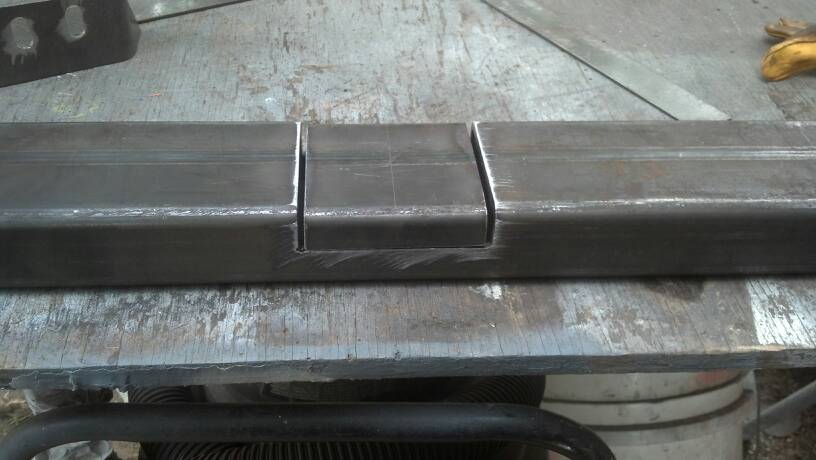

  3. So I had to redo the top structure of the notch. I made a rookie mistake and set up the upper bag mount incorectly. However; it worked out better and I figured out a place to mount my shocks. It's pretty tight back there, but it all functions and keeps the outside of the rails free to route my exhaust through. There's a few things left to tidy up but it's just about done.

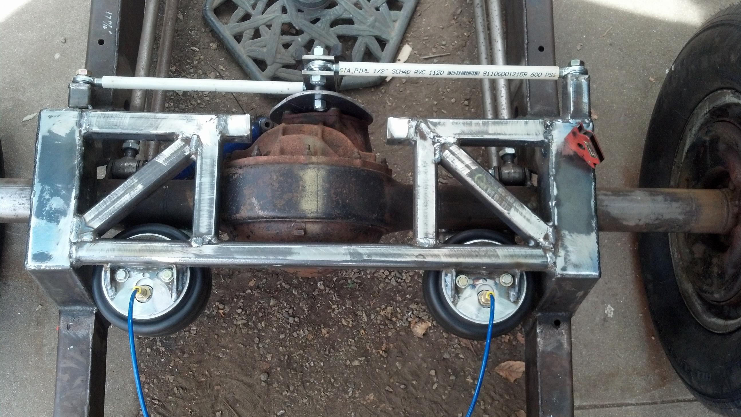

  6. I made and welded gussets on the top bag plates. I also upgraded to slam specialties RE-7 bags.

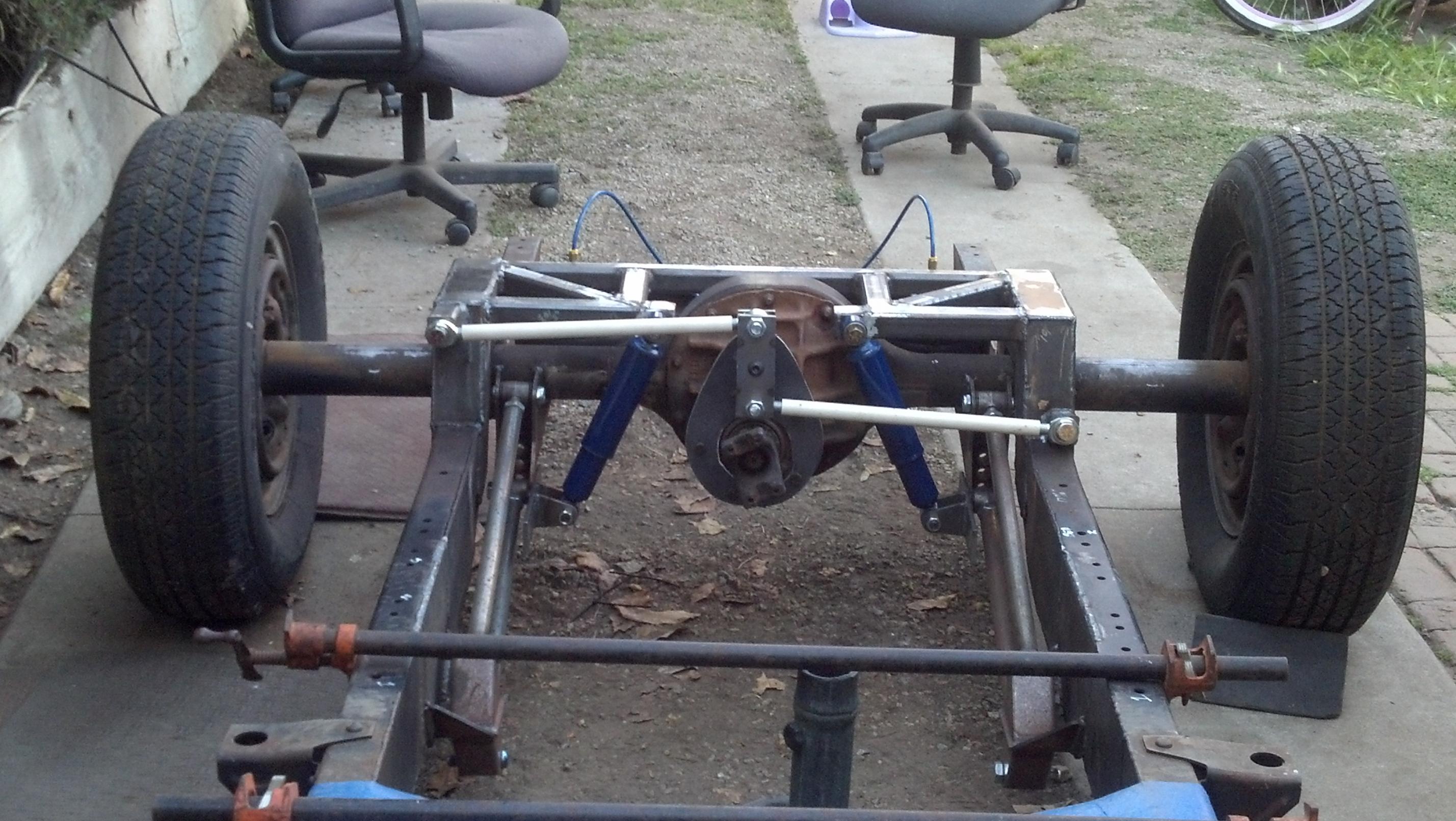

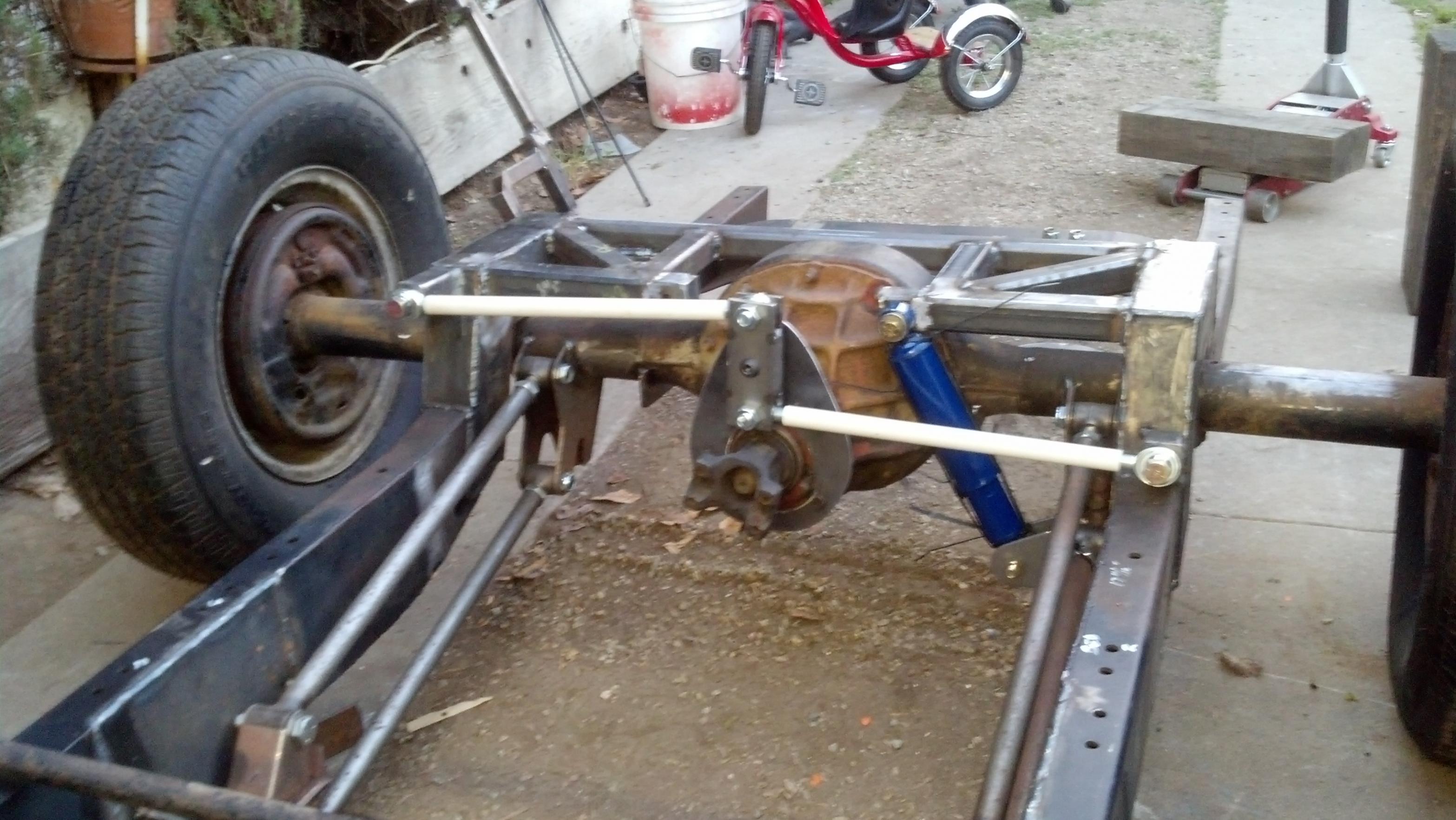

  7. Except for a few little details like rounding off the edges on the watts link bell crank, tapping the links and trimming off the excess on the lower shock mounts, I can just about say the rear suspension is done! Took a lot longer than we expected but we're really pleased with the results:cool:

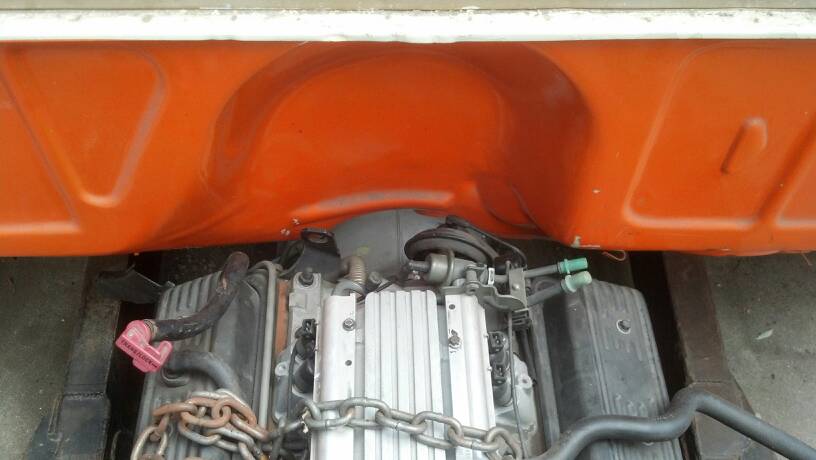

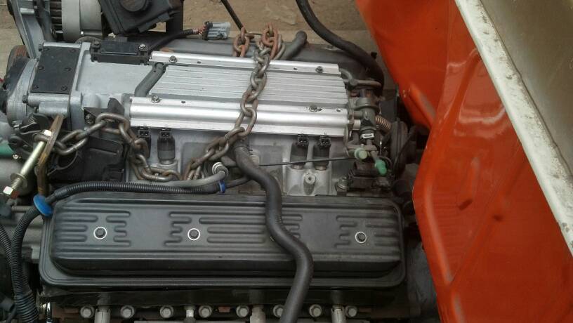

  17. Had my car club brothers come down and give us a hand in mounting the cab. Plenty of space for the motor and tranny. I won't have to modify anything on that end. I must say, it's a big motivator to see the cab and bed on there and watch the suspension go through it's range of motion.

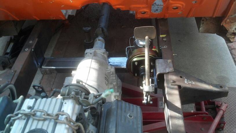

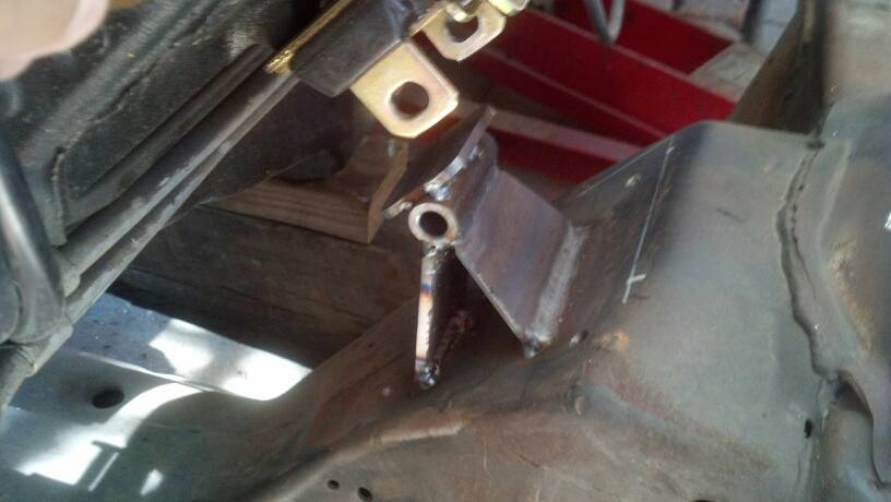

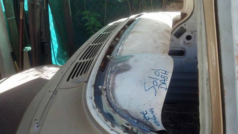

  21. Small update. I ended up tackling the top of the dash and also the support part of motor mounts. Next on my list is to dial in the power brake booster and weld that bracket in place.

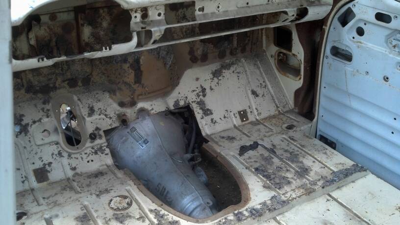

  22. We worked on the trans cross member these past few days and had to notch the center to clear the speedo and the left side to clear the power brake booster. Everything fits great so I'm going to weld her up tomorrow. After that, I'm going to work on the front horns and set up the core support as well.

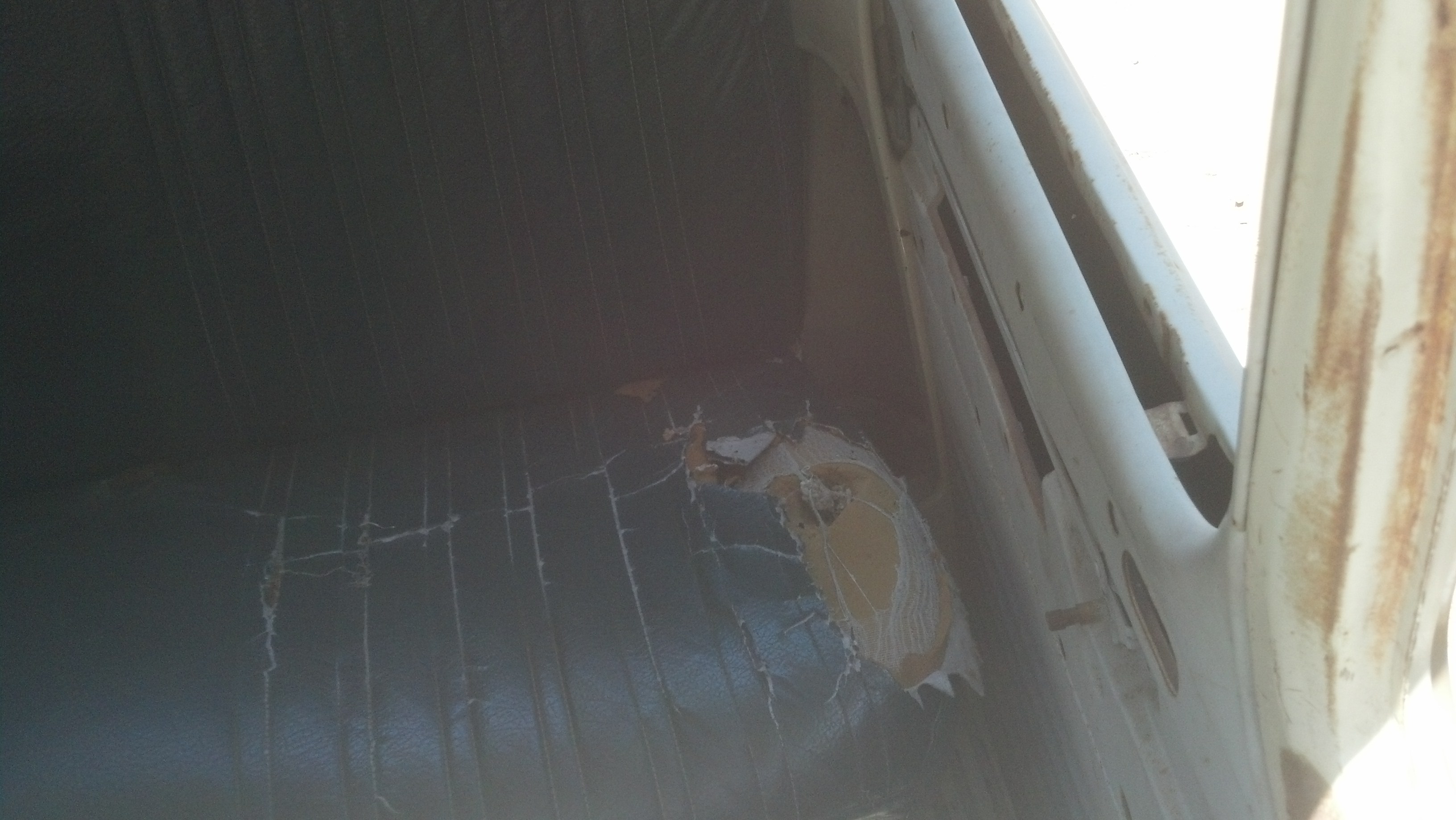

    Got this seat at the boneyard off a '88 Chevy single cab truck for $50. It's as if it was made for my truck, the mounts fit between the ribs and its an inch wider than stock which I like.

    I welded up the seams, grinded them flat, did a little body work, straightened out some bent panels, and did some patch work. I have to replace the rear cross sill and install the floor and then it's off to the sandblaster.
