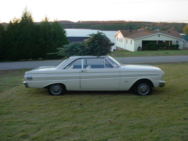

    My Daughter and son-in law have a 65 falcon w/t a 260 V8 and has driven it every day for the past 2 years.
    he has never had a generator problem,,,,,if they do i have a couple of extras,,,,,my daughter does not want her daddy hot rodding her falcon. [​IMG]HRP
