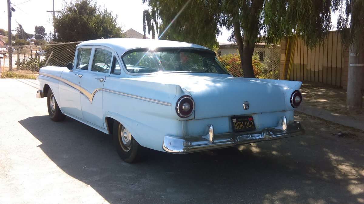

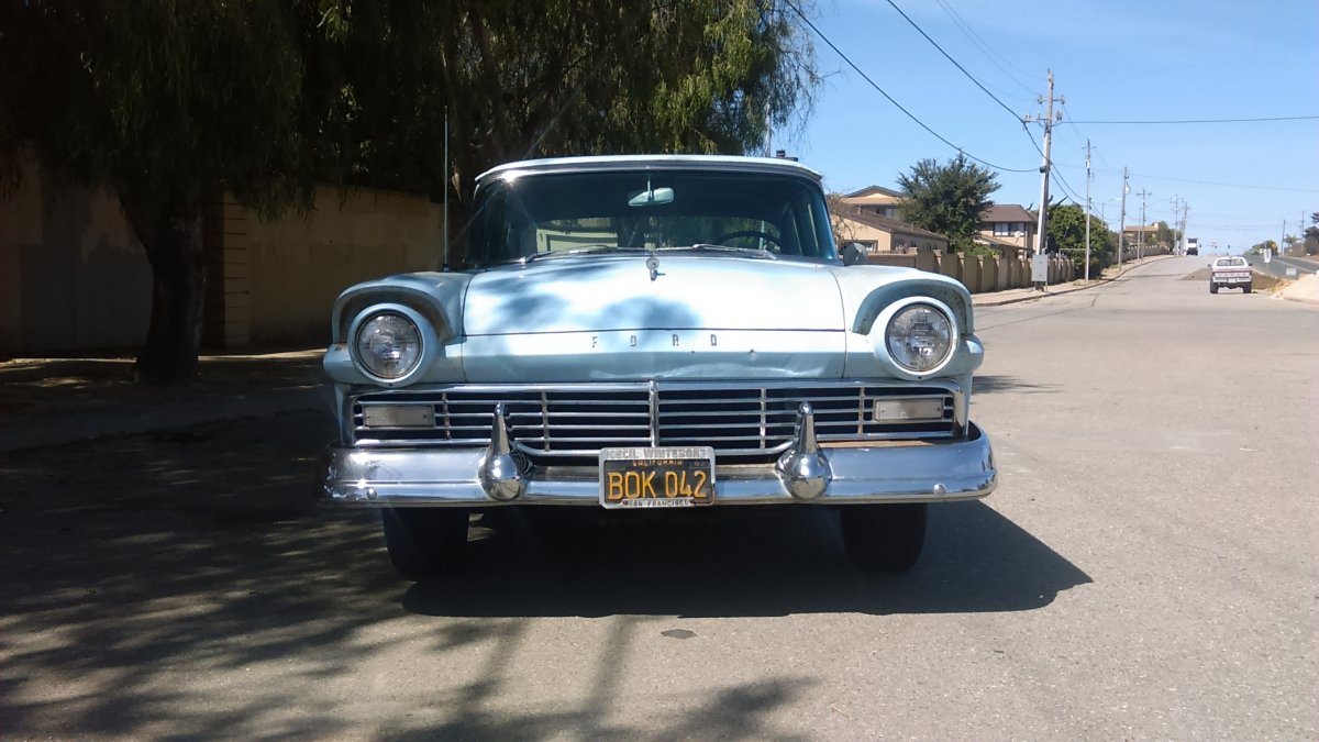

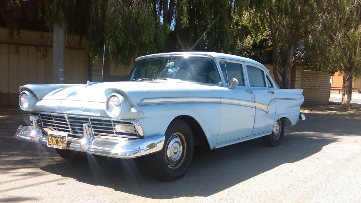

    I did take a few pictures today. But of course, I forgot to shoot the under carriage and engine bay. I'll upload a lot more thorogh pictures tomorrow. But just incase if anyone was interested:

  29. Save yourself a lot of grief... sell me your car... Looks like a nice ride.

    Lol! Your first comment reminded me of how many random offers I've gotten for the car. Most offers were from drivers driving in the opposite direction and yelling out the window lol. I'm sure you're all use to this.
