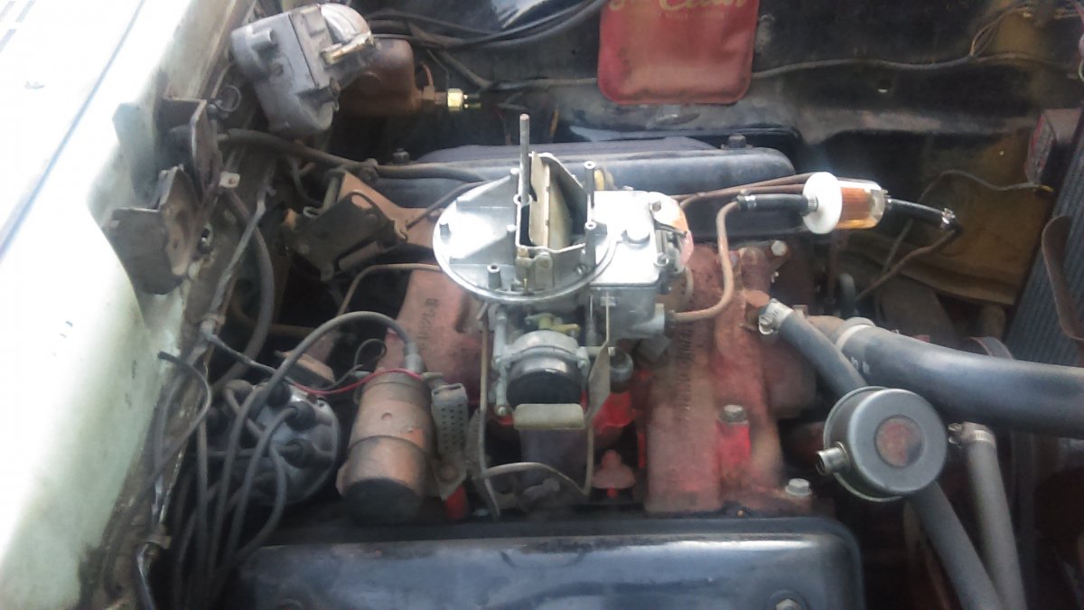

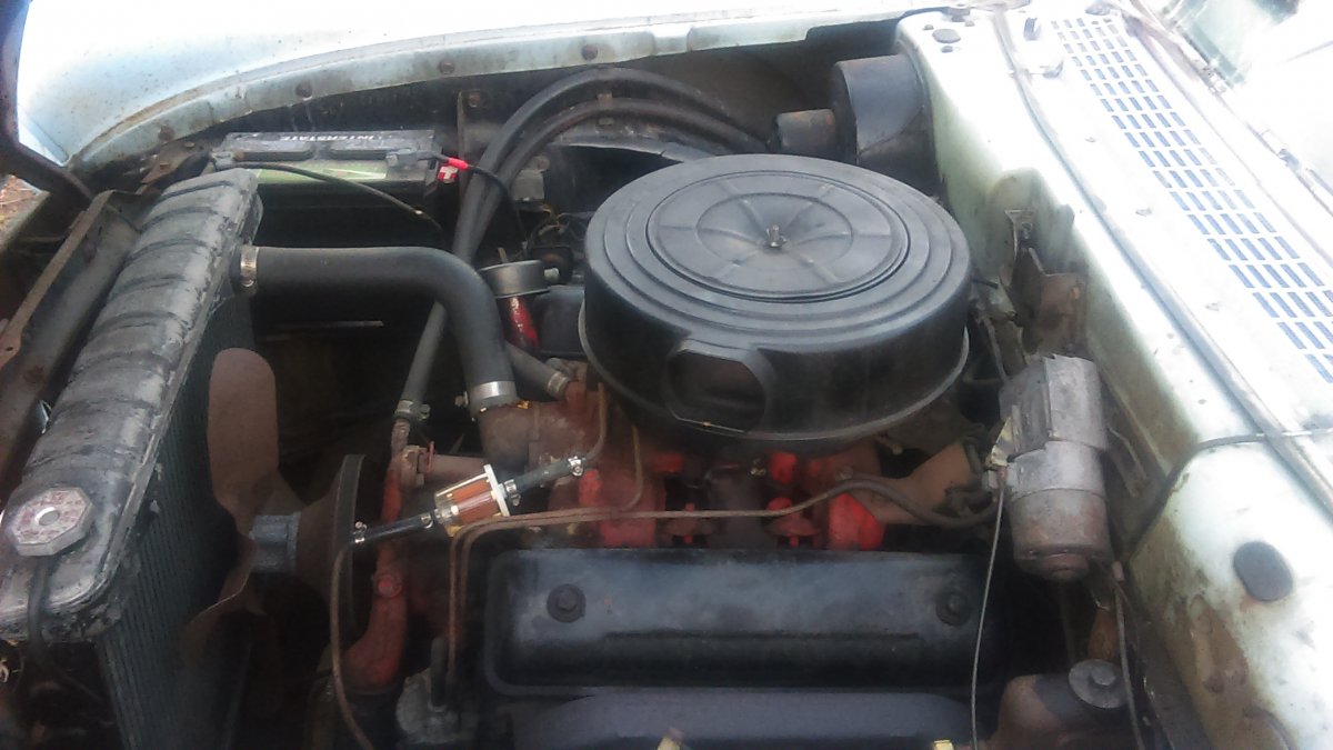

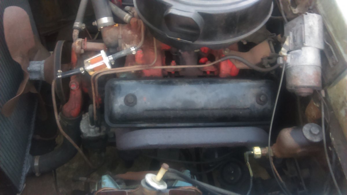

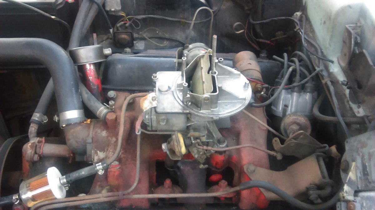

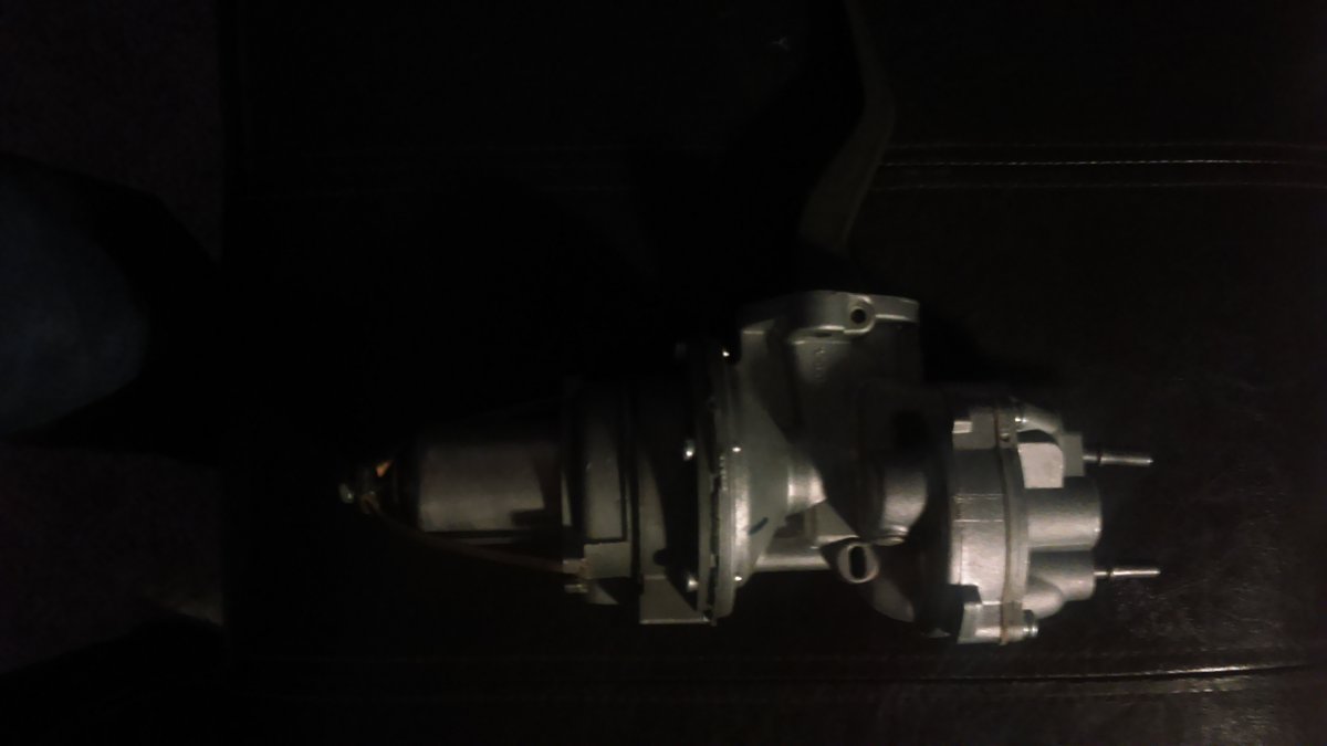

    Here are a few pictures of the engine, the carb and my new fuel pump that I'm going to attempt to fix:

    heh...double fuel pump, and electric wipers....something doesn't add up :)
    (the top half of the fuel pump is a vacuum pump, to help power the vacuum wipers when going up hills. Not needed with an electric wiper motor)
    BobbyRay likes this.
  15. Mike Miller
    Joined: Oct 13, 2008
    Posts: 4,556
    Mike Miller
    Nice car. Electric wipers and the dual exhaust manifolds are a big plus, If it does not already have it I would convert the crank case ventilation system from the road draft tube to a positive crankcase valve (PCV) system. When it comes time for a new fuel pump get the one with out the vacuum pump, save some money.

    Thanks :) What is the benifit of converting to a pcv?
  17. 57JoeFoMoPar
    Joined: Sep 14, 2004
    Posts: 6,493
    57JoeFoMoPar
    Bingo. Makes me think that someone converted it to electric wipers and left the fuel pump. He could probably sell that double action fuel pump for twice what a standard fuel pump will cost.

    Keeps the engine crankcase cleaner, and also doesn't put out that puff of blue smoke from the engine when you're sitting at a stoplight

    So I'm probably better off just selling the fuel pump I haven't put in rather than replacing current one?

    The PCV draws fresh air in to the crankcase and routs the fumes to the intake manifold for the engine to burn. It helps keep sludge from forming in your engine. And as Squirrel said you don't have that crummy smelling haze of fumes around you at stops with the engine idling. It will also create a low pressure in your crankcase which helps with oil leaks. one of the things I did with my 57 Cad. was to remove the road draft tube and install a PCV system. Your electric wiper motor looks a lot like the one on my 59 Ford.

  21. 57JoeFoMoPar
    Posts: 6,493
    57JoeFoMoPar
    If you already bought a new dual action fuel pump, I'd definitely return it and buy a regular, single action pump instead. You're literally not using the second half of the pump at all.
