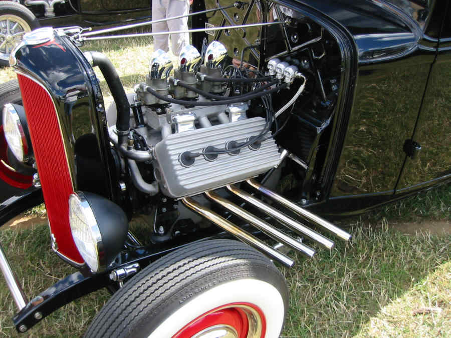

    Here's one in a 32, looks kind of small
  11. maybe look better in a model t then?
  12. It looks like a V8-60 sized motor, guess that is why they were used in Midgets and small vintage race cars.
    CBB
  13. man that thing is tiny, but very cool. would be sweeet in a "t" {touring would be tuff!}
