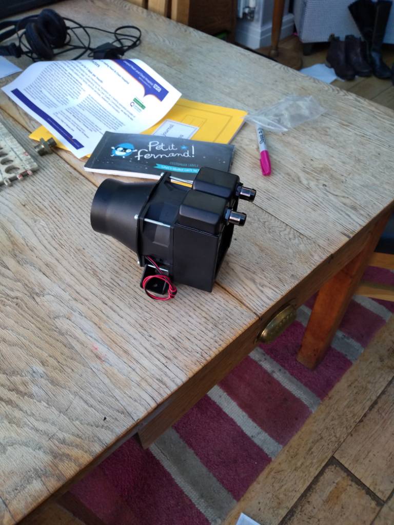

  1. Here's the T7 heater with the hosetails swapped to the rear and the bracket at the bottom IMG_20181130_092405605.jpeg

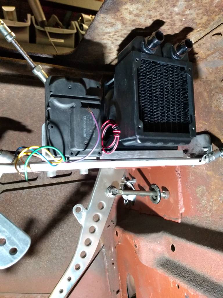

  3. Here it is installed up in the scuttle of the Modified. Fits like a glove. I could have used the 3.5Kw version but it would have been difficult to hide it. The other thing in there is a servo from a Lexus Aircon system. It opens and closes the cowl vent. IMG_20181201_131039342.jpeg

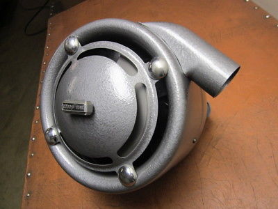

    Got this one on eBay for my 49 Dodge coupe...never seen a Goodyear heater...me likey image.jpeg

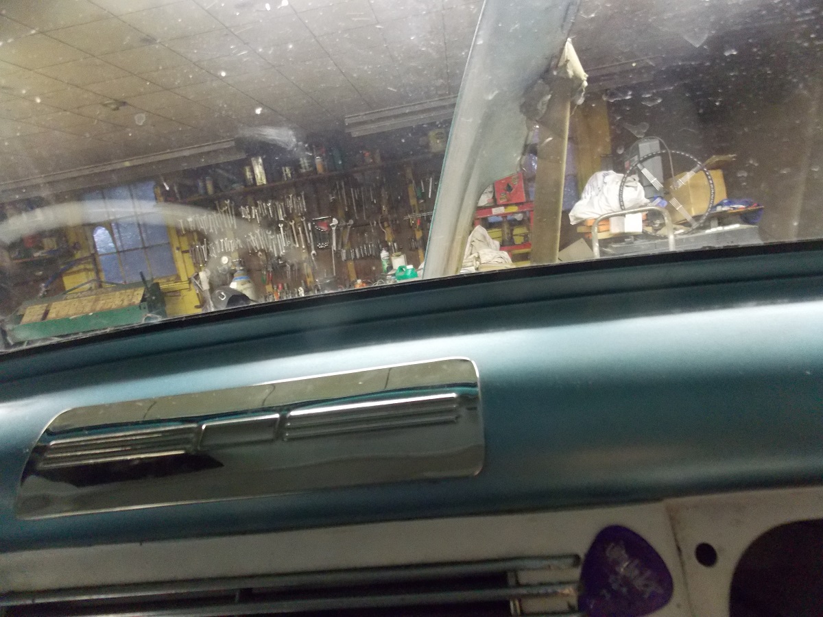

    I finally got my heater/defroster working yesterday. It's a Olds unit with a 2nd smaller blower for defrost.
    I made the 40 dash radio delete plate to open in several positions to change flow to the windshield. Also added deflector fins in that plate to move air to the far sides. Last evening we had light drizzle at the festival and W/S started to fog up inside, the defroster worked super fast.

    I found a Goodyear too! Working on cleaning it up and putting in a 12v motor. It has a round, swivel face with 3 doors on it to open/close and direct air. Pretty slick design really.
