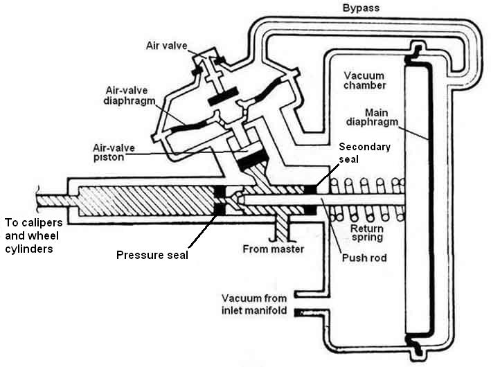

    Hi Harry,
    Those Red Rooster clutch kits are 90% offset mounting brackets and levers to the pedal [to clear existing brake boosters]
    On a Tri-5 's ...... If you convert it to Hydraulic clutch with a master cylinder and external slave cylinder from a Jeep [as you suggested], you have most of the battle won.
    Then fit a remote servo PBR VH44 up between the grille and radiator support where there is plenty of room.
    They are about USD $60 from Australia
    https://www.ebay.com.au/itm/VH44-Re...538489&hash=item213483ac29:g:KVYAAOSwwz9dX5EQ
    With the remote servo you will only need some plumbing from the master cyl to the servo, and from the servo back to the slave.[edit: plus a vacuum hose]
    You will still have normal clutch operation with no vacuum .
    Here is a schematic of how they work.
    We had looked at fitting a normal small diameter "booster only" inline, as a mechanical linkage. Mounting the pedal bracket to the bellcrank with a fabricated M/C pushrod to the clutch fork but on a Tri-5 there is no room [but this is a viable option for other vehicles]

    Thanks Mimi! The remote servo seems the way to go, as with my LHD Chevy, both intake and exhaust manifolding are on drivers side and clearance is very tight with steering column and brake master cylinder. The wider Weber intake setup in addition to the Langdon split exhaust manifolds dumping right into the area now occupied by the OEM mechanical clutch linkage don't help, either.
    One question regarding the Holden remote servo setup...... My choices for Jeep clutch master cylinder and external slave cylinder are either 3/4" or 7/8" piston diameter (both being same size depending upon choice). The Holden piston diameter is stated to be smaller at 5/16" diameter. Will this work with the larger master and slave cylinder sizes I will be using...... Or will I need to locate a remote servo having same piston diameter?
    Thanks,
    Harry

    Hi Harry,
    Firstly that particular "Kit" was marketed as a Holden kit. I only showed that because it came with brackets.
    In Aussie they were fitted OEM on 318 Valiants because the normal style would not clear the rocker covers on RHD cars.
    They were fitted on a lot of British cars [Hillman Hunters, MG's, Ford Zephyrs Etc] and I also have been told some USA Chrysler's .
    These were designed for when manufacturers were changing over to disc brakes on the front wheels only [they were used on the front circuits only]
    With the Master/Slave cylinder sizes it doesn't really matter at all with this servo. [just get them matched to each other as if it was normal.]
    These servo's are a "flow through" design. So every cc that gets pumped into it, the equivalent gets pumped out. [Imagine a cylinder with a floating piston inline]
    If the M/C pushes too much volume [or there is not enough vacuum ***ist], it pushes the little piston off the pushrod/seat allowing fluid to flow past. Effectively only having partial ***istance.
    But in reality that doesn't happen
    , because the extra volume will open the Air Valve Piston before it starts pushing the slave piston down the bore.
    When you release pressure ,the air valve piston will pull the "air-valve-diaphram" back and the engine vacuum will equalize on both sides of the main diaphram.[so it can return]
    They all work on the principles of equalibrium [or balance]
    here is a Schematic to help you understand.
    Edit: You will notice the piston travel is greater than the Diaphram/ Pushrod travel. This is a safety feature that allows flow through the slave piston if the diaphram has bottomed out.
    So if the clutch slave requires more volume than the servo cylinder can supply, the last bit of travel would be un***isted.
