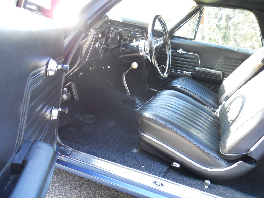

    I shift my Turbo 400 like a manual, with this shifter it feels like a stick.. Its a Hurst Autostick I.. It's bolted to the transmission and has gates..
