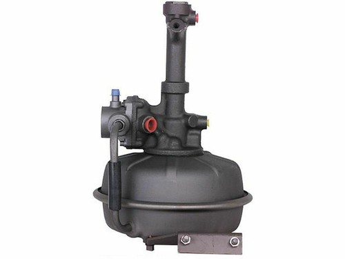

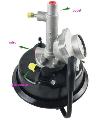

    This is going to be an interesting exercise. Looks like I will be using the Aussie sourced PBR VH44 remote brake booster for the hydraulic clutch......
    Cannot seem to find one with large enough slave cyl. dia. for the brakes though. So I located a remote mount hydro-vac unit for 1963 - 1964 Chevy C50 2 ton truck and will run a 1-1/8" brake master cylinder in my '57 Chevy sedan......
    Hoping this will address clearance issues and that adding a booster to both the brakes and hydraulic clutch setup will keep pedal pressure low enough to allow retaining a manual transmission in the car. Even with bad knees.
    The 292 inline 6 I am building is cammed for low to mid-range power, so it should make good manifold vacuum, but with 2 vacuum boosters to supply, it probably wouldn't hurt to add a vacuum storage canister and vacuum pump as well.
    Just need to figure out where to put the remote boosters and vacuum storage canister now. Have a new electric Cadillac vacuum pump like those used on old circle track cars around here somewhere.
    Maybe some of this can be mounted in the trunk on the shelf above the rearend. I usually install a modified '62 - '64 Chevy gas tank as an auxilliary tank there when I build a '55 - '57 Chevy. Will need to see how it all works out. If the tire well is removed, a larger gas tank from a Ford van can be installed under the trunk floor, but I am not sure if I want to do that, as I would then need another place for the spare tire.
    I am also rebuilding and adapting a T-85N 3-speed overdrive Ford truck transmission with 2.99 1st gear ratio for the Chevy and this will allow shifting without the clutch once car is moving (when OD is engaged)......
    This will be a road car used occasionally for towing a boat and trailer. That's why I am building the mechanicals like a truck.
    Will let you know how it works out.
