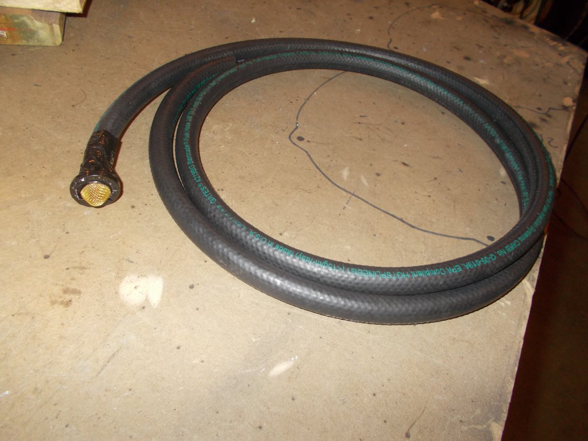

    Installing a vent tube, [3/8" gas line] for my gas tank, I have the roll over valve but every year some mud wasp kills another bug, stuffs it up the open end of the vent tube, lays an egg and packs it with mud...
    so this year I bought a garden hose screen, about $1, br*** domed screen molded into a rubber ring...
    it had a just smaller inside diameter than my 3/8" rubber gas line's outside diameter, so I sanded the leading 1" on the end of the 3/8" gas line on my 1" belt sander...
    fit good... layed a little silicone bead between the two... black duct tape outside layer...
    silicone drying...

    push on strainers from your paint gun siphon tube work if hard tube vent

    I use these, marine supply has them. S/S boat fuel tank vent (Breather or spark arrestor) with gauze screen
