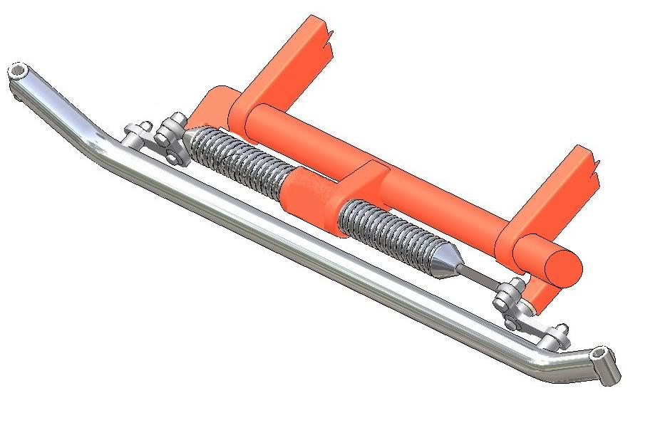

    This is how I would approach the friction shock idea.
    Integrate them into the pivot, and you will never know they're there.
    The stiction of an oring in its bore will not be enough to do much good as far as damping goes.
    Maybe a shaft wrapped in clutch lining that travels inside a tube. If you make the piston that the lining mounts to adjustable for diameter (like say those tighten in place rubber bung plugs), you'd have a very good approximation of a linear friction shock. Have to figure out some way to seal the water and grit out though, or it'll eat itself in short order .

  8. Fadt,
    Have you looked into some of the older design mountain bike shocks? Years ago, I knew a guy who built a single seater autocross car using 4 of them and they worked great. All the newest ones have remote reservoirs, so they won't fit inside your springs; but the older ones weren't all like that.
  9. fadt
    Joined: Oct 3, 2010
    Posts: 128
    fadt
    from England
    Yep. Look at them. Told by the makers that they are not designed for the kind of loads and motion on a car. It may be something to look at more closely, though.
    The shocks used these days (mono type) on the rear end of bikes,are again said by the makers not designed for the kind of motion on the front axle of a car. Its due to the frequency, which on a bike is slow compared to car. At least thats what the manufactures say. Mind you that does nt mean they wont work.
    Gerry
  10. Slow frequency? You need to go see what folks are hitting on their downhill rigs. MTBs of today are closer to Motocross bikes than anything. I have a couple Fox Vanilla coil overs we are using on a street bike but may steal them for my salt car.

    If you can somehow get a pair of hydraulic lines out through the central spring seat, you could run a simple hydraulic cylinder inside each spring, plumbed to a valve block and reservoir mounted more discreetly e.g. behind or below the radiator. That way the hydraulic piston area can be the largest that'll fit inside the spring, as you won't have an annular reservoir taking up space. And both dampers can share a common reservoir.

    If you can somehow get a pair of hydraulic lines out through the central spring seat, you could run a simple hydraulic cylinder inside each spring, plumbed to a valve block and rese.....
    Interesting idea and very do-able. At the moment I just want to keep it as simple and clean as I can

    Would having a different rated spring inside of the larger one, that osculated at a different rate, be as effective as a shock? Especially in a very limited movement situation like that? Isn't that one of the benefits of dual valve springs... they control valve float through differing oscillation?

    The object is to keep the ratio between the two levers on the bell crank as close to 1:1 as possible, right?
    If you lengthen the arm that attaches to the spring, it wouldn't look right. The springs and shocks would stick up in the air.
    That leaves the other side of the lever. So, how about moving the pivot point of bell crank outward, closer to the ends of the axle, thereby shortening the long arm?
    If the shocks are too short, lengthen either the mount between them or lengthen the shock absorber shaft - as in the crude picture below. I prefer lengthening the shaft. It just looks lighter and cleaner to me.
    Also, I would only slot one of the bell cranks. The other would act as a panhard bar to locate the axle laterally.

    The limitation on the horizontal arm is the amount of travel one needs to accommodate. The shorter the arm, the greater the angular movement at any given suspension travel: and it reaches an absolute limit at 90° in both directions. That is a, say, 2" arm allows one only 4" overall travel from full bump to full droop, which might not be enough, and which might too easily induce an over-centre situation.
    I don't know what is generally acceptable in these sorts of applications, but I would not want the sweep of such an arm to come near to 180°. I'd think about 120° to be an absolute limit, and try to aim for 90° in general use. A 2" arm will give a mere 3.46" of travel at 120°, an a tiny 2.83" at 90°. I'd say one would want at least about 6" of travel for real-world road use.
    The above considers the arms simply, and the situation becomes more complex when one considers the slotted end. The shorter the arm, the greater the ratio of the required slot length to the arm length. In any event this arrangement exhibits a variance in mechanical advantage such that the greatest effective spring rate is seen with the arm in the horizontal position. That is, one has falling-rate geometry, which is not ideal, and the effect is exascerbated as the slot length increases in relation to the arm length.
    And using one arm as an effective Panhard rod not only leaves one with a Panhard rod only 2" long (to stick to my example), and consequently a relatively great lateral motion in bump/droop, it doubles the required slot length on the other side: and that means constant-rate springing on one side and seriously rapid falling-rate geometry on the other!
    It was good thinking, wsdad: the question needed to be asked. That it turns out to be a dead end doesn't mean that we don't learn something going there and back :D

    I just had another thought. Instead of putting a shock absorber inside the spring coil, let's imagine we have a hydraulic cylinder, as someone mentioned earlier. It is as large around as space permits. Now let's run some hydraulic lines to a narrower, longer cylinder (ie: the real shock absorber) hidden away somewhere that provides plenty of space for it (perhaps inside the frame rails).
    We have created a hydraulic lever which gives back the travel the shock absorber needs to operate without shortening the actual lever on the bell crank.
    In fact, we could simply leave the metal springs out altogether and just use the hydraulic cylinders - pressurizing the hidden cylinders so they become air springs.
    Would that be too Rube Goldberg?
    "...one has falling-rate geometry, which is not ideal..."
    That's true. But I wonder if it's enough to matter in real-world driving?

    Gerry if your laying the shocks over you need gas not oil.
