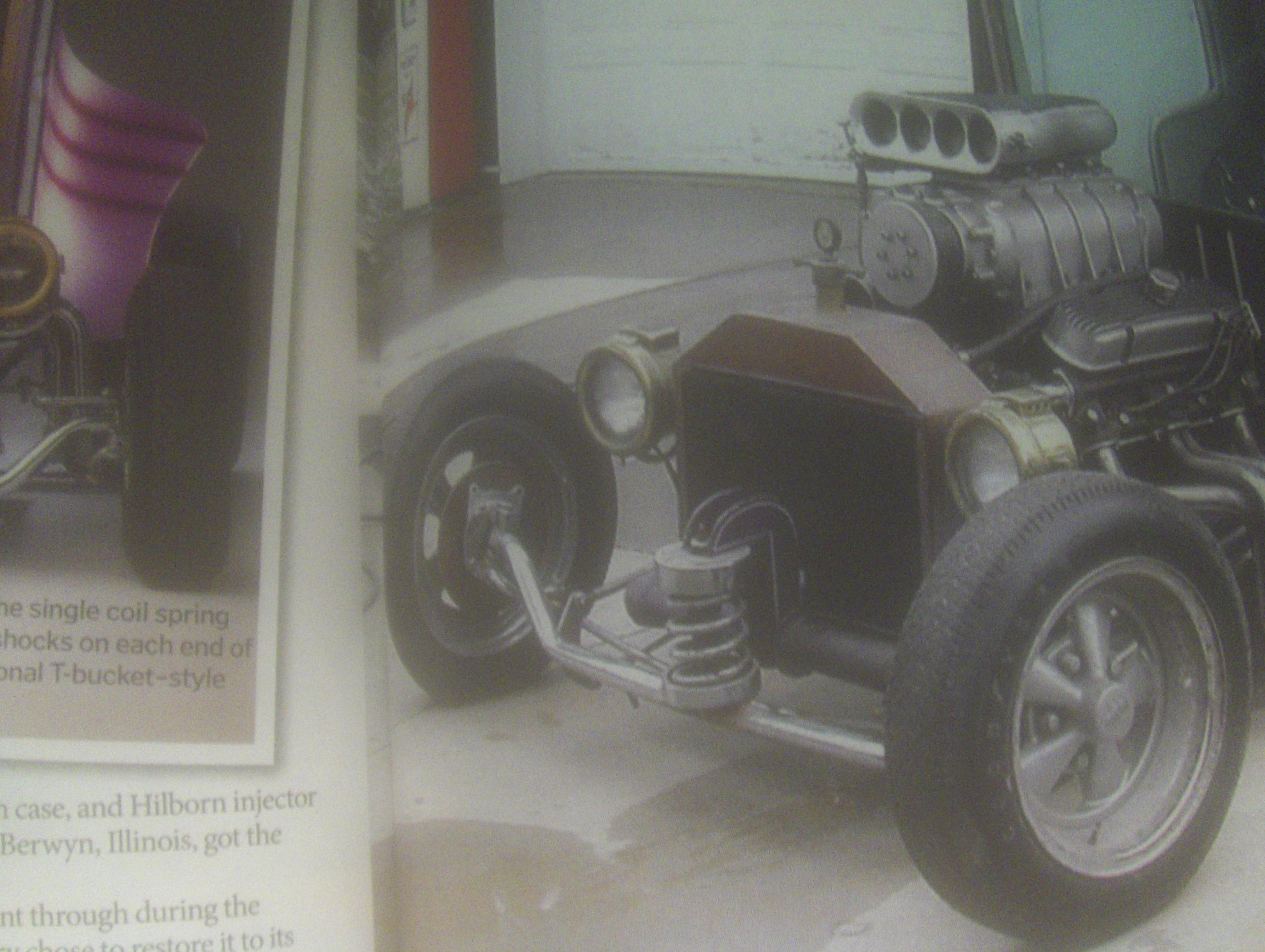

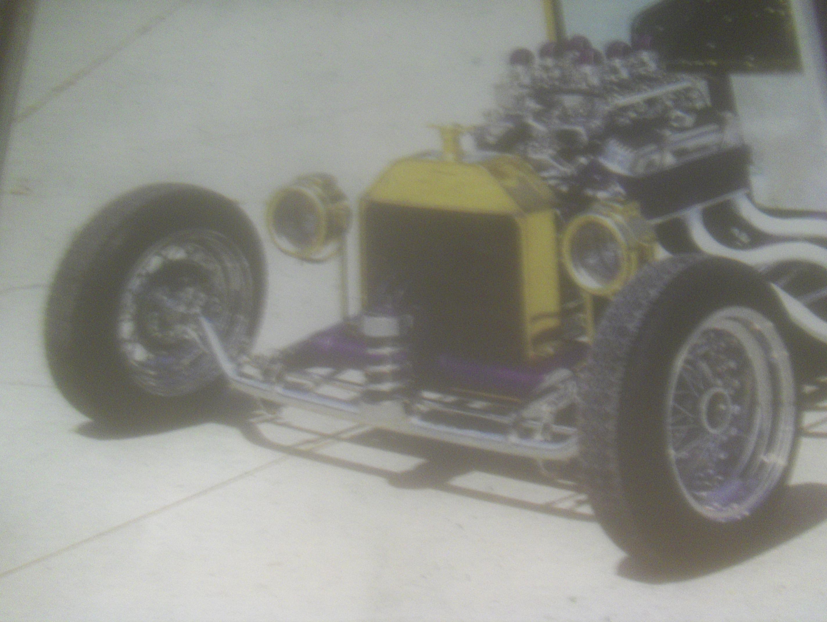

    I built this chassis for Gerry and it's somewhere in the region of the 8th or 9th
    T bucket opposed coil chassis i've built, albeit a lot cleaner than Dan's original design.
    It also has an opposed coil independent rearend.
    I pioneered 'correct' model T & model A hot rod chassis', bodies and related components in England during the mid '60s into the '70s. Prior to this there was very little if anything at all being built here which was even close to contemporary American
    hot rods, nobody here seemed to have the right idea about them back then.
    Over the years I've manufactured various early Ford chassis, T bodies
    (8 types), A bodies (3 types), Tube axles, radiators, suspension components, wheels pick up beds, gas tanks etc. All before anybody else here got on the bandwagon.
    I've known Dan Woods as a friend since just after he came back from Vietnam (1969 ?), to date, over 40 years. Through Dan, back in the early 70s, I got to know many of his contemporaries as friends including Lil' John Buttera, Art Chrisman, Steve Davis, many of the original team from Roth studio's and even Ed Roth himself and many others. Some of these guys were and are genius' and to say much of their thinking rubbed off on me would be an understatement.
    For Boyd Coddington in 1982, I came up with the original '34 roadster concept which was eventually developed into the Boydster style. I designed almost the entire new wheel range for Boyd when he started up the wheel business again in 1998. Also, designed the Led Zephyr, and the whole (build almost the entire car from aluminum), concept for the Aluma Truck, and the Aluma Tub, which was the natural progression of the same concept. Plus many other suspension components including the 'banana' front uprights, aluminum dropped axles and related components, which Boyd used on his later chassis
    In the past decade I developed, produced and marketed the 'New' Stromberg 97 carburetors (which are far superior to the originals), with my partner in the company. Nobody in the US could believe we did that in England !
    I guess that's a pretty good CV and should go some way to show I know what I'm about with hot rod design and construction, particularly T Buckets.
    First and foremost I'm an artist, fabricator and engineer. I'll at least do sketches or renderings to get a feel for a project, with pen and ink drawings where necessary for overall layout and machining detail, or else i'll use CAD/Solidworks. Very little is guesswork although at times I can be left scratching my head over some problem or other.
    This thread started as a question about who still builds opposed coil frontends and ended with discussions about springs, needle rollers, friction shocks, and Dan Woods' original Milk Truck front suspension.
    Here's my two cent's worth in no particular order....
    Dan built the Milk Truck around the age of 16 to 18 in his home garage as a show car, not a street driver. I doubt he was a chassis genius back then so suspension design and geometry probably didn't come into it. The single coil spring at the front just looked cool and that was enough. It led to Dan getting a job at Roth studio's until he was drafted so, I guess, it did the trick. The single vertical coil has no roll stiffness at all. It would work ok in a straight line but, as somebody said here, would act like a three wheeler in corners - so no good for the street.
    Also, Dan's never worked in south Florida. Since the early eighties he's been in Salinas, Cal. working in and around Carmel/Big Sur building multi million dollar houses.
    Do horizontal coils work ?
    Of course, will work at any angle. However, in a system like this using unequal length bell cranks, the spring rate would need to be calculated on the basis of wheel loading x motion ratio x bell crank ratio - which, on this front end is 2 to 1 (6" x 3" bellcrank arms), for example : If the front wheel loading was say, 272 lb, this would be multiplied by the motion ratio - lets say a loading of 439 lb at the bell crank axle locator, this would then be multiplied by 2 (bell crank ratio), to give a figure of 878 lb/inch for the spring rate. The springs can be wound either stiffer/shorter or softer/longer to retain correct frame height & depending on the ride required but they must remain under compression throughout the suspension travel - same as any other suspension type. Frame ride height adjustment is by adjustable clevises on the spring cones - approx' 1" at the cone, 2" at the end of the bellcrank long arm.
    Actual spring calculation is a little more complicated so this is the simple version.
    As it happens, because the rear end was a little more complicated to figure I had the spring rates for this car calculated at McLaren's F1 racing in Woking, Surrey, who also build the Mclaren F1 road car. So I'll add - nobody there saw anything wrong with this suspension at all, even the friction shocks, despite the sophisticated systems they deal with on a daily basis.
    There's also some questions here about whether friction shocks work:
    Almost all the T bucket chassis i've built have been fitted with friction shocks whatever spring medium is used, transverse leaf, torsion bar or opposed coil, because they can be hidden or combined with another component - Torsion bar arms. Dan Woods designed his opposed coil setup with friction shocks simply because they work & are invisible - they're part of the bell crank, I do the same for the same reason. I have no idea what friction material Dan used but I use Nylatron, a tough, graphite impregnated Nylon used in engineering and it works fine.
    I recently spoke with Jim Capon, the owner of another opposed coil suspended T
    I built around 34 years ago (he's driven that car 140 mph), he said the front suspension works great, with the occasional tweak of the friction shock compression cone.
    Any and all other ideas for alternative shocks are a no go really because, shocks can't fit inside the front springs without having larger dia. springs and gas shocks,pipes and parephernalia. There's no way of running a torsion shaft through the bell crank pivot back to behind the radiator with yet more bell cranks, it's an engineering nightmare with little space through the frame rail or between the engine and radiator. The thought of using small 1" dia. shocks immediately rings alarm bells with me because they will simply not be able to deal with the energy absorbed as heat. They're too small.
    The one and only disadvantage with friction shocks is they work on a 50%/ 50% ratio which means they damp the same amount in bump as in rebound, whereas tube shocks usually have less damping in bump than rebound. But it's no big deal, friction shocks work, otherwise I wouldn't fit them.
    At the end of the day it's all down to what somebody wants, a really clean, sharp setup with a bit of maintenance here and there, or a maintenance free, clunky looking setup. It's all about compromise.
    The use of roller bearings in the bell cranks:
    All of the opposed coil assemblies i've built prior to this used bronze bushes and they work great. However, for this one I felt I'd use something a little more sophisticated as it should cut down some mechanical friction and perhaps give a better ride.
    So I decided to use the same type bearing as used in Jag' rear end lower control arms, and similar to those in driveshaft UJs. Not the type used for high speed shafts which are needle rollers but the type used for reciprocating motion - back and forth. Same type of movement, same type of bearings - Seems quite logical thinking to me ! There are no greasers fitted, but they could be. However, I figured these bearings would run for many thousands of miles simply packed with grease, which would be replaced/repacked, I hope, during routine maintenance.
    Using the bell crank arm as a Panhard rod:
    That's exactly what I did here. Not entirely sure which way it was done but I think the LH arm fits into the circular hole in the axle locator, the RH has a slot to allow shortening through the arc. The whole point throughout was to keep the front end as minimal visually as possible, so this was the compromise. The downside to this layout is, it will produce some lateral frame movement on uneven sufaces because of shortening through the bellcrack arc - similar to that experienced with shackles on a transverse leaf spring (or Woods' original opposed coil setup which used rod ends as shackles), & without the use of a panhard rod. On smooth tarmac it shouldn't pose too much of a problem.
    Far from this setup being not thought through, as somebody previously mentioned here, a great deal of thought (involving chassis dynamics theory, geometry, engineering & aesthetics), went into every part of this chassis and while certain aspects of the geometry may not be 100% in the opinion of some, at the end of the day it's a T bucket hot rod which needs to look great & be safe first and foremost, and secondly, drive in reasonable comfort on the occasions it'll be taken out when it isn't raining here. It isn't a family car where expectations are somewhat different.
    I'll say again: This chassis, as with every other vehicle chassis on the road today of whatever type is a compromise between, aesthetics, engineering & safety, comfort, ease of use, and even time & financial budget - both of which are never enough to do things as we would all wish to do.
    I found Dan's original rear mounting position of the lower centre link (under the front crossmember), left something to be desired as - on cars with front brakes: The braking torque wanted to turn the whole front end over itself with the lower axle mounting lowering it's position and attempting to overcome forward weight transfer, lift the front crossmember upwards, thereby unloading the springs. I found it best to mount the lower link as close as possible to the bottom of the front axle tube and extend the link as far back as possible behind the radiator. This would cut down on caster change and bump steer during suspension movement and provide less lever action of the lower link to lift the front crossmember during braking.
    I think this lower link could be even longer and would probably work best as an apex (Y), locator with the rear mounts located somewhere under the motor mounts. This would also provide lateral location of the front axle while doing away with the bellcrank lateral location system.
    After all this discussion about the above which really are no more than picky details which obviously have already been thought through prior to or during the chassis build. I can't fail to notice some things in later pics of Gerry's car - alterations to the rear chassis which have been made, which I would say are far more serious than the previous discussions.
    I'll attempt to explain here:
    The only instructions I had when I could be finally persuaded to agree to build this T was, A tall top T bucket like Leg Show with an opposed Coil front end and no rear radius arms - and it would be Candy Red.
    The whole design of the car was down to me and I had kicked the idea of an opposed coil independent rearend around for quite some time beforehand.
    I wanted to do the chassis with as few fastenings showing as possible, in particular the front end would be as minimal as I could make it- even less so than on my own T chassis.
    The rear end without radius arms posed quite a few problems because it meant the lower control arms would have to be solid units of the type used on Jag's to keep the wheels in the correct place and control torque reaction. I opted for the tapered paddle design I used simply because it was the strongest (an internally braced tapered box), and the cleanest, when assembled with the tapered rear uprights - which are a continuation of the same taper as the paddles but angled upwards to the hub carrier. Everything tapered and with as few obvious fastenings showing as possible.
    When the rearend is mounted without radius arms like this, all power and braking loads are transfered though the differential and rear crossmember into the kickup and into the main frame rails. So the whole assembly needs to be extremely strong to resist vertical, horizontal and axial torque loadings, plus bending and twisting loads in the rear crossmember and kickup. Normally with a Jag' rearend in a hot rod this is handled by radius arms which transfer power and braking loads through the vehicle thrust line directly into the chassis. Torque loads are normally handled by small dia. strut rods, which I almost always attach to the main rails rather than the kickup.
    With this chassis, as I intended to mount the diff' behind the rear crossmember requiring a cantilevered & sculptured mounting, I felt it needed a system which integrated the whole assembly of main rails, kickup, rear crossmember and differential into one unit.
    I already intended, and made, a small bellypan to cover the bottom of the body just to keep things clean under there, and in order to transmit rear end loadings directly into the main rails I extended the control arm lower diff' mounting forward on the thrust line with two tubes which picked up the chassis inner crossmembers by way of tabs just outside the bellypan - all that could be seen were these two tubes and the driveshaft passing through the 'pan.
    The whole point of this was to transmit loads directly in a straight line between the differential housing and frame rails which in turn located the whole rear assembly horizontally, vertically and axially without relying on the cantilevered crossmember to do a job it's not designed to do.
    However, i've noticed this whole lower diff' locator has now been removed and in it's place are the normal bolted-in small strut rods angled upwards and outwards to maybe 2/3rds the height of the kickup.
    This has now seriously compromised the integrity of the whole rear frame/rearend assembly to the point where I wouldn't be surprised if fatigue doesn't begin to take it's toll at either, the cantilevered part of the rear crossmember mount where it's welded to the sculptured tube or, more likely, at the base of the kickup where it's welded to the main rails - two rectangular section butt welds !
    It doesn't take much to imagine the tortuous route the power and braking loads now have to take through a series of 90 and 45 degree bends to be fed into the chassis, whereas the original design fed these loads directly into the main rails in a straight line with very little torque loadings being fed into the crossmember at all. The small strut rods now fitted only feed loads into the kickup, not the main rails and, being bolted in with no triangulation serve little purpose whatsoever to keep that rearend aligned.
