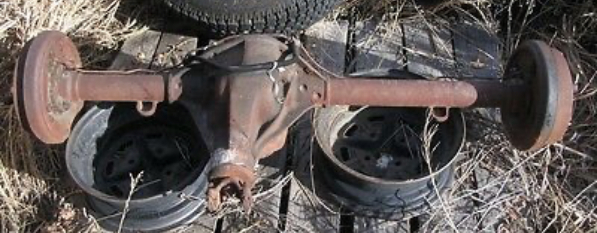

  15. The jeep 41 and 44 has a large offset to the passenger side
    10 spline 41 and 44 axles will interchange as well as spider gears.
    If wanting to use the jeep 41 axle to narrow another 41 you will need to figure out which side you need and purchase 2 axles or rear ends. There is a lot of difference between R and L axles.
    You also need the matching spider gears.
    The jeep axles are 2 piece.
    You would then need to see if axle bearings will interchange.
    Jeep made a 2 wheel drive cj. The center section isn’t offset like the 4wd. However it is 4 lug
    Same width overall as the 4wd.
    I’ve got a British banjo rear that has an aluminum center section at the shop at work.
    I also was elbows deep in a CJ3a rear axle yesterday. I have the axles out if measurements are needed.

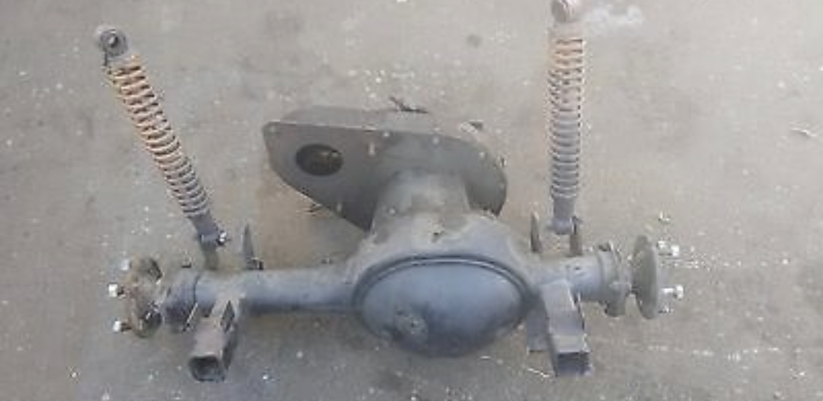

  22. Boneyard51
    Joined: Dec 10, 2017
    Posts: 6,747
    Boneyard51
    Yeah, little known fact! Don’t remember the brand of cart, but they were pretty common around here. They bolt the electric motor to the five bolts on the pinion housing. I always thought I should grab a few….but didn’t do it! :(
    Bones

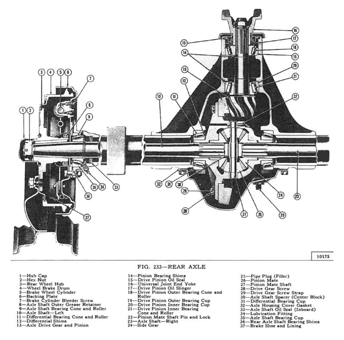

  27. robert graves
    Joined: Nov 2, 2018
    Posts: 263
    robert graves
    Are they all tapered shaft , what I have is semi float that bolt on with bearing carrier ?
  28. The Jeep’s are tapered shaft. There is supposedly a last year version that isn’t.
    My axle is tapered with a pressed on non sealed bearing. Preload is set with shims. Has a seal on both sides of the bearing.
    They are semi float and have a bearing retainer similar to a 9 inch Ford.
