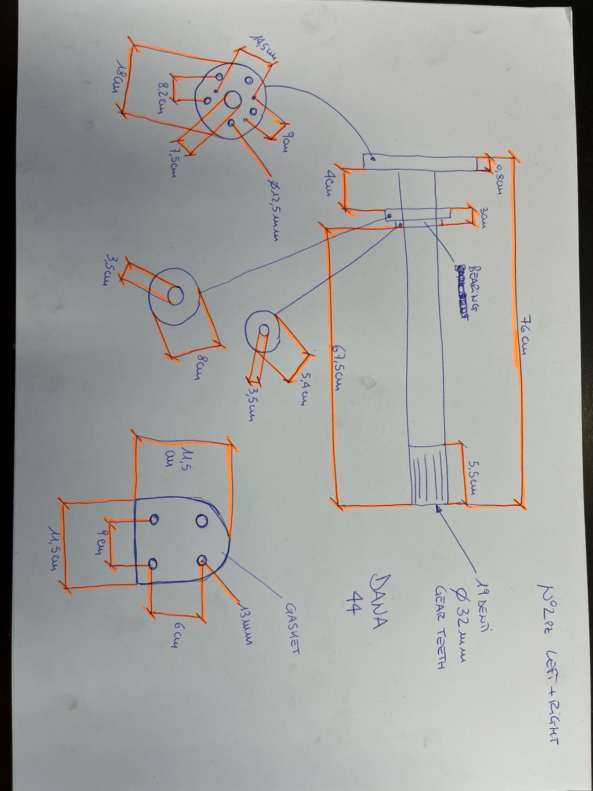

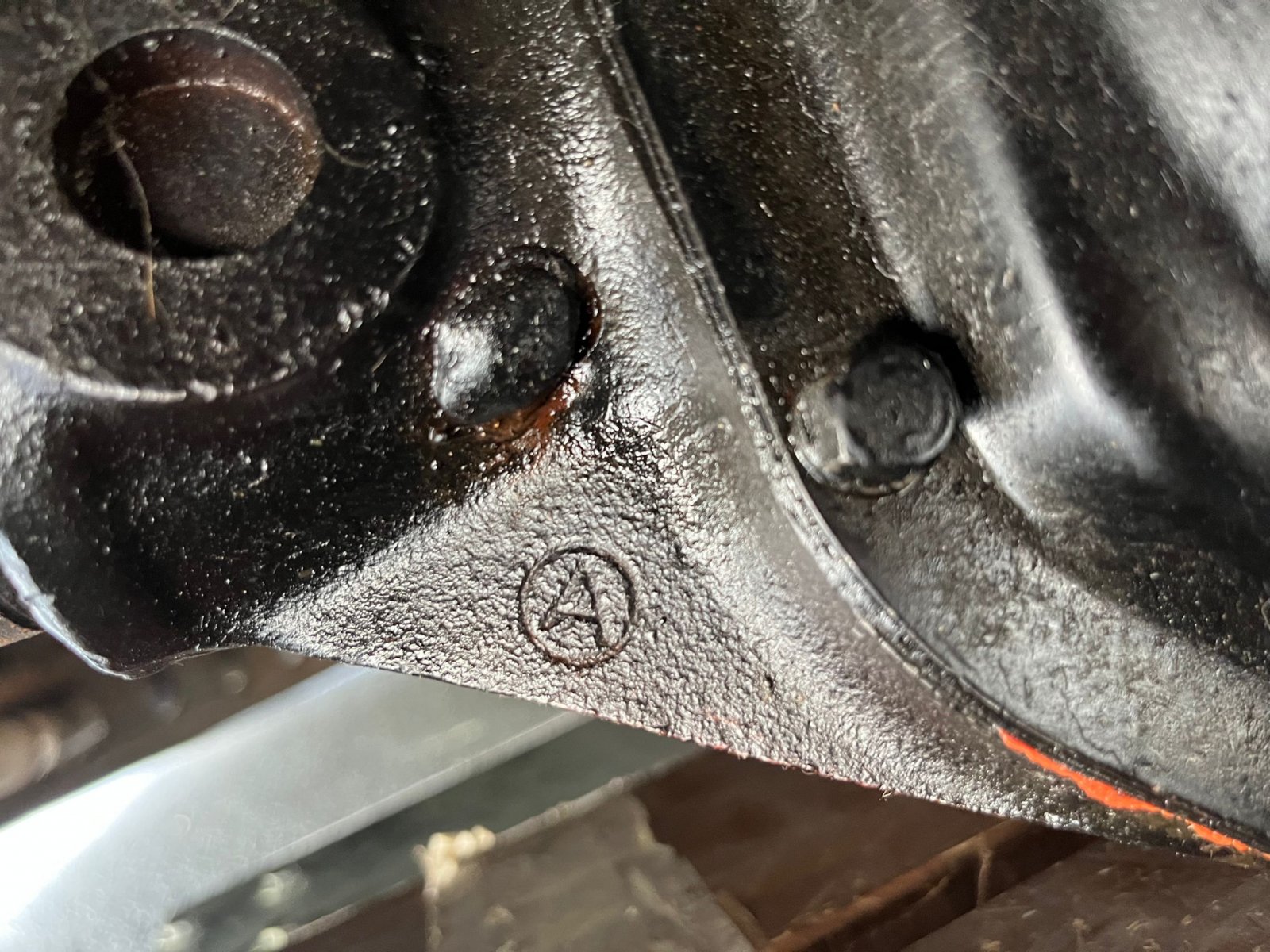

  26. MarcoITA
    Joined: Aug 2, 2022
    Posts: 2
    MarcoITA
    Hello guys,
    can anyone help me figure out what kind of axis is installed on my Mercury?
    Boneyard51 likes this.
  27. 51 mercules
    Joined: Nov 29, 2008
    Posts: 4,426
    51 mercules
    THe on
    My 51 Merc has a Dana 41.
  28. 55blacktie
    Joined: Aug 21, 2020
    Posts: 850

    Joined: Dec 10, 2017
    Posts: 6,776
    Boneyard51
    I think the “44” cast in the housing tells you! But with all this misinformation, who knows!
    Bones
