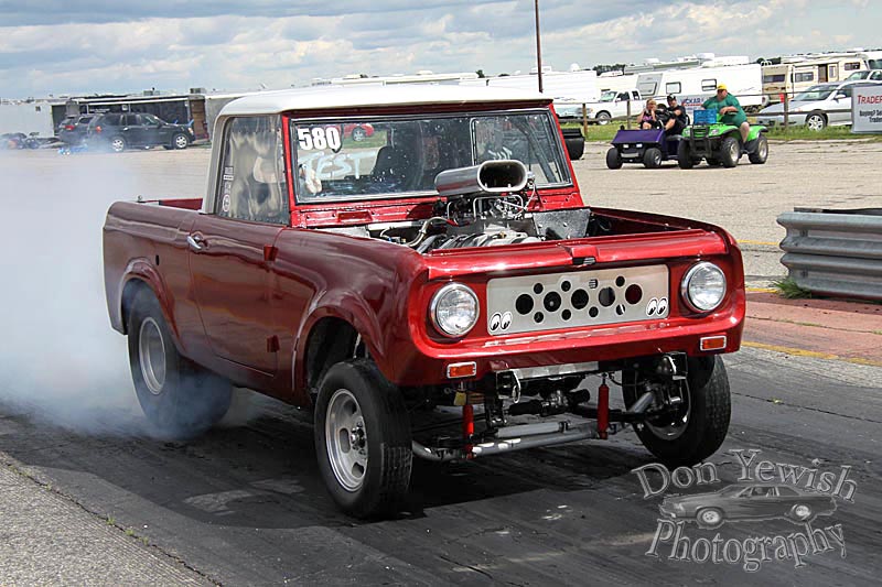

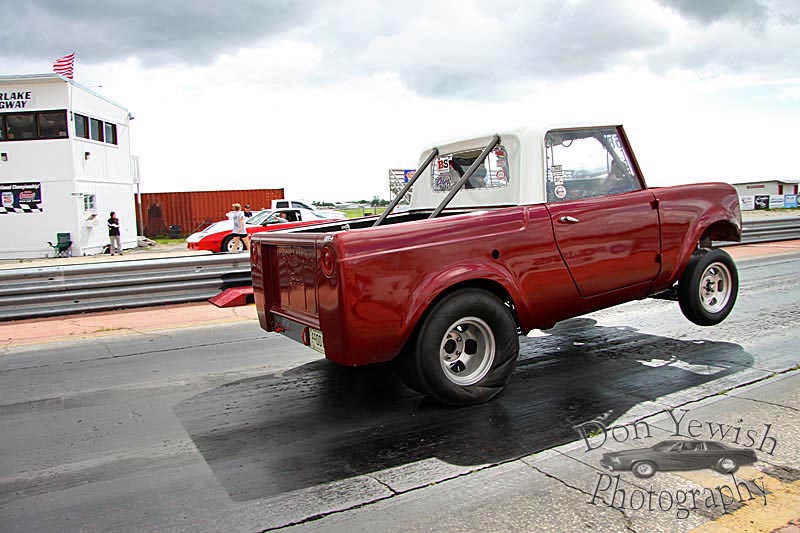

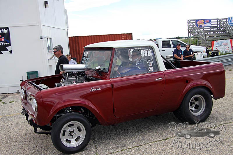

  21. Saxxon
    Joined: Dec 14, 2008
    Posts: 1,835
    Saxxon
    Shots from the only P*** of the day.
    Good shot of the slicks working hard.
    The return road shot has a good picture of my brother Paul. (Black t-shirt / sungl***es) A lot of credit and thanks to this guy for being a big part of the project. It's at his shop where it all happens
    In the background of the burnout shot you'll see a big guy on a green quad. That's Glen Novakowski. His offer to sell me a fuel pump made these shots possible. It's generous actions like this that makes the racing worthwhile at times. Especially when you're struggling a bit. Thanks Glen
    els likes this.
