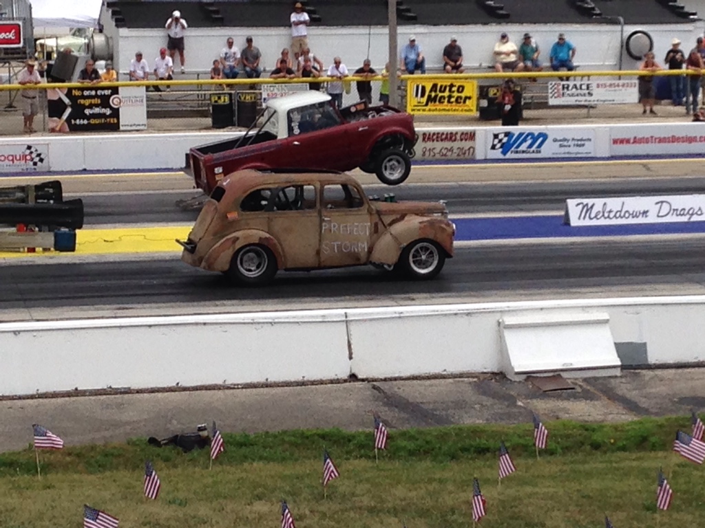

    Some pics from Meltdown 7
    Full credit to Chadly Johnson for the first shot and Dean Coryell for the 2 night shots

    I'm guessing an avatar photo change is in your future.
    Great shot mid wheelie.

    Sure does look like air under that drivers side rear tire too.

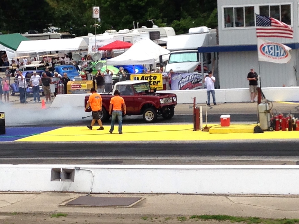

    Same wheel stand, different angle

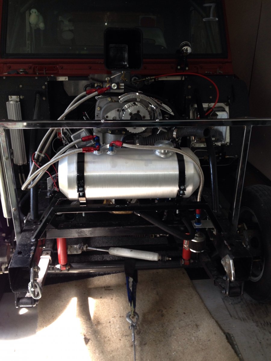

    The Scout gets a bigger fuel tank...
    We found that the blown injected set up sure likes it's alcohol. Much like it's owner more than a few years back. Except I was never fast. In fact I made up for being short wide and heavy by being really slow... but I digress. A quick call to BAM Manufacturing and they made me up this cool 8 x 22 tank to replace the 8 x 17 I started the year with. It should give me almost a gallon more to play silly games with... Next step is to adjust the feed line (too long) as well as the return line (also too long) then replace the broken crank hub and get back to racing.

    But But But if you shorten the lines you will loose about a gallon of fuel capacity :rolleyes:

    That was an old Smokey Yunick trick. Rules stated how big the tank had to be, but nothing stated how long or big the fuel line had to be. So he snaked about 20 ft of 1" line under the car for an extra gallon or 2.
    I got a larger ***ortment of byp*** jets so I'm hoping to reduce some of the fuel consumption by having a better tune. (Way to rich) but I don't mind the bigger tank and even the extra weight on the front. It'll give me some capacity to drive into the staging lanes and back down the return road. Maybe even help keep the front down a bit
