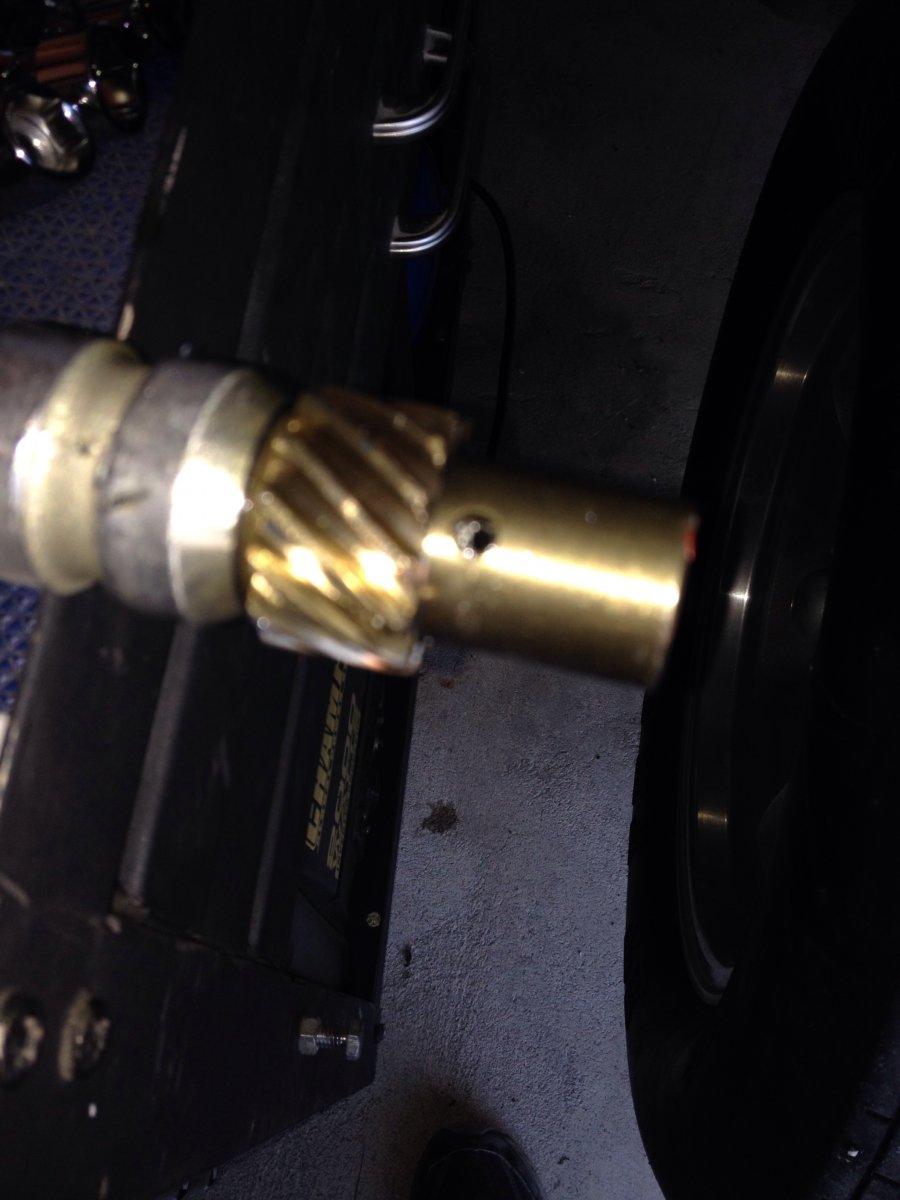

  16. Saxxon
    Joined: Dec 14, 2008
    Posts: 1,835
    Saxxon
    Oh oh...
    Found some chunky metal bits attached to the magnetic drain plug. They look like a broken roll pin. I cut open the filter expecting carnage but found nothing. Might have been the cleanest least ominous filter inspection I've ever done. I'll be dropping the pan to see what lurks within.
    I'm hoping it's nothing catastrophic as I would love to make a p*** or 3 at the MDA Club run - Fall Fall-Out - Oct 1, 2 at Rock Falls raceway in Eau Claire Wisconsin. Only 8 hrs to get there. Almost next door
    els likes this.
  17. Saxxon
    Posts: 1,835
    Saxxon
    Chunky bits turned out to be the roll pin from the Magneto drive gear coming apart. Nothing in the pan, nothing in the filter. I'm going to replace the roll pin and let'r rip.
    Calling it "fortunate" that I decided to change the oil when I did otherwise that mag and gear would have come apart at a bad time.
    Sorry for the fuzzy pics
