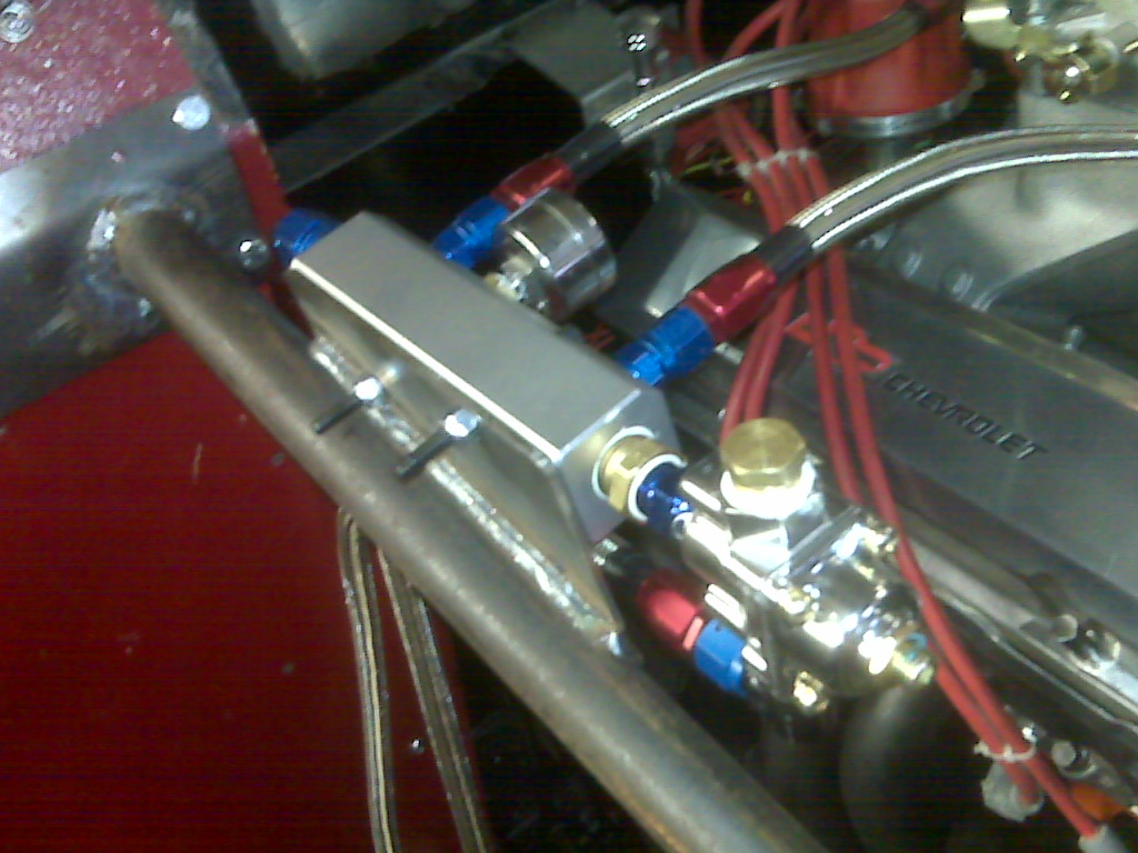

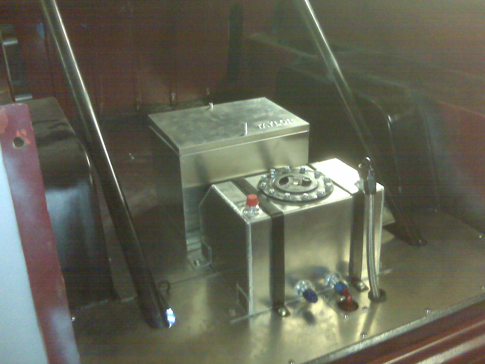

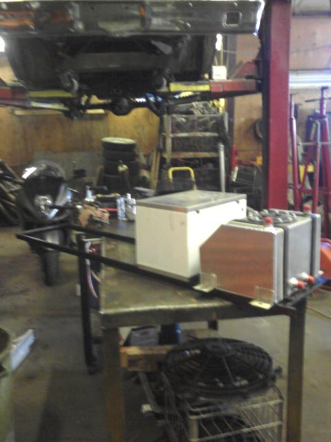

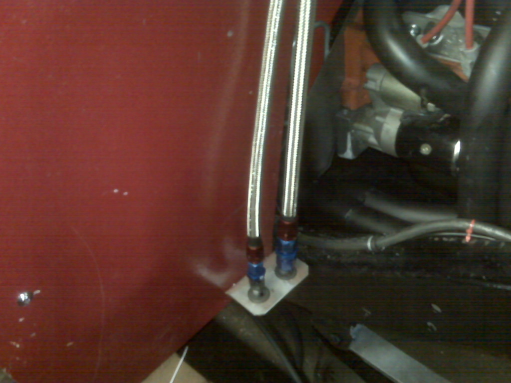

    Spent some more time in the back of the truck.
    I've got some simple tin work in the back to give it the old school racer look. I would like to think I've intentionally made it look old time and a bit like I measured with a piece of string and hacked it out with a hacksaw but that's pretty much my talent level showing through. I'm a long way from the likes of most of you fabricating artists out there but I make up for it by being old short and fat... Actually it all comes together pretty well.
    I mounted and plumbed the fuel cell. This is a good thing since actually installing some of the $500 worth of fittings feels a lot better than when I paid for them. I also mounted the battery box and made up some cables.
    The sub frame I built down the middle of the bed to mount everything is working out far better than I expected. (it's hidden under the tin work) I've used the subframe rails to mount the battery cables which cleans up the underside very well. I also mounted the power switch to the back corner of the box and routed the cables through the bulkhead.

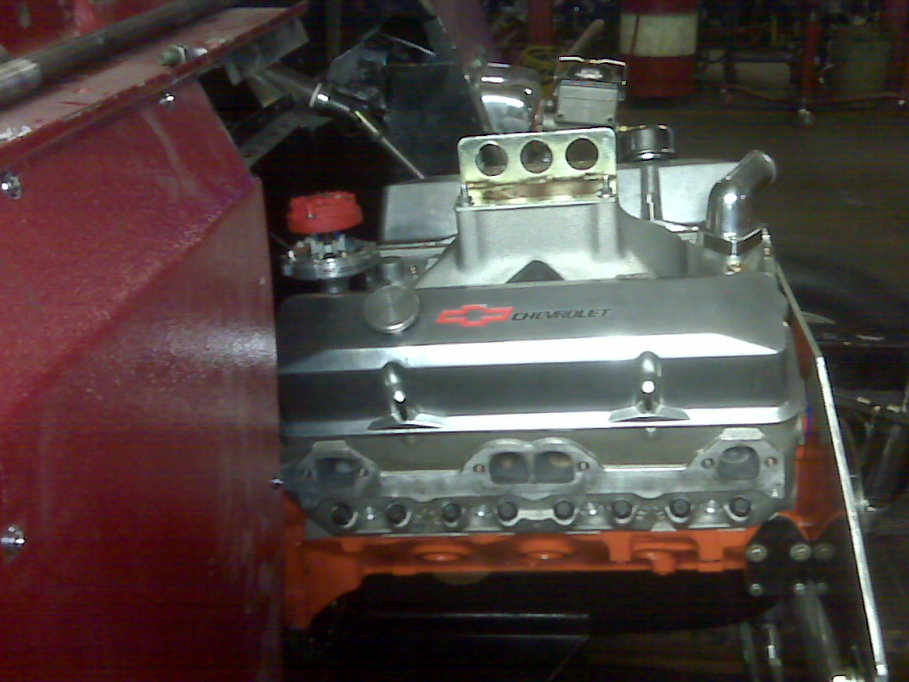

    Since I'm a huge ****er for engine ****... I've included a shot of the Brodix head / intake and carb setup I will be using to sort out the ch***is. I think it looks great and the performance should be as much as I'll ever need or want (est 500 hp) but the hilborn's are still the long term goal. I wish I had taken a better shot of the 1.6 rocker arms. My shaky Blackberry picture does not do them justice. They are pure art.
    A little at a time... it's coming together

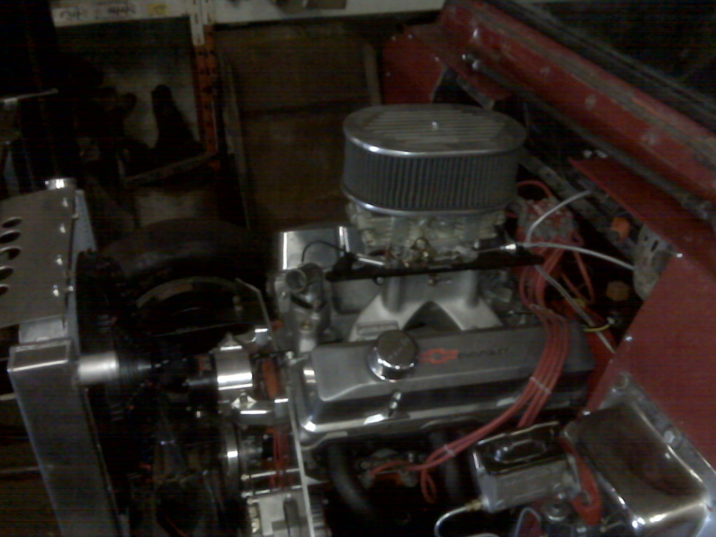

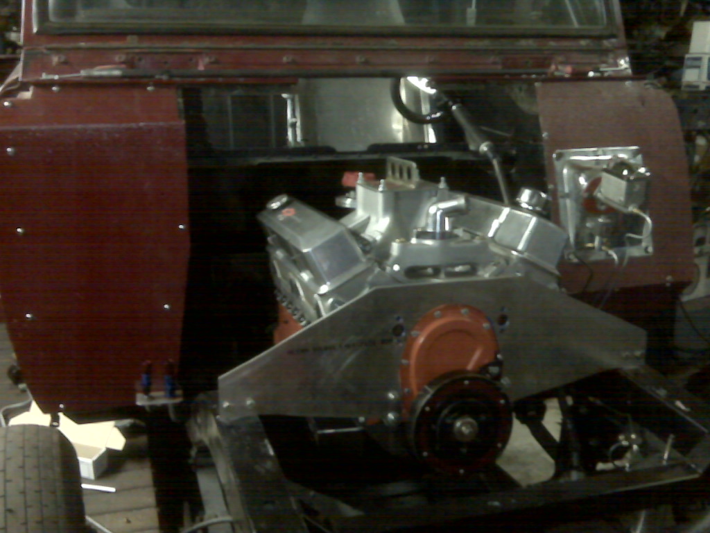

    I've reached that special time in any build when the engine and drive train goes in for real.
    I had to modify the midplate to clear the headers. Our new plasma cutter is stupid simple to use and now I'm convinced every other way to cut metal is obsolete. The problem is that I committed to a set of headers and spent big $$ getting them coated before I knew if everything fit. The p*** side header has 2 tubes that extend past the bellhousing which effectively wipes out one side of the mid plate. In hindsight I should have waited and either custom fabricated a set of tubes or gone with the old school vette headers. Obviously a set of fenderwell units would be very cool but the driver's foot box extends well past the second tube on the driver side. It would mean the header would have to be bent forward to clear the firewall. That's a little too complex for me.
    The modified mid plate is **** ugly but it'll work. For now I'll leave it but I'm thinking I'll eventually ditch the current set up and go to outrigger mounts at the bellhousing.
    Once that was done the install was pretty straight forward. Drop the converter in the trans, add a flex plate to the motor, bolt the whole ***embly together and drop it in like it was planned.
    Next steps will be to drop in the headers and starter to make sure it all fits and clears. It's getting a little tight on the p***enger side by the frame rail. The I can bolt in the rad and fan ***embly then dive into the electrical head first.
    It's getting so close I can taste it
    els likes this.

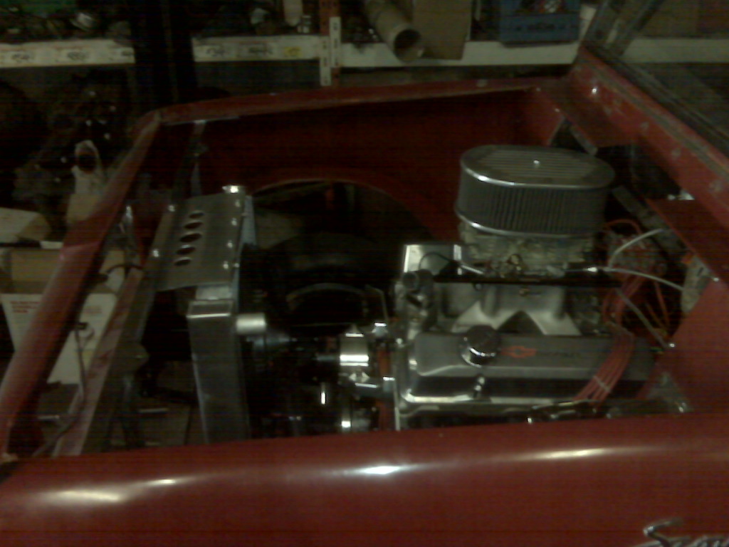

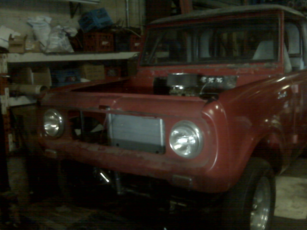

    This was one of those weekends where you take 2 steps forward and a real big step back.
    I got a couple of days dedicated to the scout. In that time we managed to get the truck 90% wired. (Thanks Scott) The beast actually has a heartbeat and would start if I wanted it to. (Too soon my precious... ) We also fabricated up an alternator bracket and mounted the alternator lower driver side. A single groove pully will do just fine.
    Let's talk perception for a bit. I have always seen this truck with a hemi in it so it never dawned on me there would be clearance issues. As I've worked on the truck it is obvious how little space there really is and have a new found respect for the original builders and how well they packaged the big elephant motor. So far it all seems to be dropping into place and everything is fitting pretty well in the tight confines. Case in point. I'm running a reverse valve body T-400 for the low 1st gear and the bullet proof strength. It's been lightend and beefed up internally but it is still a big unit compared to a powerglide. Saturday I installed the TCI trans plate and flywheel shield. The rules say I don't need it but I would rather have it and not need it than need it and not have it, especially with a trans brake. After pulling it all out of the package I was really concerned it wouldn't fit in the trans tunnel with the engine set back. An hour later the shields were in, the trans reinstalled and it all fits perfectly. You can even see the certification stickers on the shields. Too cool.
    I was also concerned that the single 4 barrel small block would be lost in the engine bay. You know, image and intimidation is everything... right ?? Well I'm here to tell you that the engine sits up nice and proud and with the tall K&N oval filter I'm using it will actually poke out of the hood (if I run a hood) It's not a scoop but it will look cool none the less.
    Now the big step back.
    It turns out the headers I wanted to use and already had ceramic coated were perfect for the Edelbrock heads I was originally planning to use but with the change to far more aggressive Brodix heads they are are the wrong size for the exhaust ports. I suspected that would be the case but I didn't validate the su****ion until Saturday. So I'm going to wait and bring in a new set of 1 3/4 square port compe***ion headers. It's another $600 but in the end it will be the correct thing to do. I'm going to use a set of ****** headers for a 63 - 82 Corvette. They seem to be a better fit as they go straight down - street rod style - and make a nice tidy 90 degree towards the back. This should also solve the header to mid plate issues I was going to have with the other set of pipes. The problem of course is now I have to wait for the damn things to come in and they may not clear the widened oil pan I was going to use. Damn ****erfly effect...
    This week I plan to tackle my windows or more pecisely the lack there of and fabricate up some 3/8 rod window frames and then go shopping for some red tinted plexi or lexan. I will also need to fab up a patch and window ***embly for my hacked up back of the cab. Should look pretty racy once I'm done.
    Pictures as I take them
    Updates as it happens
    els likes this.

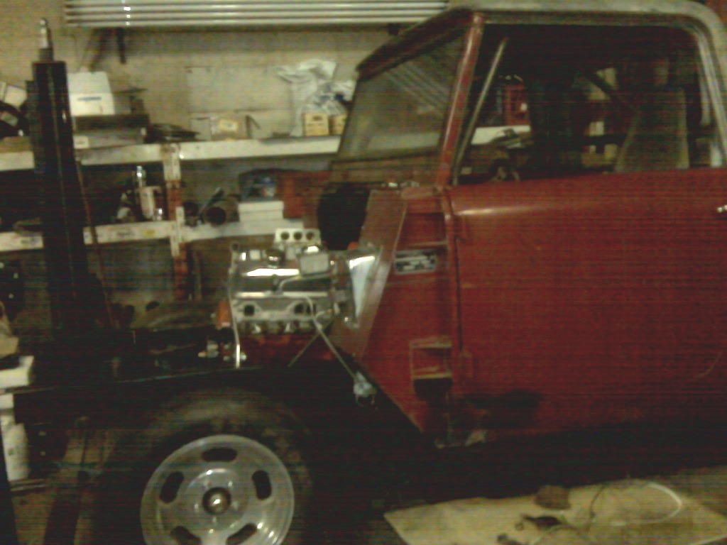

  20. Saxxon
    Joined: Dec 14, 2008
    Posts: 1,835
    Saxxon
    My cool new Corvette compe***ion headers from ****** are in but the header to oil pan clearance issues have been realized. The bargain circle track pan is only a bargain if the headers fit, which they don't so it isn't. I ordered in a new Milodon pan which will allow me to use the new tubes. It will also allow me to use a midplate once again so I brought a new one of those in as well. It will be a tidy and tight little package when it all goes in. Besides, the gold anodized deep sump pan looks cool and is dated enough to look period correct. Especially with the Milodon decals on the sides.
    Header problem #2. Yet another fear realized, they don't clear my steering. Time to order in another u-joint and put a bend in it. There is plenty of space to do so and it should be an easy fix. Just hurts spending another $80 on a u-joint.
    My original plan to use a Locar throttle pedal went sour as well. It installed very well but there isn't enough travel in it to open the ****erflies fully. Besdies that, the cable stay bracket bends like crazy. I was not at all impressed with it so out it comes. After searching for an alternative that will work with the modified firewall and engine setback, I went with a fabricated bracket and pedal with a cable activation. Took a few hours to put together but it went well and works great.
    Still looking to tackle my windows but the priority right now is to change the pan and re-install the midplate, install the headers w evac system and down tubes as well as make the required changes to the steering. The windows and roof work can wait as I can always run it without a roof for the shake down p***es.
    I'll report as S&*! happens
    Cheers
    els likes this.

    I'd like to make a suggestion on your hoses if you don't mind. A trick I've used on diesel generator sets that have hoses with oddball curves, different pipe sizes etc is to use two short pieces of straight hose at either end and make a pattern with a coat hanger for a solid pipe to connect the two. A good muffler shop can make this and one with a bead roller can roll "lips" at the ends to help hold the clamps on. If a bracket is needed it can be welded on at the appropriate spot. I've used this trick many times and never had a problem. You can paint or chrome the pipe if you want. Just a thought.
    Saxxon and els like this.

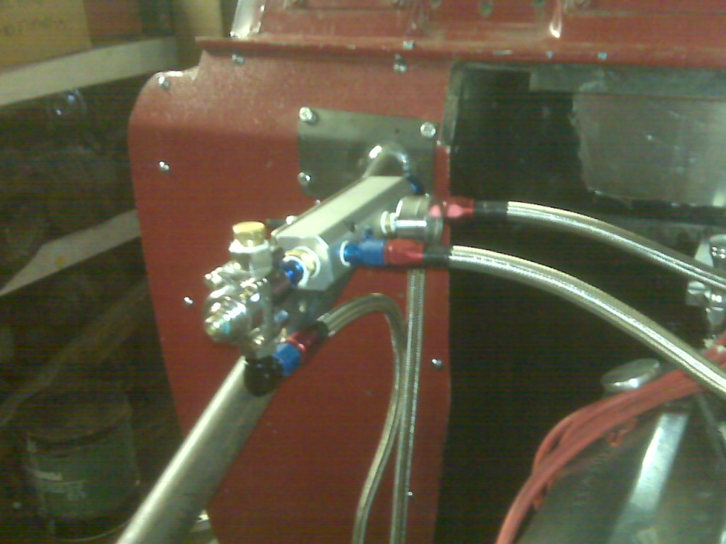

    Saxxon
    Ok... at the risk of getting killed because I don't have any video, I have to tell y'all the truck was fired up for the first time since the dyno runs and I'm proud to say, it sounded seriously bad-*** !!!
    Why no video? - Well, it wasn't for a lack of intent.
    We banged on the truck all day and managed to fabricate some front frame braces as well as finish the fuel system. The frame braces are simply bolted in and really are not structural (yet) but they look great and solve my fuel block mounting issue. Once we finished mounting the fuel block and fabricating the braided lines, we flushed the system and pressure tested the whole shibang. It was fun to watch 3 guys ducking and diving under the hoist tightening fittings, but in about 30 seconds we had all the drips stopped and the fuel pressure set at 8 lbs. Same fire drill for the transmission and cooling system. However, to get the transmission filled properly, you have to have it running... right ??
    Knowing we had to fire it up we put the rear up on jack stands and gave a 30 minute warning to anyone who wanted to be there for the historic event. To our surpise we ended up with 8 guys watching and no less than 3 camera phones and a 1 video camera waiting to capture the moment for posterity. As much as I would love to say it fire first pull... it didn't. (DOH !!!) It turned over great but never fired. Nothing, Nada, Zip, Ziltch. After 30 minutes of troubleshooting we lost our audience and everyone went home. With them went the video camera. :confused:
    Another 30 minutes, a coil swap, a spark test, MSD test and a few other ***orted tests later, we found a broken connection to the distributor strategically hidden in the darkness behind the engine. After a quick fix we tried again and it fired almost immediately.
    My god it sounded good!!! It was down right violent. We winged the throttle a couple of times and it sounded crisp and anxious to scream a lot louder. Makes me wonder what it would be like with a serious motor in it. (When was I planning to put in that roller cam ???)
    But... we had no-one to hold a recording device, so you guys will have to wait until after the long weekend. Hopefully by then I'll have the steering mods finished and I can actually drive the beast a bit and do some initial testing of the transmission and brakes. Possibly even an ill advised traction test in the parking lot. (Wink wink nudge nudge... :D)

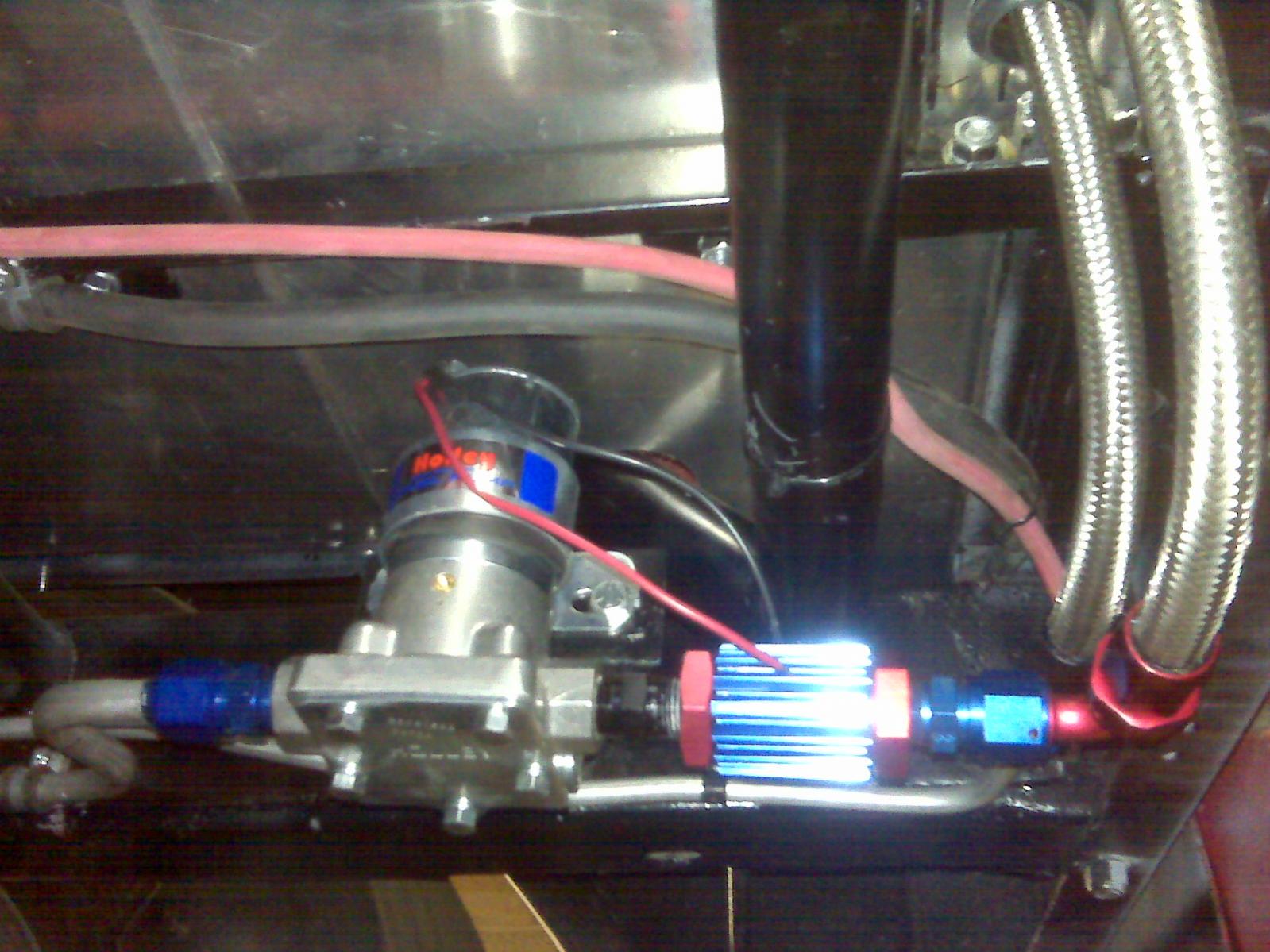

    Until then, you'll just have to make do with a couple of random shots of the fuel system. (Yah I know... ****s)
    Until then, have great long weekend kids !! Play safe !!
    More as it happens
    els likes this.

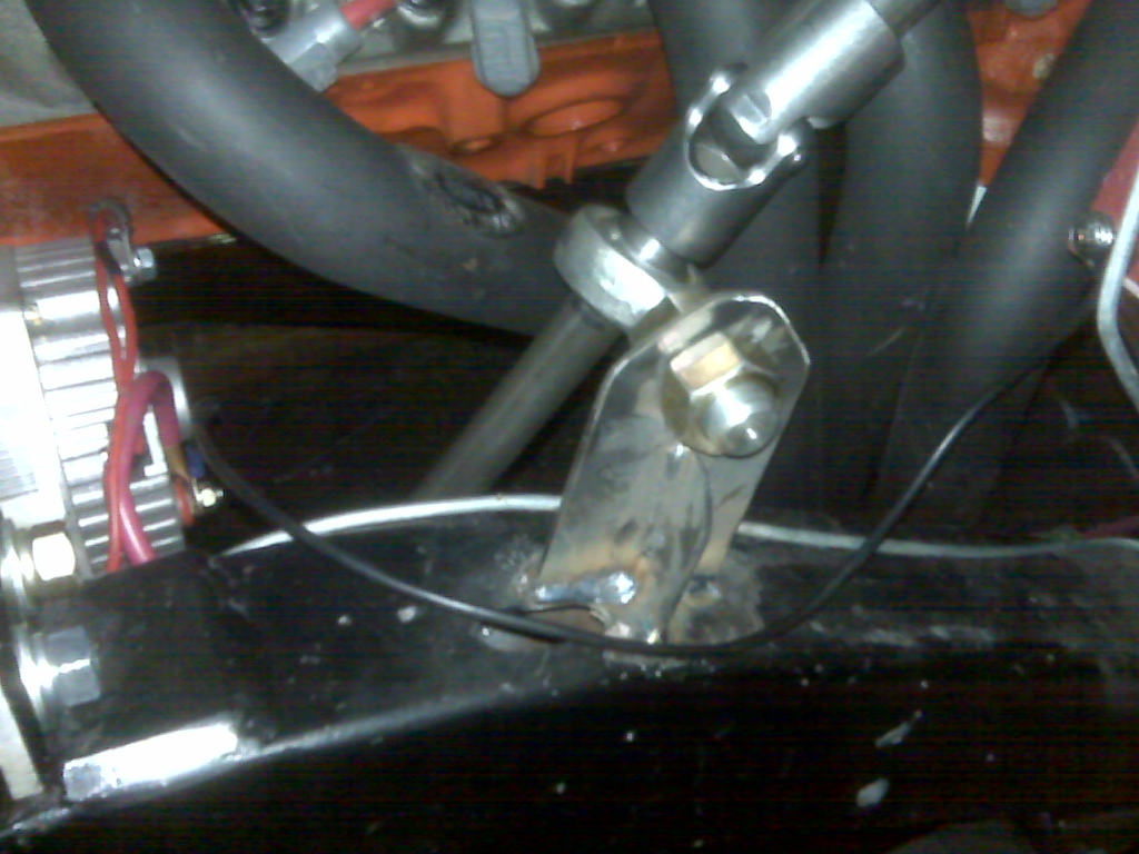

    Here's the steering modification we had to do to clear the headers. I know it doen't look like much, especially to some of you fabrication Gods out there, but I'm pretty happy with it.
    In an odd sort of way the new set up is actually better than the straight one piece design it is replacing. The u-joints at the top and bottom are much straighter and the Moroso unit I put in the middle has a good range of motion. It's actually smoother and provides more room beside the engine.

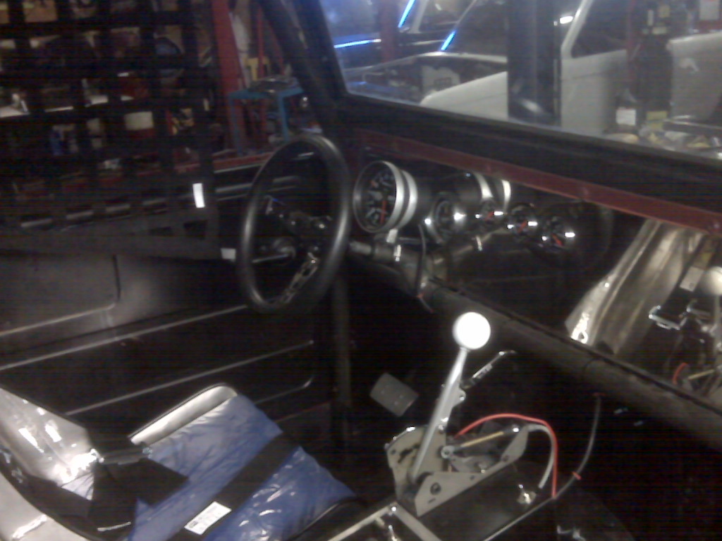

    I’m on the short path to having a functioning, albeit, still ugly race car, and the list of things to do is tantalizingly short. And yet so long… oh the irony
    My safety stuff came in and we spent a few hours installing the belts, modifying the seat and reinforcing the mounting points. We also tackled the crankcase evac system and fix a few loose ends that have been bugging me. Overall it’s been a productive week. Unfortunately what’s left to do require TIG welding skills and if you’ve read this thread you would know that my welding skills ****.
    I can stick 2 pieces of metal together but when it comes to stuff that may save my short fat middle aged *** I let the experts handle the welding rod. So to make sure it was done right I asked a certified welder friend to weld up my steering, finish putting in my window net mounts and weld in my side bar for the roll cage. Since I do that work thing during the day and have some form of a non automotive life outside of this project, I haven’t had time to be at the shop as often as I would like, so I haven’t had the chance to push the request. As a result, it’s still not done ! Now he’s telling me he won’t have time to do it this week. That pretty much puts a nail in the coffin for any chance to get the Scout out to the track this weekend (That really ****s)
    It’s not a total loss as there is still one race date left for the year (Oct 2/3) and I am determined to have the Scout make an appearance and make a few shake down runs before I put it back in it’s corner for the long cold Winnipeg winter. There is no valid reason to set or even meet this deadline other than the satisfaction of seeing it run and sense of accomplishment. It would have been nice to identify the bugs in the parking lot this week and sort it out at the track this weekend then wail on it big time at the season ender. I’m guessing the bumper s****ing wheel stand will have to wait until 2011
    Sorry for the rant
    I feel better now
    I’ll have pictures from the track and hopefully video of the first serious burnout. Maybe if the G***er Gods smile on me I’ll make a full p***
    Update and bit of crow to be consumed.
    My welding guy came through big time and gave me his undivided attention. (I'm guessing he reads this thread) It appears I owe him an apology... sort of. I was still hoping the jobs would have been done 3 days ago. But for now I'll accept the ol better late than never at***ude.
    The steering is done, window net set up and ready for final welding. If I made a big effort for the next 2 days I could probably get the truck to the track but to be honest I really don't have the time. (Stupid real job, Stupid real life...)
    I'm just happy as hell the truck will actually go where it's being pointed. (I hope)

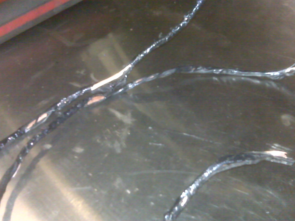

    Anyone out there ever see the do***entary where a bunch of aircraft nuts spend 3 years and a barrel of money restoring a WWII B-29 only to watch it burn to the ground when they tried to taxi it for the first time?
    I came oh-so close to doing the same thing tonight. It was not a pleasant experience.
    I came into the shop to find a couple of my friends doing some body work filling in the gaping holes in the back of the cab and the holes I cut in the roof for the back bars. Lots going on. All was going well and a few other friends wandered in so towards the end of the evening we fired up the truck to show off a bit. About 15 seconds into the session the cab filled with smoke, then almost like an old gun powder fuse we saw the burn make it's way from the cab to the back. I immediately hit the kill switch and my brother jumped on the master switch at the back but the damage was done.
    The culprit was an extra power wire that Scott (Who did the wiring) strung to the cab and then changed his plan for using it. This was not Scott's fault as the extra power wire was tucked safely under the switch panel and should never have been an issue. Sometime during my work in the cab and the body work today it was accidently pulled out and the protective cap came off. When we fired up the truck it arched against the floor boards. I'm one of those neat freaks that likes to bundle and wire-tie everything into nice little packages. So when the wire melted along it's entire length it took a bunch of wiring with it.
    From the gl*** half full philosophy of though... No one got hurt, the shop is still standing, the damage can be repaired and it didn't happen in front of a couple of hundred folks at the track. I'll be digging into the wiring harness and checking for burn throughs. I'll pull and replace as much as I need to until I'm sure it's all safe.
    One step back tonight but it's been three steps forward in the past week. I'm still moving in the right direction. Oct 2/3 is still in my sights for the truck's debut and shakedown p***es
