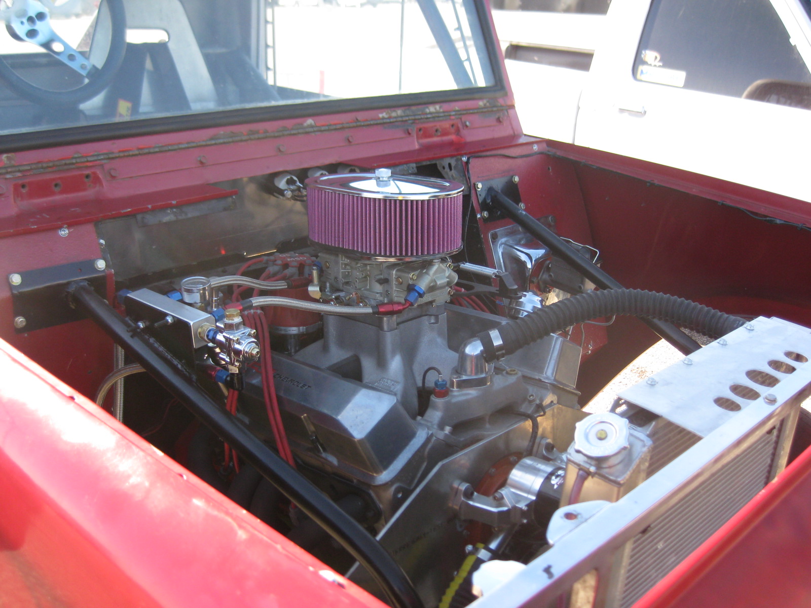

    The thrash is on to get the scout to the track for the weekend.

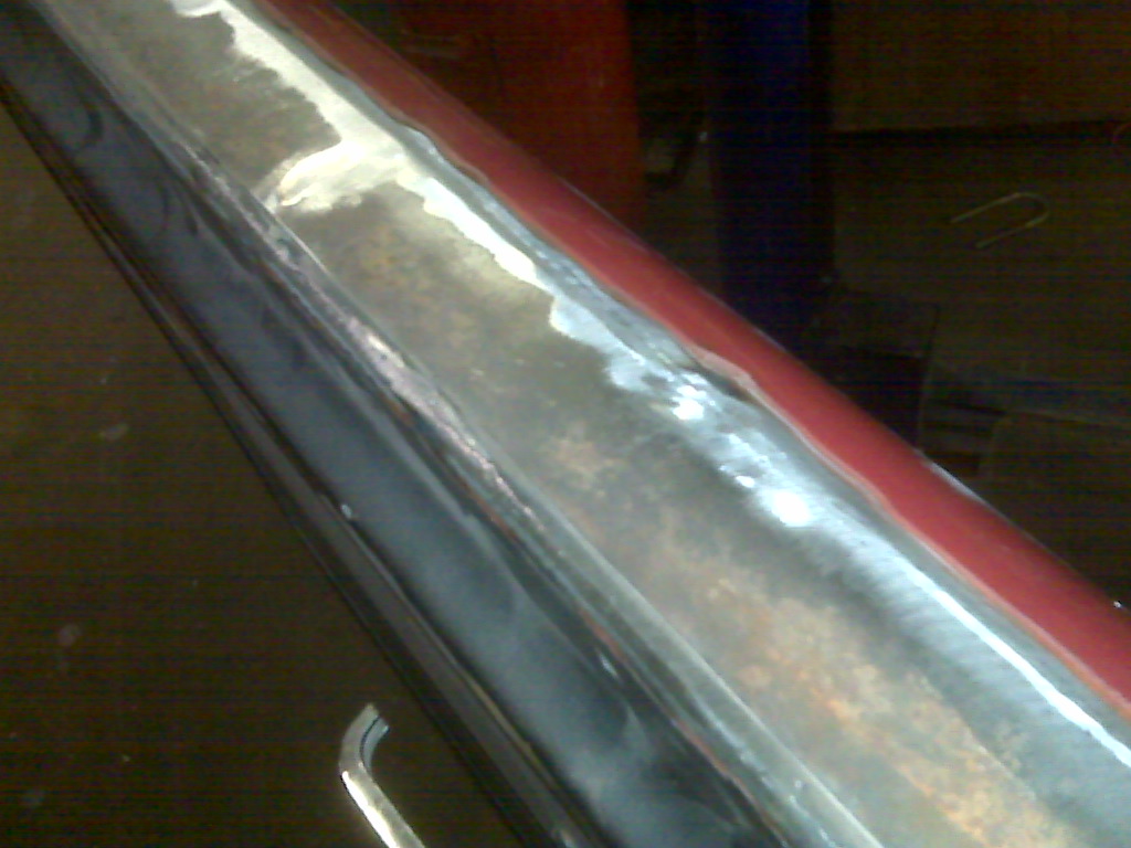

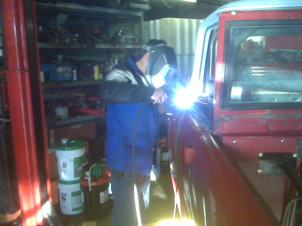

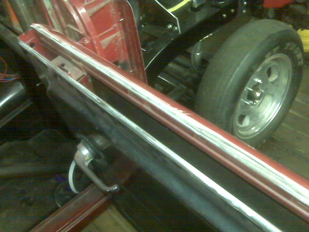

    The last big task to get done was the fabrication and installation of the windows. To start, we ordered in a Compe***ion Engineering kit. It comes with a hockey sock full of tabs, bolts and lock nuts as well as the required tubing and a crude but effective tubing bender.
    After we bolted on the roof I added some Home Depot 1/2 inch weather stripping along the window jambs for the windows to seal against. We measured it all up, bent the tubing and then welded on the tabs. Pretty simple to this point and i have to say my fabrication and welding skills are getting better. They still **** by most of your standards but still... getting better.
    To mount the window frame we filled in the top of the door jamb. It was a ton of welding and grinding but in my opinion it was the best way to mount the frames. This had the added benefit of stiffening up the door substantially. Another bonus is sealing the doors from the elements. Prior to the build I pulled 30 years of the great outdoors out of the bottom of the doors. Including at least 2 generations of critters.
    The doors never had a window frame to start so there are no recesses for the bottom of the window to drop into. So after filling the top of the door, we added a strip of 10 gauge metal along the bottom for the windows to bolt on to.
    We ordered in a sheet of 1/8 inch Lexan and using a template we made from the packing material, cut out the side and back windows. A little drilling and lot of bolts later we had a slick set of Lexan windows mounted and ready to go. Lexan scratches just by looking at it so I took a picture while they are still clear. It might be the only time they are like that.
    On Monday we drove the truck off of the drive-on hoist. This was a fairly momentus occ***ion as it is the first time this thing has moved under it's own power since the build and likely the first time in 25+ years.
    In between window build sessions we started to dry test the truck in the parking lot. The first time we did it we did a couple of slow laps but the brakes didn't feel good at all. Then the transmission puked fluid out of the convertor seal - big time. We got the truck back on a hoist and I pulled the transmission. It turns out the convertor bearing walked and took the seal with it. A quick fix was made and the transmission reinstalled. The second drive session the brakes still felt like ****. Right at the end of the session I stepped hard on the brakes to see if that made a difference and the rod from the brake pedal to the master cylinder folded like a cheap suit. It turns out, one of the shop guys fabricated me some brake lights and the bracket he welded onto the brake pedal to trip the switch was hitting the rod. This gave a false sence of firmness while at the same time preventing the brakes from fully engaging and putting lateral force on the rod. Luckily the rod could be fixed and once I cut out the offending bracket the brakes worked great. So much so that I'll need to add a proportioning valve so I can adjust the brakes. Right now the truck really wants to lock up the fronts. Not something I want to happen at 120 mph.
    When I tried to test the line Loc I quickly found out the brand new Line Loc was faulty (no click as the solenoid engaged) so we replaced it. In fairness the Line Loc we had in it was a showy Pro Street unit. The new one is a Biondo racing unit. Less flashy but far more robust. After the swap the Line Loc worked great but the truck was pushing the front wheels with ease so smoking in the parking lot was out of the question. (probably a good thing) This is actually a good sign as it means it's got some serious traction even in a dusty paved parking lot full of loose gravel.
    At this point I'm actually pretty positive about what's happening. I would rather have these issues and failures in the lot 100 ft from the shop instead of at the track. The last thing i want to do is oil down the track, not to mention looking like an idiot in front of a few dozen people. Actually i'm used to looking like an idiot in public but I would rather it not be at the track with a broken race car.
    Once the windows were finished we took it out again. This time everything worked well. We noticed the truck was leaning to the p***enger side so we made a few preload adjustments to the suspension which leveled out the stance and then we called it a night. Tomorrow I get to weld in the driver side bar and finish installing the window net. Then I'm going to load it all up cuz folks, it's ready for some shakedown p***es. Ugly as hell, but ready.

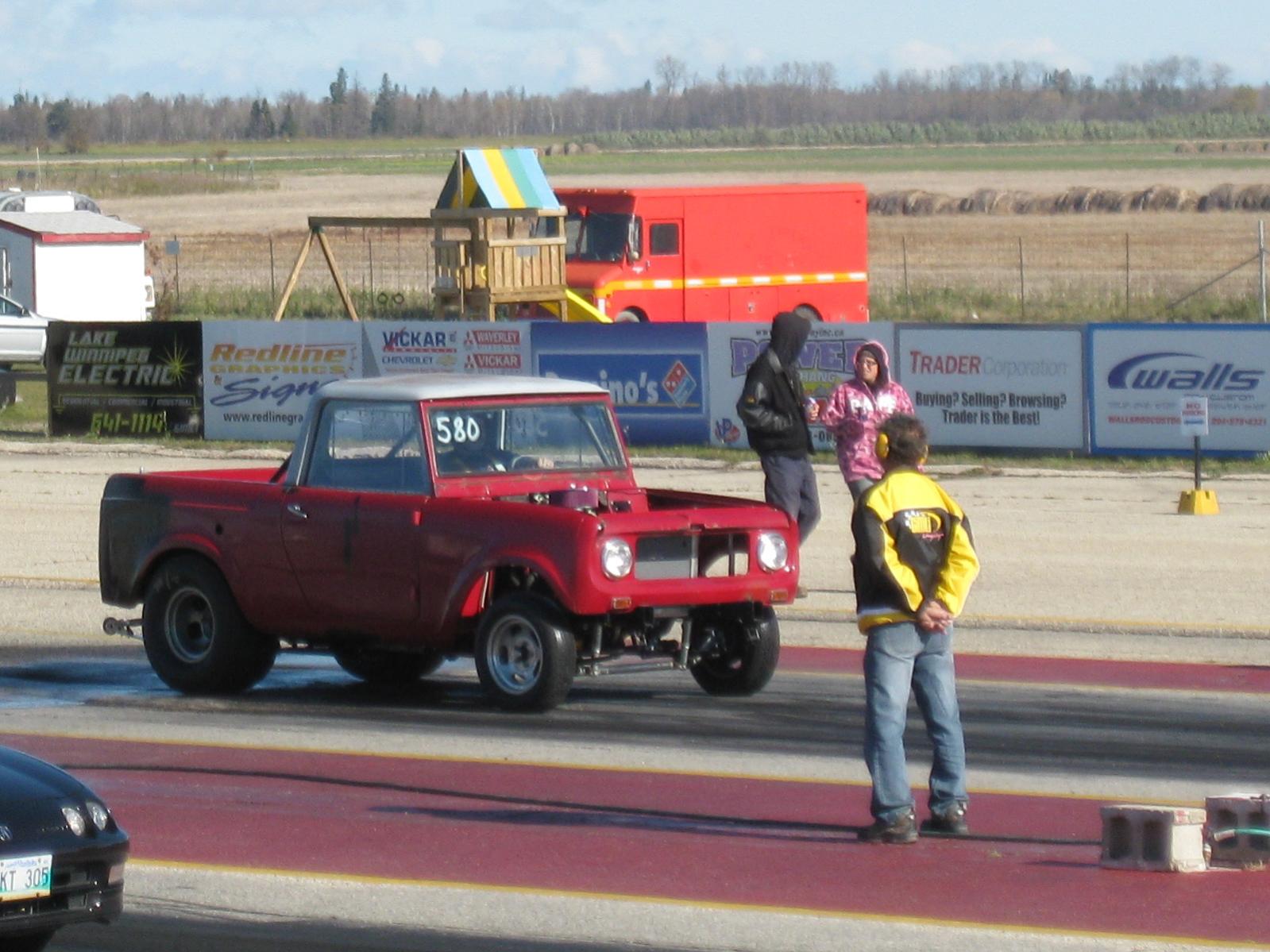

    The Scout is Out !!
    It's return to the strip for the first time in over 30 years was a resounding success.
    More than I could have hoped. But it wasn't without some drama

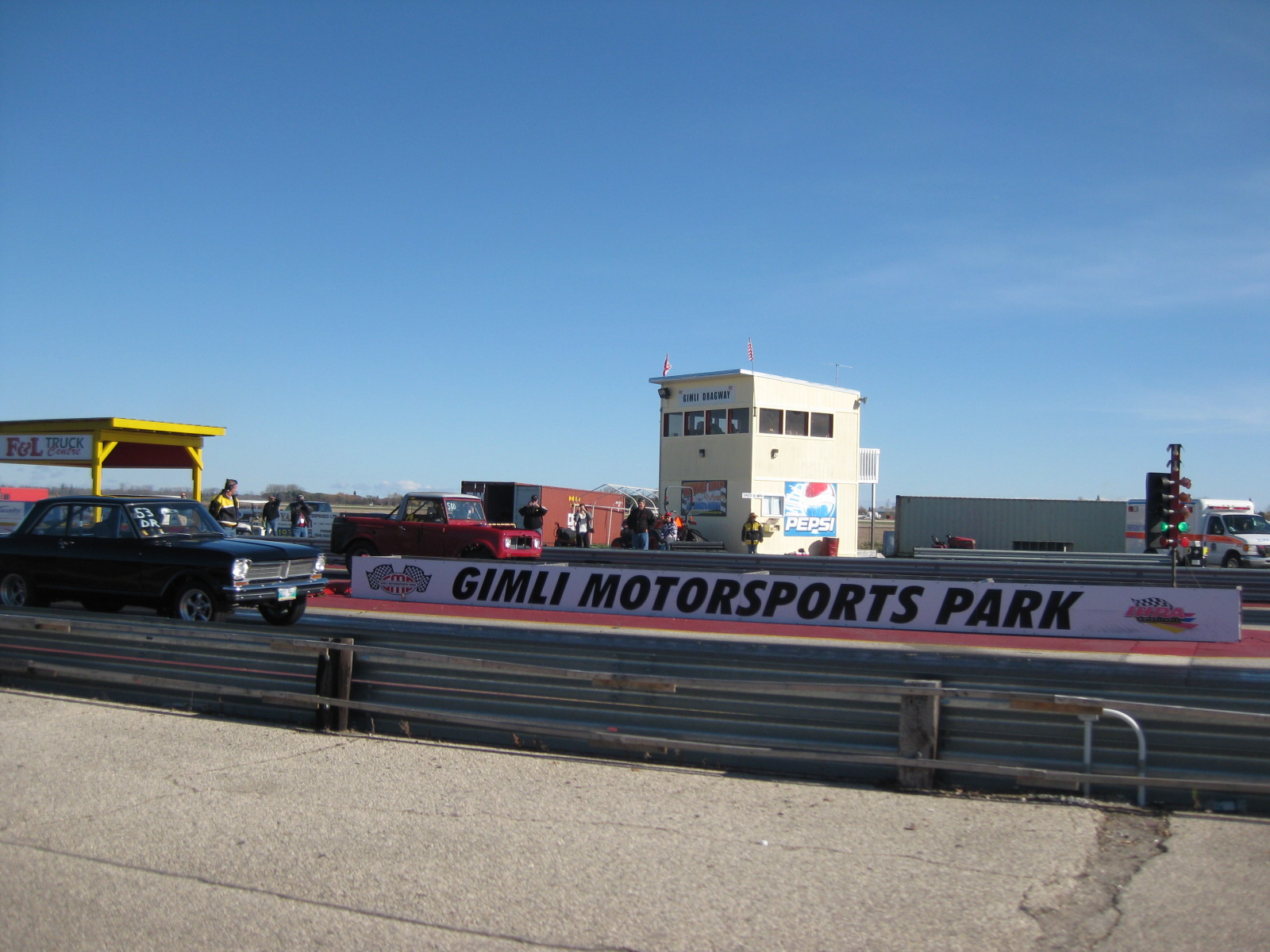

    The Pelissier Family / Pro Gear racing operation loaded up and headed out to the last racing weekend of the year at Gimli Dragway. This included my Scout, my brother's 11 second Ranger truck and my Niece with her 7.90 jr. Dragster. I had a half dozen friends in tow to see the Scout make its first p***es.
    Saturday it p***ed tech fairly easy but there was some question about the legality of the chromed front axle but they let me run anyway. The tech guys were really happy with the attention to detail and that I had more SFI stuff than I really needed. This went a long way towards letting me run.
    Warming up in the pits:
    The first 2 p***es were very soft and timid as I had no idea how the truck would drive at speed. There were no issues and I was actually surprised how well it tracked. I hot lapped it and idled in the staging lanes at least 5 minutes between p***es. The temp locked in at 150 and stayed there. The next few p***es would be progressively harder depending on how it reacted and how much testicular for***ude I had. I avoided the temptation to hook up the trans brake. I knew if it was there I would use it. Probably with disastrous results.
    P*** #3:
    I foot braked it hard, dragging the front wheels through the lights. I stayed in it to the 8th, coasted a bit then got back on it through the traps. The truck went 11.83 @102 mph (1.64 60 ft).
    What got my attention was the serious death wobble when I let off the gas. It was serious enough to almost sprain my wrists. (Holy **** !!) Even worse was the temp spiking at 220 (Double Holy ****!!!)
    I could fix the death wobble but the electric water pump had gacked and threatened to end my day at 11am. I sent a message to the pits through the tower but no-one on site could help out.
    I have to say that within 10 minutes of the announcement there were guys at the trailer on their cell phone searching for a water pump for me and there was a pile of ideas about mechanical pumps, spacers, belts, remote drives and pulleys being thrown around in an attempt to get me a working set up. It was heartwarming to see the response... but it was all in vain...
    At the same time I made an adjustment to reduce the tow-in on the front end.
    At 3:00 I decided to make a 4th p*** with a friend golf carting me to the line and picking me up at the far end.
    P*** #4:
    My brother is in the other lane with his Ranger. 1 hour earlier he had just made a 11.68 p*** to take the Pelissier family fast time ***le away from me and my previous (boring) Vega.
    Once again I foot brake and got a good launch but did not push the front out of the lights. I lifted the left front about 2 inches and carried it past the tree. I stay in it and somehow manage to hammer the rev limiter on both shifts and run an 11.63 @ 112 (1.55 60 ft)
    I'm happy to discover that the death wobble has disappeared but the best part of it all is that the 11.63 gets me the Family - Fast Time - ***le back.
    My extraordinary ability to screw up the shifts in an automatic has me baffled. It's as if I simply forget to shift and when I do I am tentatively trying to put it in gear rather than pulling hard on the shifter. You can hear me on the limiter in the video.
    The temp at the end of the run is once again 220. Without a water pump I'm done for the weekend. Saturday night I find a water pump on Kijiji and make a new friend in the seller. (I have a thread on this elsewhere).
    11.63 p***: (My Brother Paul is in the other lane)
    Take note of the track announcer in the video. That's Rich Bedford, the 2nd owner of the Scout back in the 70's having purchased it from the original builder Jim Pratt. He had a lot of cool things to say about it all weekend. Too bad I was in the truck each time and heard none of it.
    Tow back to the pits: (Thanks larry)

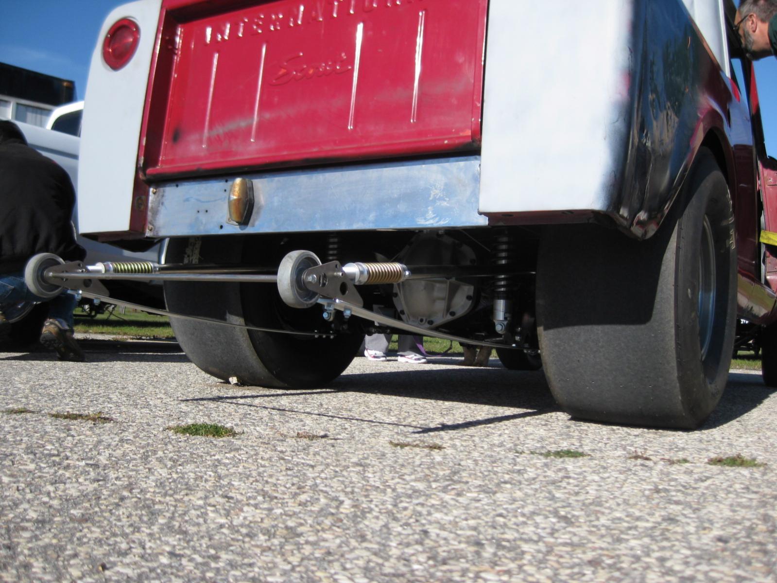

    P*** #6 - The 1st Big Wheelstand !!
    I forget to clear out the motor and it bogs off the line - then catches - and hangs the front end 3 feet in the air for about 50 ft. (Holy **** !!) With the bog screwing up the run I shut it down after I pull the second shift.
    The truck went up flat and hammered the wheelie bars hard. It tracked straight and came down with absolutely no issues and straight as an arrow. It was almost boring (Almost :))
