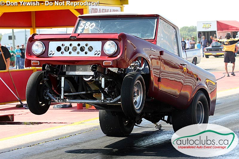

    Trans brake launch from 4000 rpm puts the front end 2 feet in the air and it makes an immediate right turn with the wheels in the air. (Video below) Scott bails out and gets it straight. Once back into the throttle the Scout goes into extreme death wobble. The toe-in is all wrong with the new tie rod and ends. 30 minutes to adjust the front end and to reset the preload on the ladder bars and we`re back in the staging lanes.

    The wheel stand was a direct result of launching off of the trans brake. All the other launches in the video are from an idle.
    Damage report:
    The left front spring has collapsed / flattened out. This has allowed the spring to hit the back side of the articulating shaft that runs through the steering box and has put a pronounced bend in it. We have also found a crack in the steering box housing. As stated, the steering travel is limited on the Scout so the bend does not come into play. Just to be safe I`ll order in a new box along with some new stiffer springs. I`ll also put in an extra inch or two of lift and try to mount the box a bit higher. Bump stops are also the order of the day.
    Then we will play a bit more and make adjustments on the suspension. We want it to move forward off the trans brake rather than straight up.

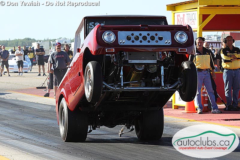

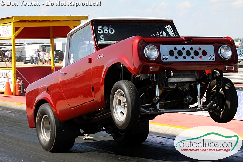

    Some more wheels up action. Not as dramatic as the first spring crushing effort (Thank God) and not quite up to the Rebel Reaper standards but still enough for a decent photo op.
    We had the wheelie bars set low, just to be on the safe side. This is a 4000 rpm launch off the trans brake. Still have some suspension to sort out but it`s close. This p*** was an 11.23 with a 1.50 60 ft.

    We have been preloading the suspension and this was tweaking the diff out of true giving us a seriously unwanted rear steer scenario. While at the track we dropped the entire rear ***embly and adjusted the rod ends on the ladder bars. Lots of work but well worth it. The air this day was horrible (5400 elev) but the Scout ripped off 4 consecutive runs between 11.24 - 11.27. During these runs we were softening the shock settings one click at a time. On our 5th run the Scout suddenly responded with an 11.20 so that's what we dialed in at. Go figure the Scout tears off an 11.16 for yet another 1st round break out loss. A test p*** an hour later with no changes was an 11.26 (??) To say I'm a bit confused is an understatement. The Scout was never supposed to be a bracket car but I would sure like to be able to predict what is going to happen.

    Sa**on how much extension is left in the rear shocks above ride height, if you slow motion the 5-31 video you can see the wheelie bars slap the track hard than bounce back.
    els likes this.

    3 inches on a moderate stiffness shock setting. This is not a good video to try and ***ess the suspension as we had to get out of it a bit otherwise we would have been in the Trans Am's driver's door.
    When it all works right the landing is a small bounce and then straight ahead. The wheelie bars do little else once they unload on the re-entry. But it's REALLY early in the sorting out period. All we've messed with to this point is to set the pre-load, fiddle with shock rates and ensure wheelie bar height is level on every p***. We haven't even messed with engine tuning at all.
    I'm open to any and all advice from those who know more than I do. Which is likely most of you. So please let me know what you are seeing and what you think is the solution. I simply reserve the right to decide what advice to follow and what not.
