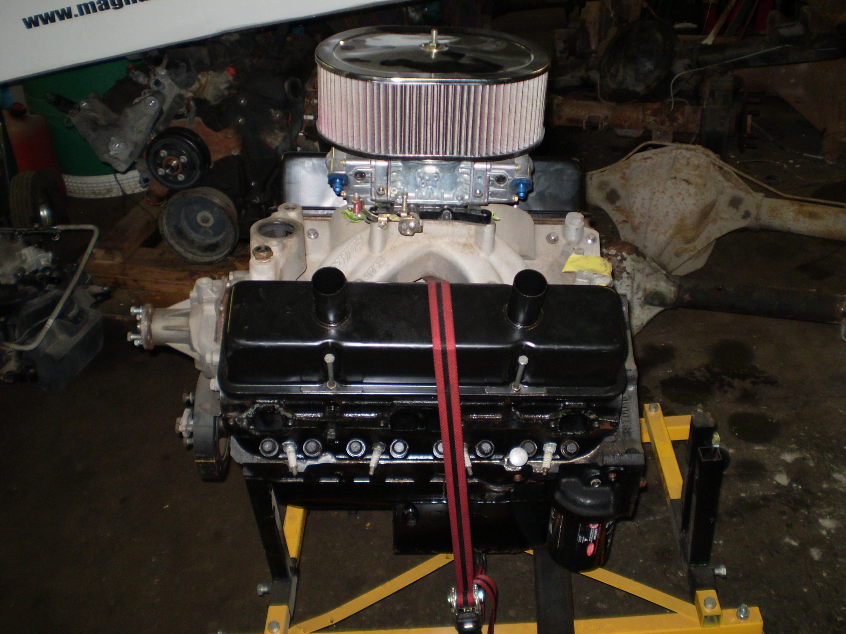

    Injured 377 out
    Healthy 358 going in
    This swap gave me a chance to clean up the wiring and paint the mid plate.
    If all goes well we should have the new bullet fired up this week.
    The 358 is a nasty little motor with 12.5 comp, Iron Eagle heads and a Victor Jr intake. There is a stout roller cam with full roller valve train and a rev kit. It made 505 hp @ 6200 and 460 tq @ 5600 on methanol. It makes 400+ tq from 3000 - 6200. I don't have an alchy carb, so we`ll be running gas and my 850 Pro Systems carb. The limiting factor obviously are the heads which kind of makes me want to swap my Brodix heads and Intake and make some big power. But we won`t. We`ll throw a .630 roller cam into the 377 for next summer and keep this little bullet for the 49 Prefect project.

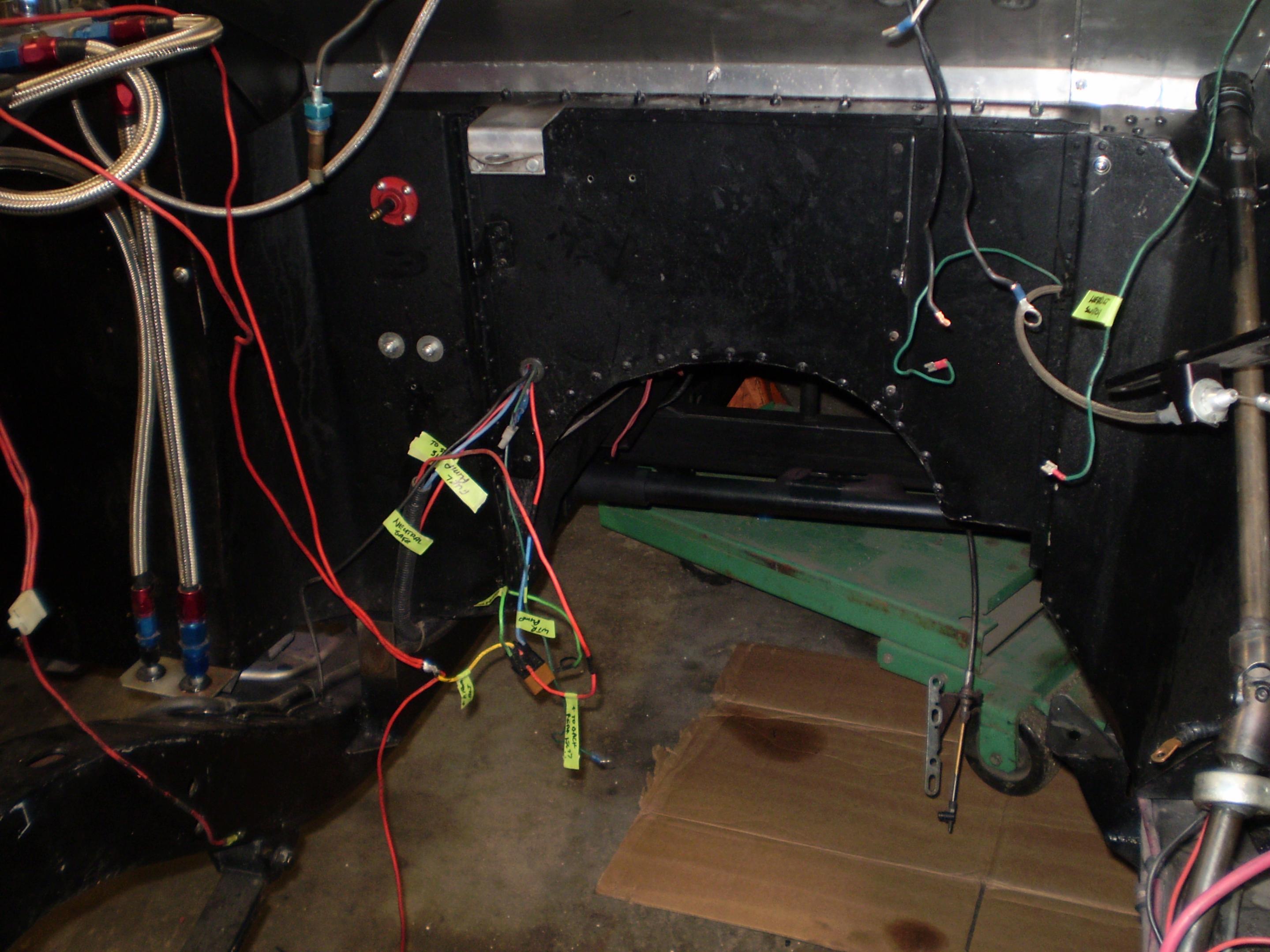

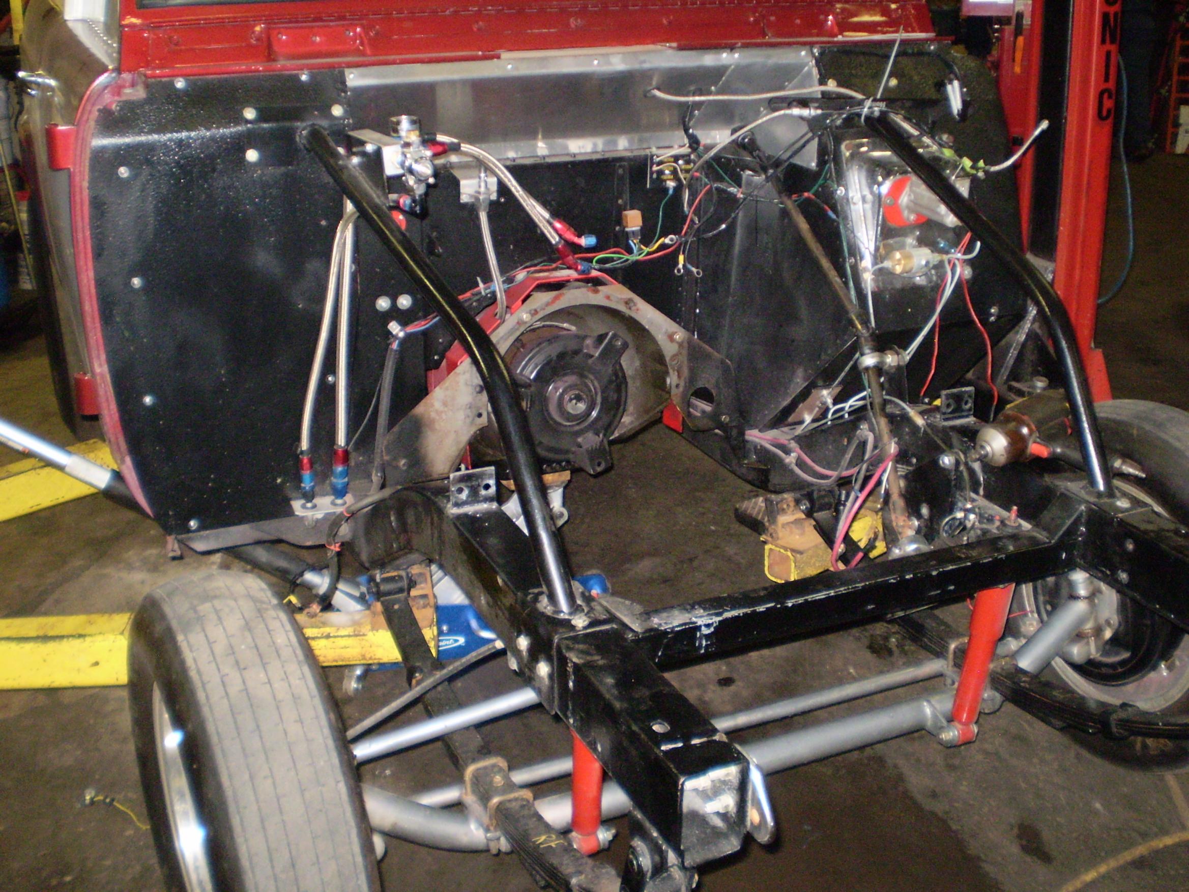

    We pulled the T-400 this week and went through it. Internally it was prestine. Clutches look almost new and there was no indication of shock damage from the trans brake. However, one of the converter bolts had loosened off (Fine thread bolts w crimp nuts and lock tight no less !!) which caused the convertor to wobble. This explains my ****** leak from mid season on that I couldn't get rid of. Easy fix. However the wobble started to wear a groove in the pump so we replaced it along with a new seal. Bolted it all back together and it's ready to go for the new season.
    When we first had the truck running in 2010 the wiring was decent but not great. I gave it a C+. With the addition of the headlights, 2 step and trans brake as well as some troubleshooting and reconfiguring the wiring went to hell. I had no less than 5 power wires running to my 1 wire alternator (??) So my next project, while the engine is out, is to fabricate up a proper wiring board and clean up the mess of wires at the firewall.
    Call these the "Before" pictures
    Keep in mind I have them hanging all over the place to map and mark them but you get the idea...
