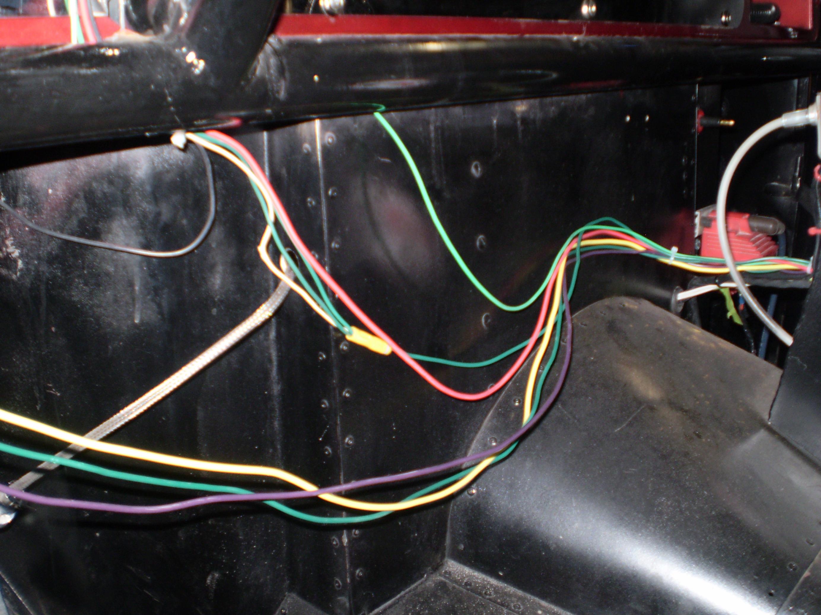

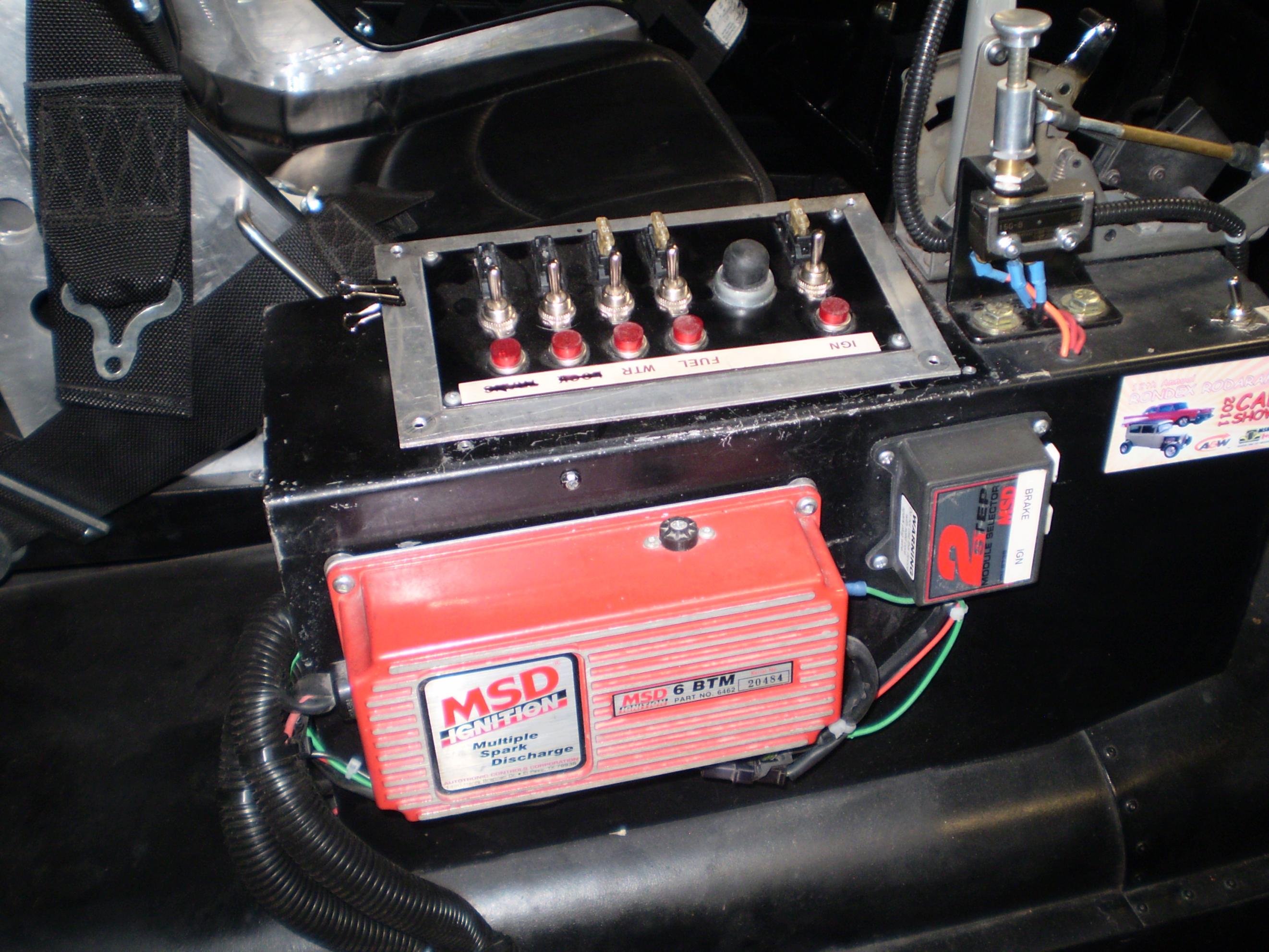

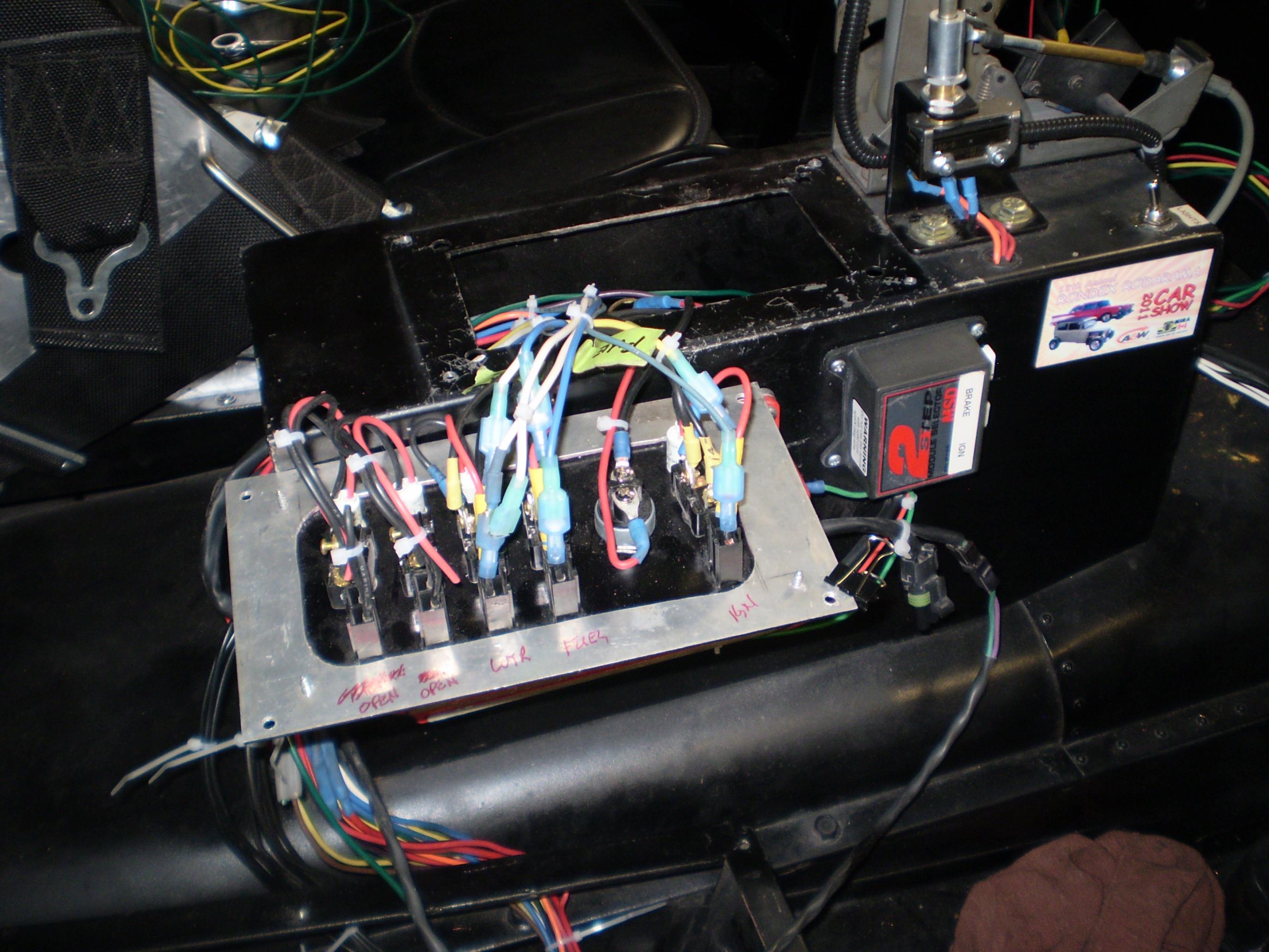

    If there is one thing this Scout has taught me is to not be afraid of things I know little about. So far that would be welding, fabricating and now electrical. You ask a few experts, do a LOT of research and then dive in head first. That being said, my electrical re-do is 95% done and I am very happy with the results.
    My brother had himself a good laugh as I put power to the board for the first time this past week and I had a friend standing close with a fire extinguisher... I'm proud to say that after a couple of hundred wire ties, a hundred or so feet of wire and a ton of terminal connections the board works and works great. The hardest part of the build was tracking down jumper strips for the terminal blocks. In the end I took 20 minutes and made them myself
    What you don't see is the underside of the truck. All the wiring has been tucked up out of harms way and covered. It all leads into the seat well where the p***enger seat should be and a metal plate bolted on top for protection. I'm considering using a tupperware box to contain the board and protect it from the elements.

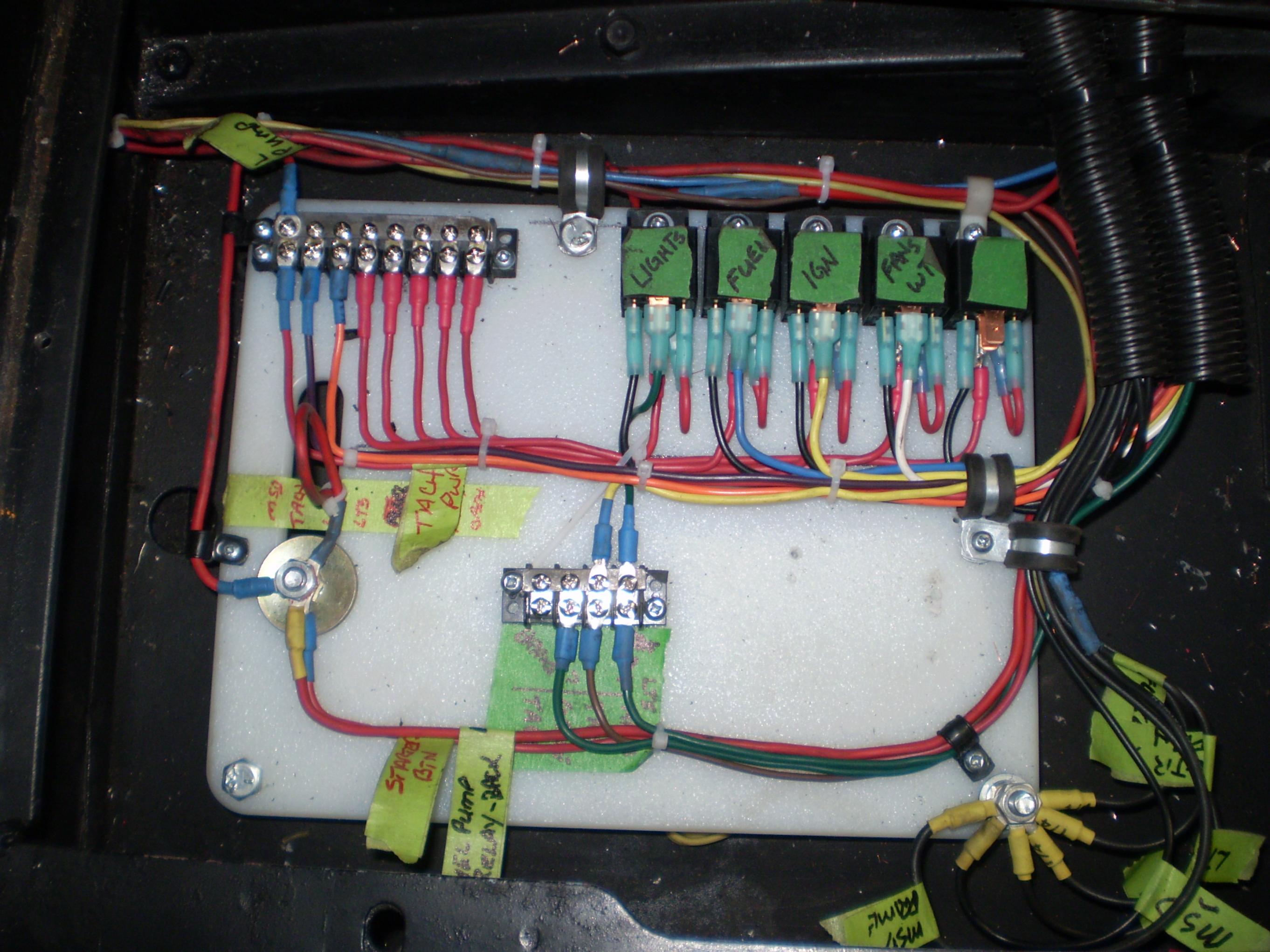

    I included a shot of the relay board before I cleaned it all up and took the time to properly mark the connections. (Sorry for the ugly green tape) Yes, by the way, that's a $3.99 cutting board being used as the base. Couldn't convince myself the Painless Wiring board was worth $39.99

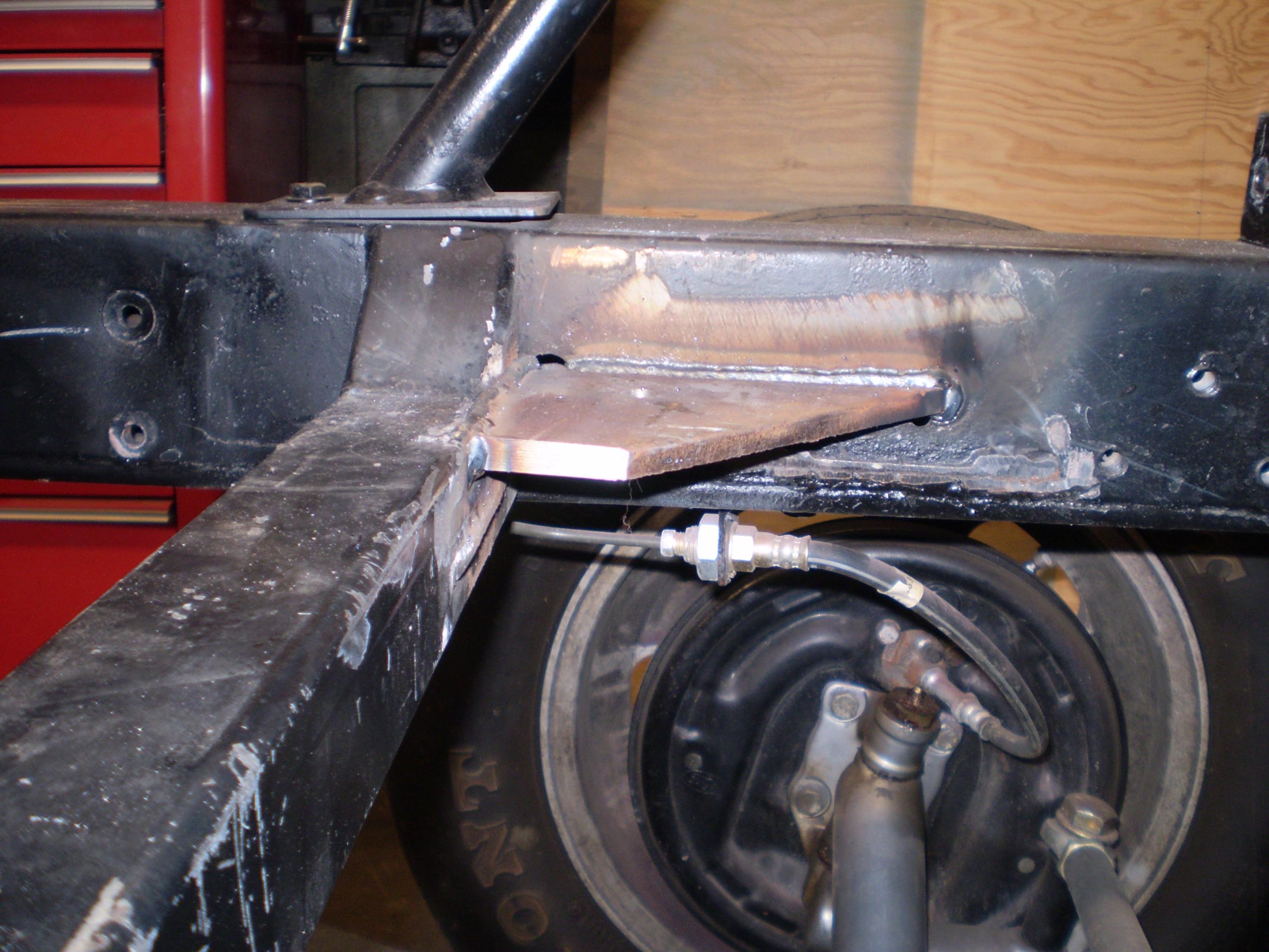

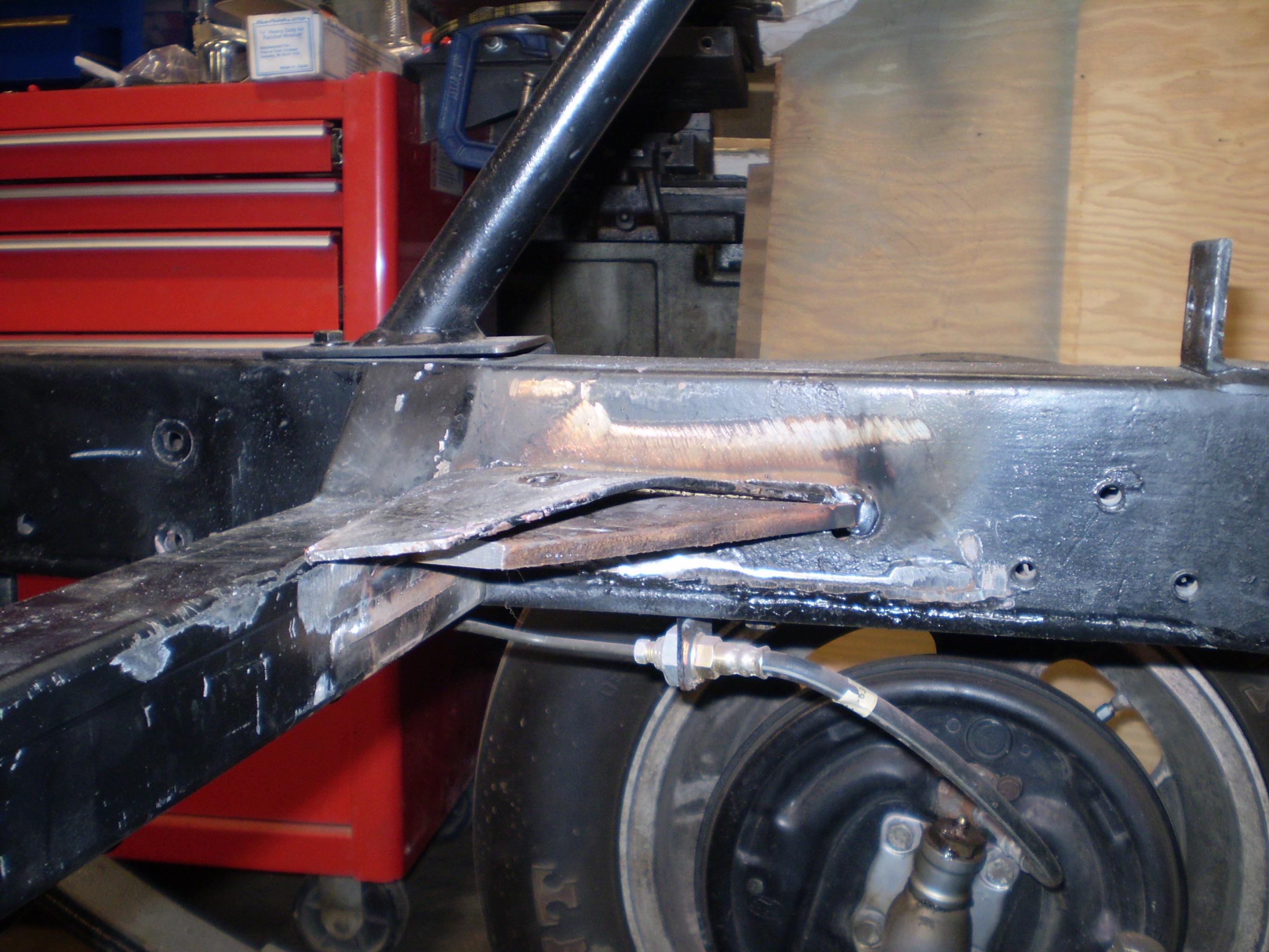

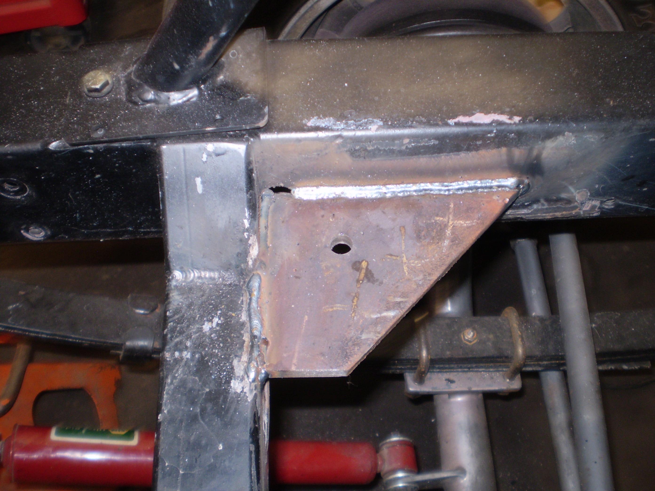

    With the front end stripped down we noticed that the upper shock mounts up front were bending badly from the wheelstands. I decided to replace them with stronger stuff. Luckily the previous tenants of the shop did some heavy metal work and left a lot of cut pieces behind. We found the perfect plates (left over from a battleship ???) and with some minor mods and some drilling / cutting / welding I have bigger stronger mounts.
    Next projects
    - adding a second tab to the front shock mounts at the axle
    - relocating the steering box
    - adding a brake proportioning valve
    - Clean up the brake lines at the line loc

    Do you think the shocks are bottoming out and that is what is bending the mount or was it just that the stiff shocks were over-whelming the mount? It is hard on the shocks when they take the full weight bottoming out on the way down. I am guessing you will now be transferring that energy somewhere else if they are indeed bottoming out. Possibly into the shock body or lower mount. You may want to think about frame snubbers above the axle if that is the case. I got mine from a local 4wd shop.
    If the mount was just too flimsy and the shocks are not bottoming out, ... then please ignore me.. :D

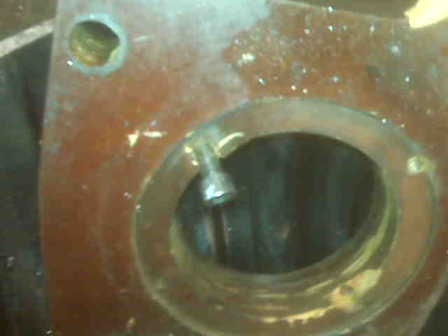

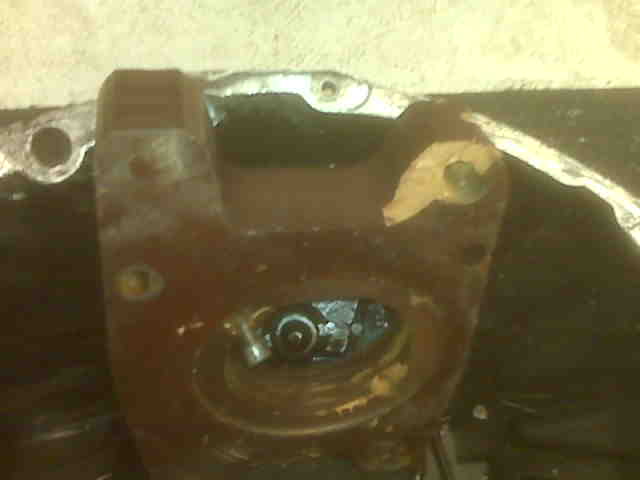

    We put the repaired and upgraded 377 bullet on the dyno tonight. And we broke the dyno... literally
    About 18 months ago we had the 377 on the dyno and with a stock 850 cfm carb and a mild solid lifter cam. (.538 / .308 dur) I reported that it made 509 Hp and 482 Tq. To be honest as much as I bragged about these numbers I have always been a bit skeptical of them. They seemed too high for the combination and the Scout's best performance of 11.01 / 118 equate to about 450 hp at the flywheel.
    Tonights dyno runs are on a different dyno. My engine guy, Len and the dyno guy, Daryll are also skeptical of the previous dyno results and very they believe based on comparative dyno results that the other dyno is at least 10% on the generous side. Based on this theory, the estimate of 450 hp and 440 Tq for the previous combination make sense.
    With the roller valve train and bigger cam (.630 / .308 dur) we made a best of 510 Hp / 475 Tq. I was actually disappointed with the max numbers but Len and Daryll seemed to be very impressed so what do I know (??) A gain of approx 60 Hp seems right for the cam and valvetrain change.
    What has me very excited is what the graphs are showing. The previous runs showed a peak HP at 6600 rpm and a very fast drop off. Tonight the horsepower was over 500 from 5200 - 7000 rpm and holding the peak output of 510 Hp from 6400 - 6600 rpm. The torque on the previous runs was the same story with peak Tq at 4200 rpm and a relatively fast drop. Tonight the Tq hit 470 at 4800 and stayed above that until 5400 with 400+ Tq from the start of the dyno run at 4400 right up to 6600. The graphs on this run are stupid flat. This means the Scout is going to pull stronger through the target rpm range (I'm stoked) Len and Daryll were really impressed.
    We seemed to have hit the combination bang on right from the start. We tried adding a 1" spacer and that actually lost power. We tried Q16 race fuel but I don't have enough compression to make it work. We were going to try a bigger carb but never got the chance since the dyno broke !!!
    On our last run the bolts connecting the dyno input pulled out of the bellhousing. The spacer between the dyno and the bellhousing was destroyed as was the bellhousing. There was minor damage to my crankshaft by the flywheel but nothing terrible. My engine guy will go through it more thoroughly just to be sure. Sorry folks, no video of the big bang as I maxed out my camera's memory prior.
    On a good note, I now know that my combination is working well (99.1% vol eff) and the jetting for the carb is bang on. The motor started and idled a LOT better than before. Overall I'm happy and satisfied but the first day at the track should really be the best way to tell if the upgrade made any major differences.

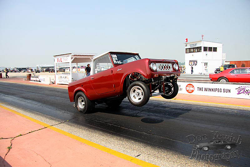

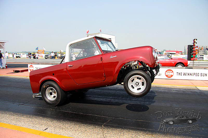

    Getting the bugs worked out for the Thunderjam show on the 14th and then the Meldown Drags...
    2 seperate p***es. (Look at the cars in the background... :) )
    The first was on a 11.09 p***.
    The wheelie bar bending moonshot (for me anyway) was a 10.89 in the 85+ heat. Walked this out past the 60 ft timers
    Actually I was just showing off the steering stabilizer we added this past week. I agonized about adding one all winter. (Not exactly period correct-ish) Now that I have one it is easily one of the best things i've done. Absolutely no sign of death wobble accelerating or stopping and the handling has become far more stable.

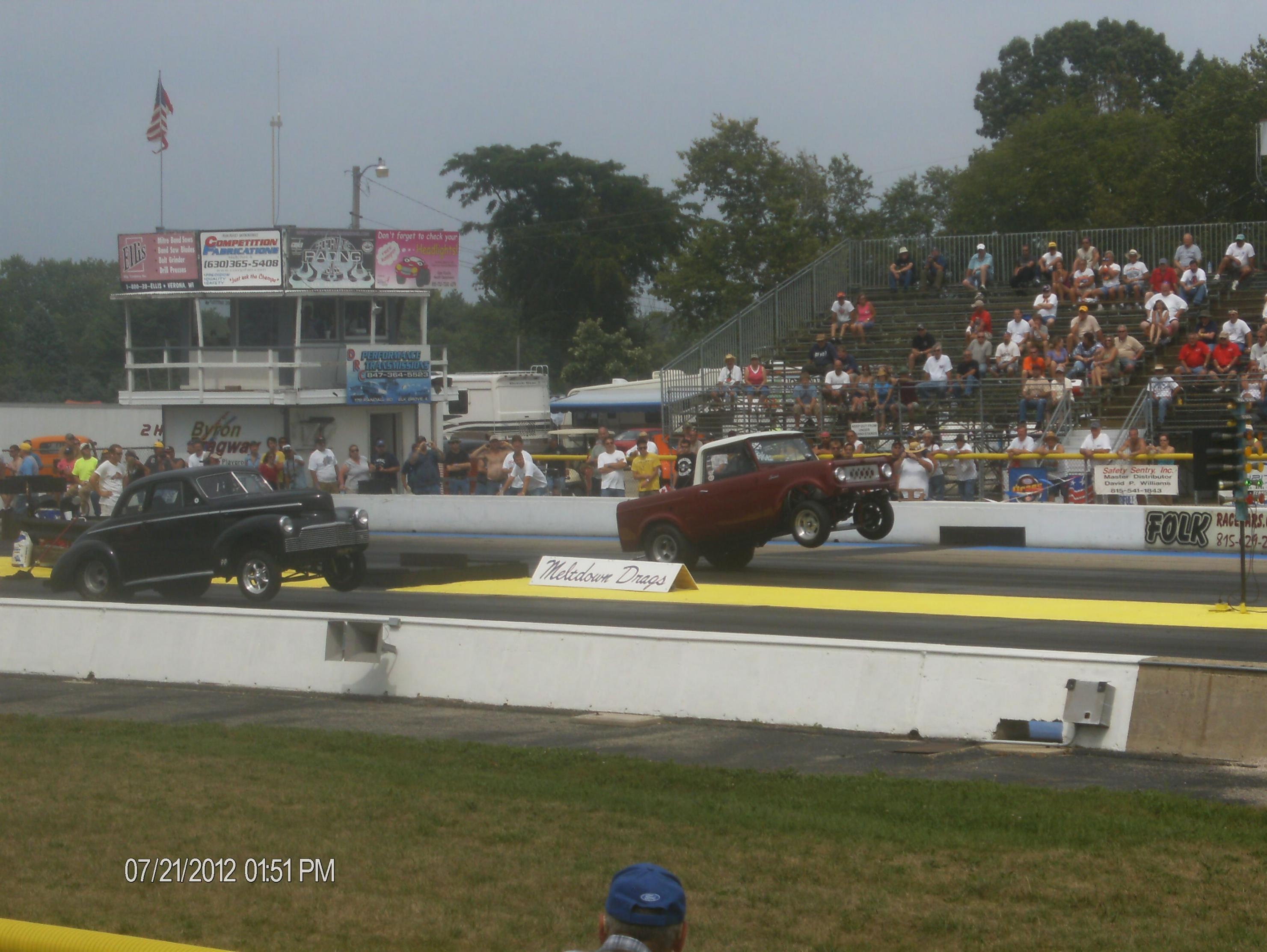

    Last Thursday 3 of us loaded the Scout onto an open trailer and piled into my crew cab Dodge for a 16 hour tow to Byron Illinois for the 3rd annual Meltdown drags.
    This event was put on by the Fugitives Car Club and I have to say, it was the best automotive event I have ever attended. The Byron track is top notch and the event was extremely well run and simply a blast. 300+ vintage race cars 1966 or older made p***es. Many of these cars / trucks were run hard...very hard. There were 2 g***er groups match racing both days as well as a bunch of altered wheelbase machines and front engine dragsters includng a very fast blown flathead powered machine that ran 9's. (very cool). Straight axles were everywhere. If you have any interest in vintage drags you MUST attend this event next year.
    Check out the site at www.meltdowndrags.com for pictures and info for next year.
    The Scout ran great all weekend and ran a best of 10.88 / 118. We pulled some decent wheelstands and got more than our fair share of attention.
    We match raced Redlineracer42 and his awesome 40 Stude for 2 p***es Saturday afternoon. Check out the picture of us both leaving with our wheels up... cl***ic. The Stude is awesome... it has a high winding smallblock, TKO 5 speed, 5.38 gears and it's street legal !! All that and it's knocking on the 10 second door... I can't wait for our rematch next year.
    The highlight of the weekend for me was a toss up between being interviewed by Hot Rod Deluxe with a promise that the Scout will be in the next issue (Very cool) and ... being recognized by the Fugitive Car Club and G***er Wars Magazine for our long tow and general at***ude. The $100 they presented us went a long way towards getting us back home...(Thank you)
    The lowlight was my only p*** on Sunday. We had the wheelie bars raised to the "Holy ****" setting and the pill in the 2 step was as high as we've ever had it (5000 rpm). What we should have realized was that after a much needed rain storm Sunday, (need for the area, not the event) the track had re-prepped with a ton of glue. The truck hooked hard and then bent the wheelie bars which threw the little beast to the left. If you look close on the video, you can see the bars bend and the Scout pull 3 wheels off the track.
    The re-entry was harsh... we bent the front axle, shock and shock mount. We may have also damaged the steering box and left front spring pack. That all goes along with the bent wheelie bars and destroyed bar mounts.
    It's all repairable... we'll have the Scout on a frame starightener next week to get the axle back to where it should be. Then we'll add some gussets. The wheelie bars will have to wait as we will have to pull the diff to fix the mounts. That won't happen until the off season. Which means no more wheelstands until fixed.
    By the way... the video of the bar bending p*** caught the eye of the guys from Bangshift... and they posted the vid on their site... very very cool
    This is the p*** that produced the side by side shot with the 40 Stude
    The... Not so good p***...
