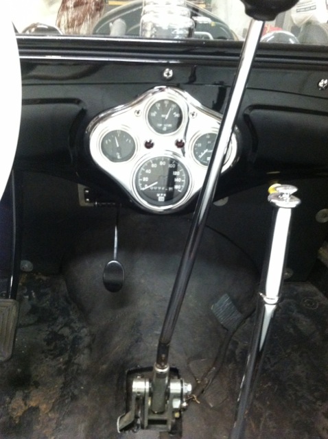

    bobo1
    from France
    Desoto 47 dash in my 29 modified [​IMG]

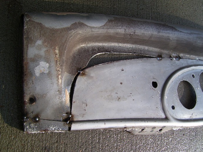

    Your panel looks good.
    On my '29 panel, I tacked pieces in the stock gauge openings and laid out the SW gauge locations, Use of the big speedometer caused some rearranging to get everything to fit evenly. I completely welded any area that would remain after using a hole saw for the gauges. Once cut out, I metal finished the panel and sent it to the chrome shop.
    Luckily haven't had to deal with a stock tank, other than cutting them out.

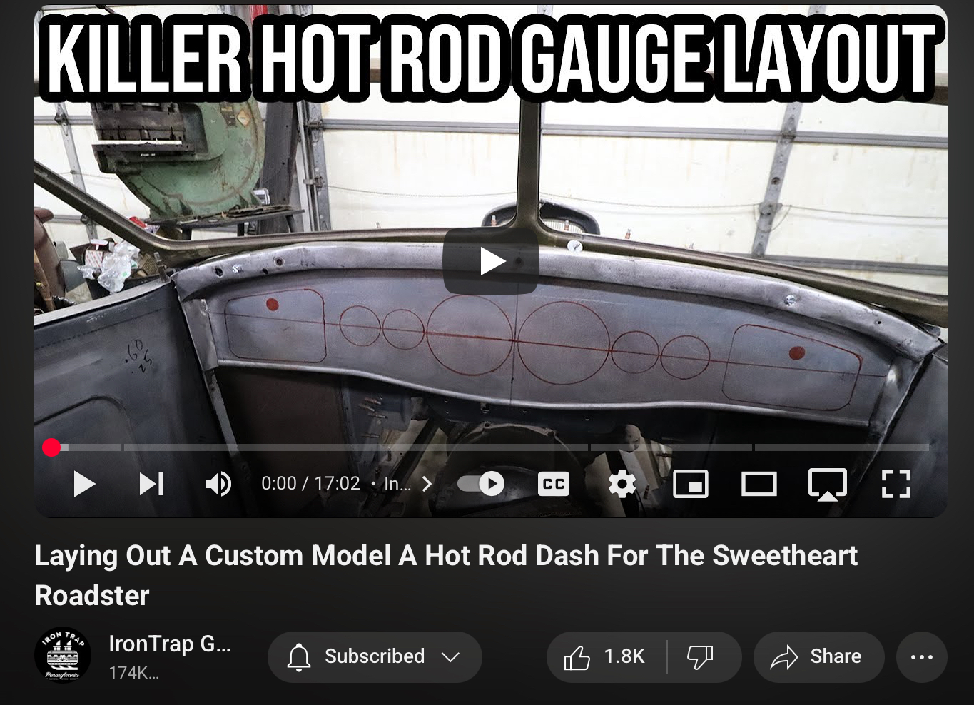

    I’m going to go out on a bit of a limb here and suggest something a little different. Rather than looking for an original dash that you need to modify to fit, or buying an aftermarket one, use the money to purchase a bead roller and shrinker/stretcher and make your own. Before you do that, grab some cardboard and do a mock-up first. This is one I did years ago for a Model A roadster cowl.
    osage orange and Deutscher like this.
  25. chev34ute
    Joined: Nov 13, 2011
    Posts: 1,727
    chev34ute
    Then once you have a pattern you are happy with, transfer it onto a sheet of MDF. The MDF pattern will be needed as the template to cut out around the sheet metal. Metal shaping may seem a little daunting for first timers but if you click on YouTube you will find channels like “Iron Trap Garage” that show you how, step to step how to fabricate your own dash panel. The beauty of having your own metal shaping equipment is you can make your own panels to repair doors, lower cowls and even make full panels like cowl vents.

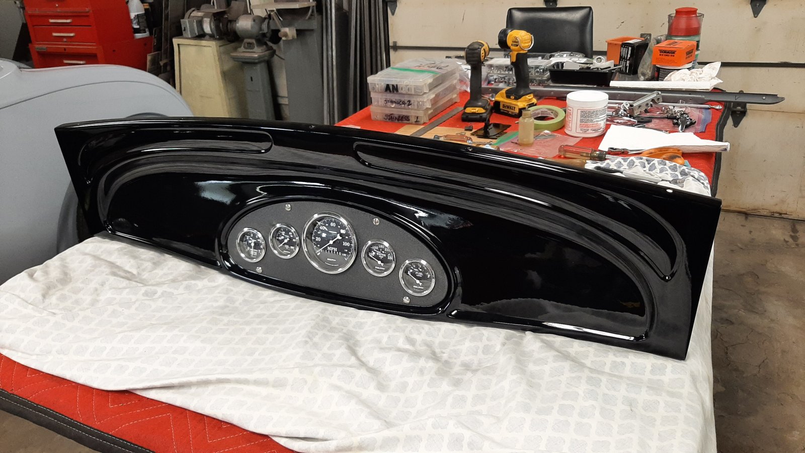

    G_Don
    I made mine using the stock tank. I really wanted one of those cool aristocrat dashes but couldnt afford one. For about $30 I made this gauge panel (Not including the gauges), and I just use the stock gas gauge. I think I had them extruded about an inch to fit. IMG_8061.jpg IMG_7675.jpg IMG_7817.jpg IMG_7673.jpg

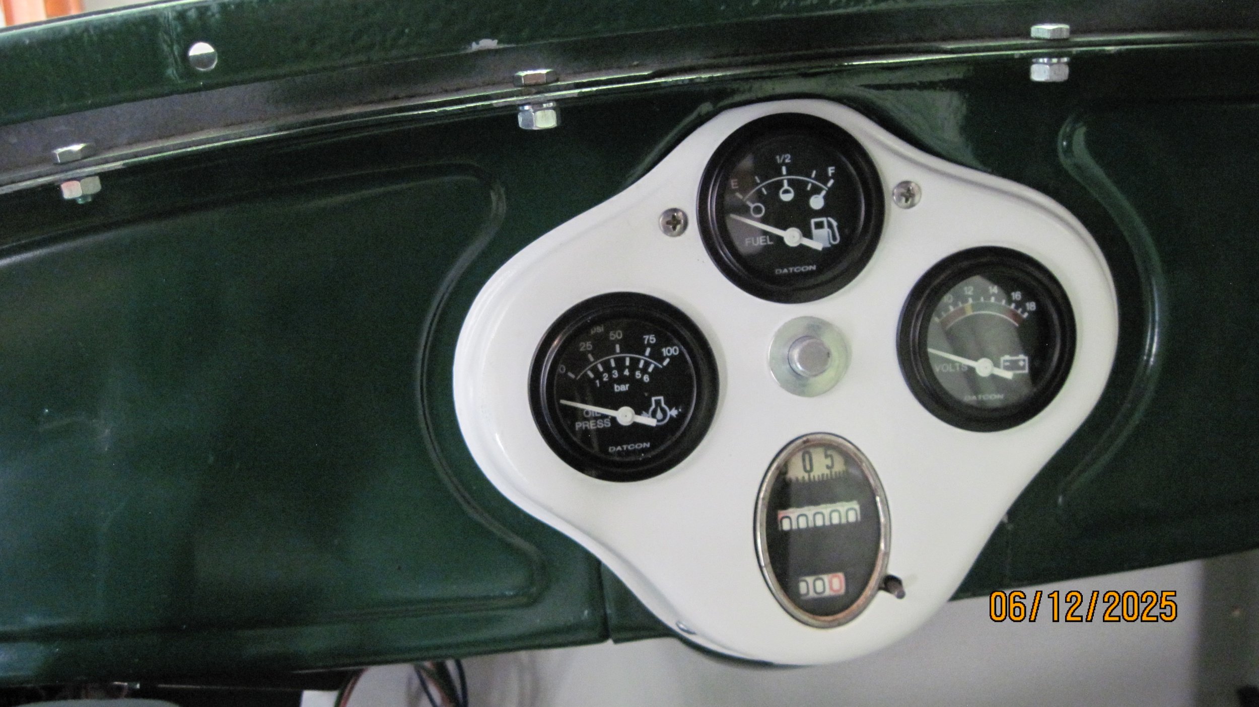

    Your dash inspired me to adapt mine to the stock panel. Yours is so clean, tasteful and direct. I still needed some gauges but didn't want them in the (former) tank so I put them overhead, which is where I placed the ignition, light and hazard switches. That area also has the two temp gauges (engine and transmission), and three indicator lights (left, right turns and high beam). I put the hazard flasher switch in the center of the overhead console, right in front of the swap-meet rear-view mirror.
