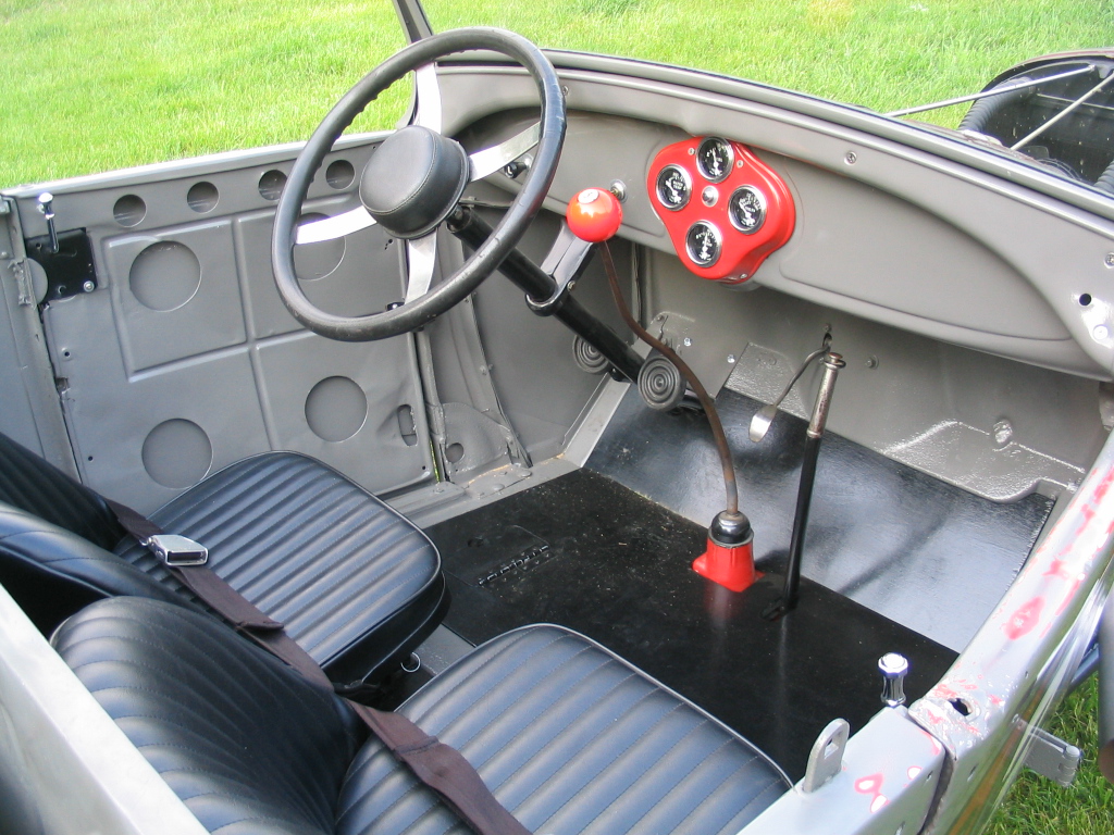

    Hot Rod Leather is a HAMB vendor and he sells a starter pushbutton that says start on it.
    I made a switch panel under the dash of my A that has his ball end toggle switches and the start switch.
    I mounted a key switched battery disconnect under the dash semi hidden that kills power to the fuse block and also a fuel solenoid cutoff switch.
    I didn't want a traditional key switch and this turned out great IMHO.
    I think there are pictures in my album of the switch panel I made and it is just a piece of left over subrail.
    None of what I have is hard to get to so there would be no fumbling around with it.
    Just think it out and it will be plenty safe.
  26. djust
    Joined: May 31, 2006
    Posts: 1,230
    djust
    from Oklahoma
    Here a picture of it.

  28. djust
    Posts: 1,230
    djust
    from Oklahoma
    For those of you worrying about shutting it off the toggle on the left marked ign turns the coil power on and off so its just flip of a switch to kill it.
    My setup is about as simple as it gets.
