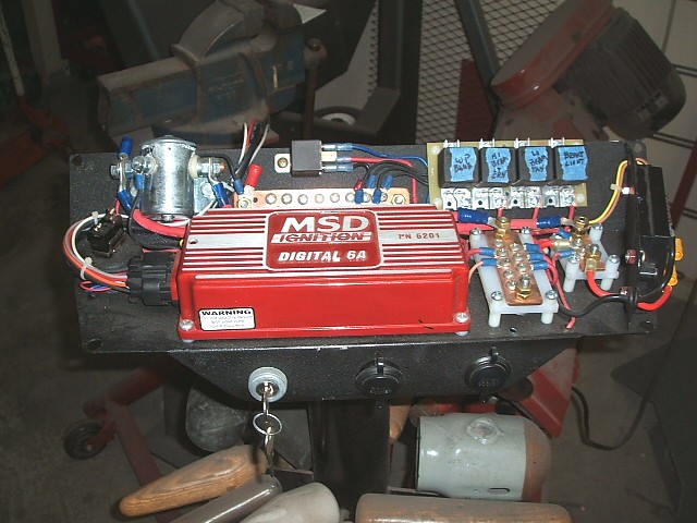

    What I did was have a key that activates a heavy duty RV solenoid that turns power on and off for the entire car. This switch mounts below the dash and back so it doesn't really show, all the electrics are mounted on the same tray up behind the dash. The off-on-start switch is a push pull that mounts in the dash and looks just like the headlight switch and the heater blower switch. When you get in you insert the key and turn the car on then you pull the knob out one click and the ignition is on. Pull it out against a spring and the starter activates then you let go and it returns to the run position. To stop the engine you push the knob in.
    Here is a link to the switch http://www.haywireinc.com/index.cfm...category_id=25/home_id=-1/mode=prod/prd14.htm

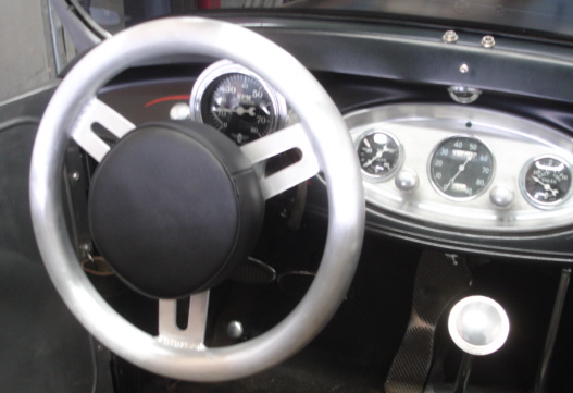

    I still have the key in the stock spot just moved the amp gauge and put in a starter ****on from an old America LaFrance fire engine. Its all metal with the bezel that says starter...
    I didnt worry about any of the other ****, other than it was a 12volt switch!
    I figured if it could start a fire engine it could start a flathead roadster!:D
