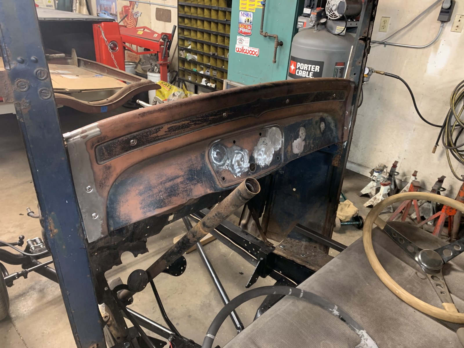

    It's kind of what ever you feel like doing and how much time you want to spend doing it.
    A heavily modified 38' ford dash converted to bolt into my model A. Around 35 hours labor. But it's one of a kind....

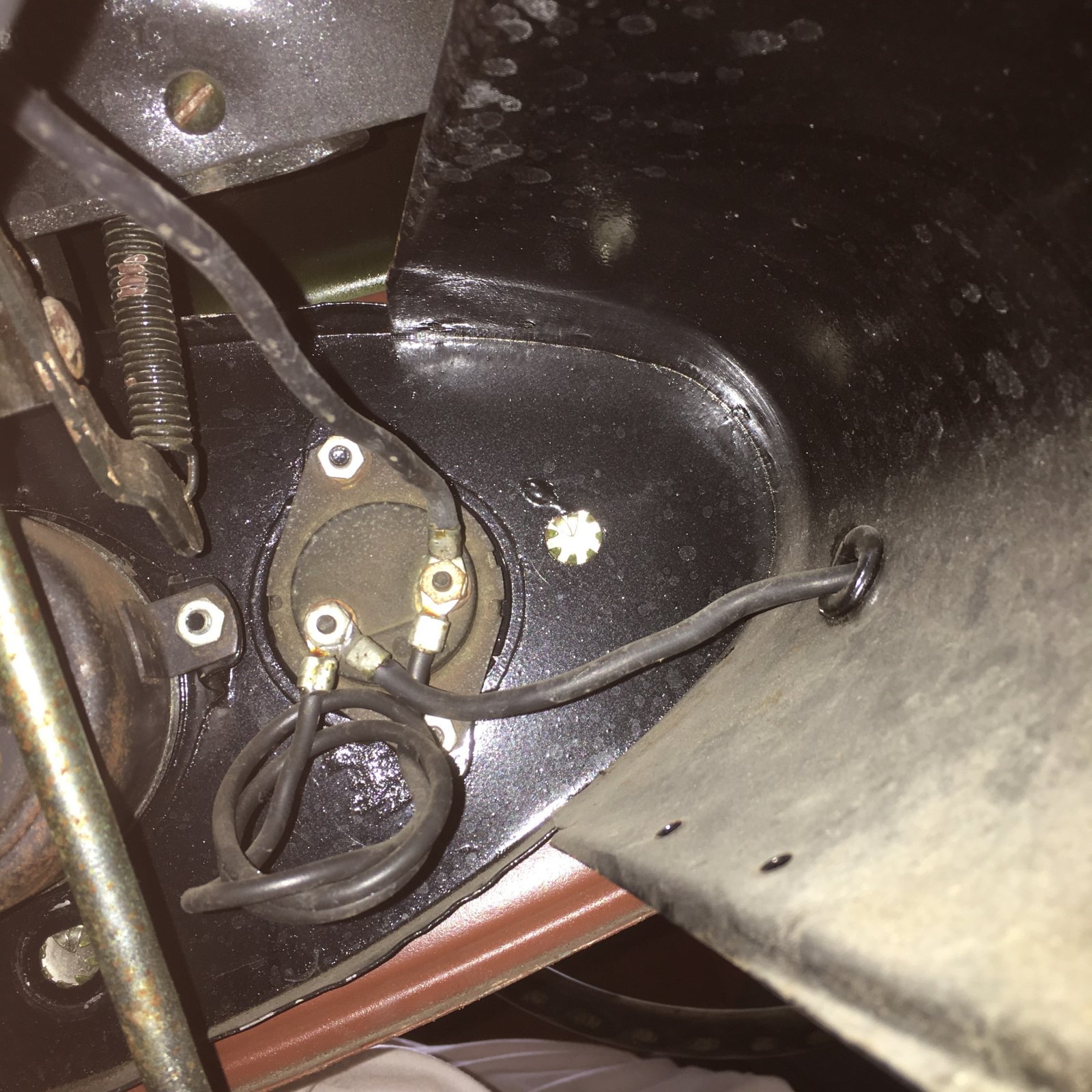

  7. I would use the stock instruments with additional gauges around the steering column or in the right kick panel. Of course looking at my AVATAR you might have guessed that. The stock ammeter can be used with a higher output electrical system by running a shunt across the ammeter (see photo).
