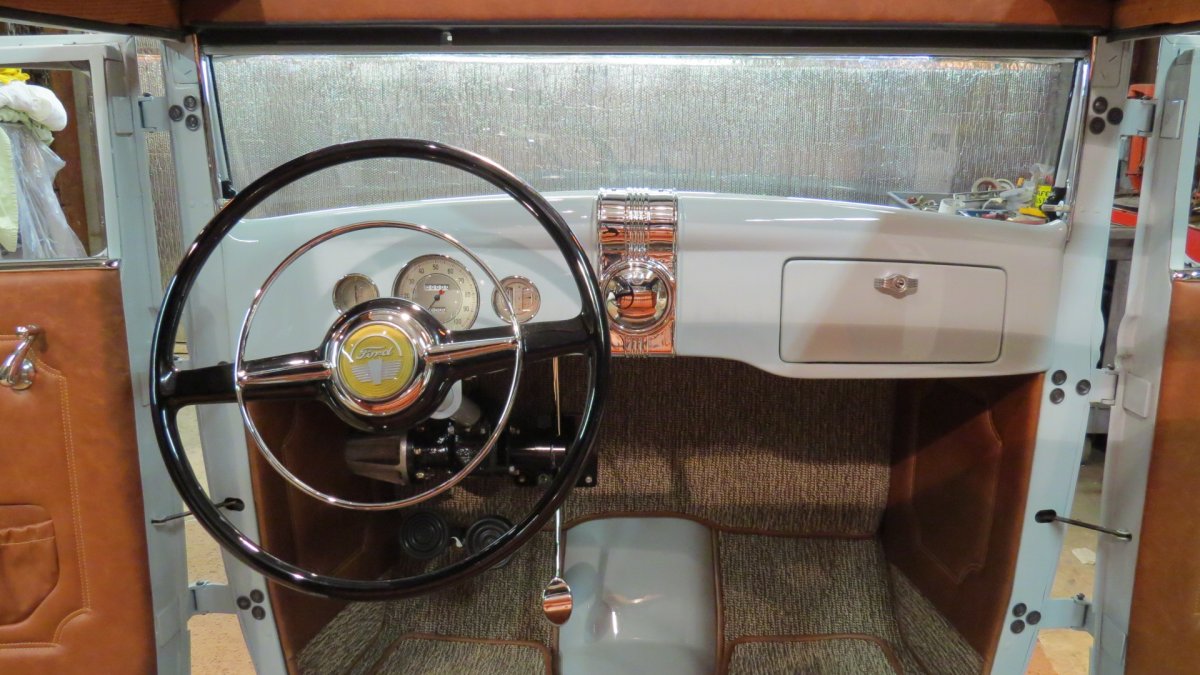

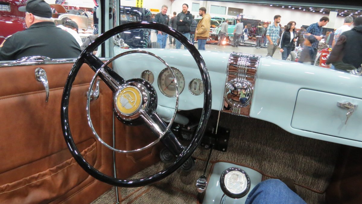

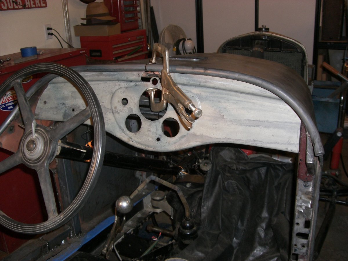

    Where are YOUR pics of the Volvo dash?? eh?
    I did consider a 544 or was it a 444, I forget....but I went with the all time "belly ****on" or "favorite" in some minds. the 40 Ford in a 32.
    There are two ways to narrow them, either make the center speaker area narrow, or, mess with the two outer ends, which I did.
    The gauge cluster is 46-48 Plymouth, and the center radio block-off is now a hinged defroster vent

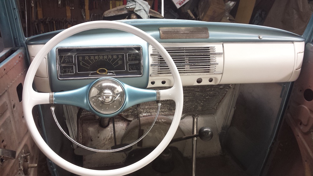

    I've got a '41 Chevy pickup dash in a 1927 Model T coupe. The top curve matches almost perfect!

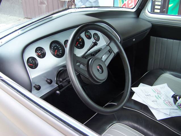

    check out the STUDEBAKER truck dash... it don't belong where it s
    at stock messed up (buy still neet)

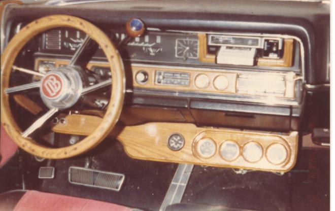

    How about a 55 Dodge dash in a 50 Studebaker?-MIKE:D:cool:

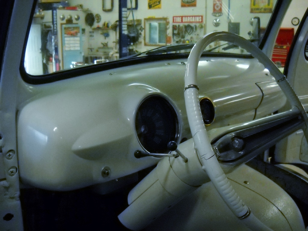

    '36 dash and '48 steering wheel in a '30 Model A. Glovebox lock is a '37, more art deco than the '36..
    Gauges were moved @3-4 inches to the right to center up with the steering wheel.

    My side window frames, and trays of wire terminals are on MY sewing machine, and maybe some other things I am missing. lol.
    My wheel center is a 41-48 Chevy car with 1/2 horn ring broken off, center ****on hole cut larger for some unknown 50s Olds horn ****on. Outer rim of wheel is now smaller ID and dished upwards a bit by using a 68 VW wheel rim.
