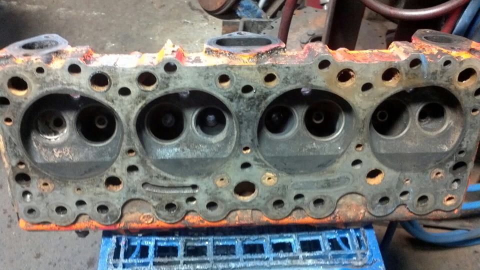

    Frank this is for you, lots to do here too ;) 1 hour and a half with the guns ah blazing :D

    So are you going to pull it out for rebore? or just doing the valves?
    Notice the days are getting longer just in the last week?.....I was wondering how long you were going to put that off... spring is coming too quick for these builds.

    Pulled the heads to see what i had, found a bunch of valves and seats bad but also has a really big ridge I believe there will be broken rings as i have seen this before and when oil is leaking out the road draft tube its a good indication aswell lol And Hammeredt will tell you it smoked a little :) Now do i clean it up a little just do machine work and put back together or do i Hot Tank it and make it pretty to?? And what color I hate making choices with this damn car ;)
    Things were tight with my sons race car in the shop to
  15. F&J

    Yes you should tank it to clean out the p***ages.
    I can't chose anything either.. I need to paint the firewall soon; I don't remember white firewalls when I was young, just black...but white will need way less fussy sanding/blocking.
    Toss a coin and get going...that's my choice :)

    I planned on the p***ages being clean, trust me nobody gets them cleaner. The motor will look way to good and out of place after i tank it and paint it so it will make me clean more of the car i guess its not a bad thing... I know my firewall is black and thta i have seen some cars in magazines that had the walls white but dont know if there original or not.

    I`ll check into that stuff frank but i`m gonna just lap the valves and m***age what i can. maybe a ridge reamer and new set of rings we`ll see when i tear it down.

    I don't know what's available for rings, but last year I did find NORS .000 to .009 "file-to-fit" rings for a 324 on ebay for $15 shipped.

    Everything is available but getting scarce. It really needs a overbore, I found 3 stuck exhaust valves in the guides theres my skip. Thats what you get after 50 years worth of sitting i amlucky it ran aswell as it did. Needs lots of cleaning...... I want to Hot tank but may just do it by hand and keep the patina for originality :confused:

    I checked with Pease in Palmer for pistons; he only had a few in various sizes for 303. i did not ask about rings, etc.
    As far as originality...don't let that thought mess up common sense. We all know it was and still will be the same Olds 303 motor from back then, so don't worry. If you want to tank for the bore, why not. Paint it back to that "farmer red" if you want originality.

    I meant originality as a survivor and to show how the car came etc you know what i mean??

    You opened pandora's box when you took it apart (right thing to do IMO if you don't want to trailer the survivor everywhere) and the only way it's going to be clean enough to put back together is by tanking it. How would you feel if some crud dislodged and got pumped all through the innards, undoing all the work you just finished?
    Just sayin'...
    (I'm waiting for my block and crank to get back from the machine shop because some crud wedged and spun a cam bearing and scored the crank on my fresh rebuild. And that one *was* tanked.)

    Yes, I know what you mean..but like those ancient rear tires, sometimes it's ok to redo something. All I meant was to not let the car hold you a prisoner. ...but if you slip that BBC in there, then we gotta have a little talk;)
