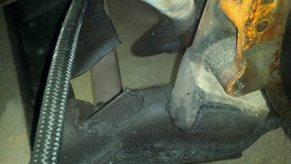

    looks like they just added a 35-40 ford front crossmember for the front motor mount, looks like the member that the spring is mounted to is just the stock one trimmed up and in the stock location still.

    ***us I think your right about the 35-40. And your are correct the stock 32 hasn`t been removed just trimmed the rivets are still there so its stock.

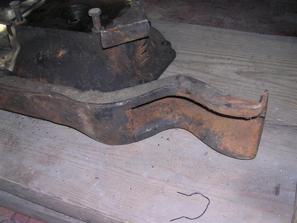

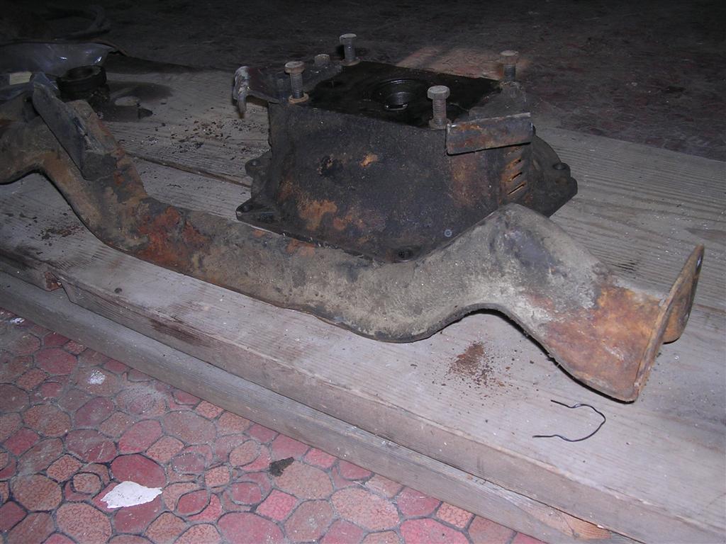

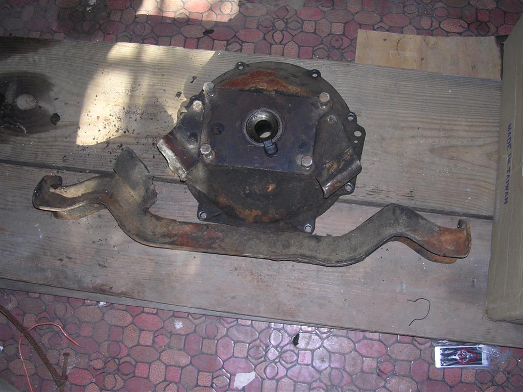

    Dave, some pics of a stock trans crossmember. A/T and stick should be the same I think. This one is A/T up next to a stick bell. I can measure total width if you want.
    So yours is not full width? ...just 2 end pieces?

    Thanks for pics Frank I think it`s a olds cross member but hacked up quiet a bit here`s a pic. It does have the 2 stock ones that bolt to the bell housing 1 was delamanated from the steel. I haven`t measured anything yet nor have i worked on it all finally getting busy @ the shop Time to catch up now.. I put up some more pics i dont know if i put these up yet i guess i shoulda checked :rolleyes:
