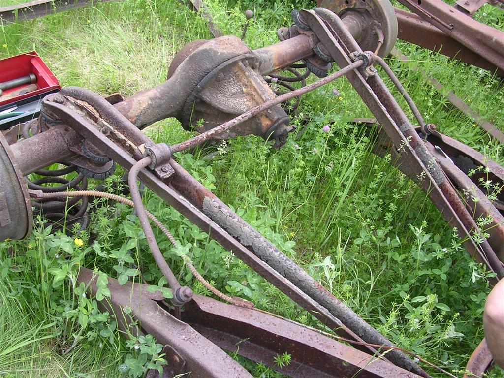

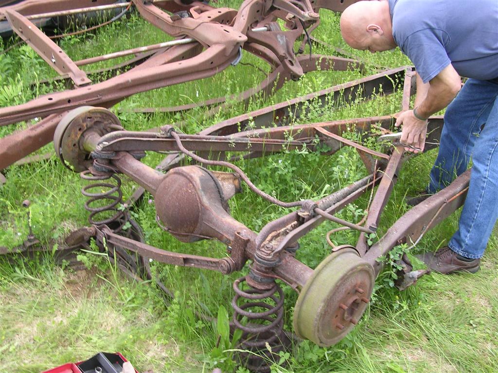

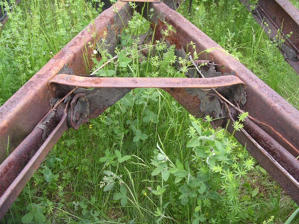

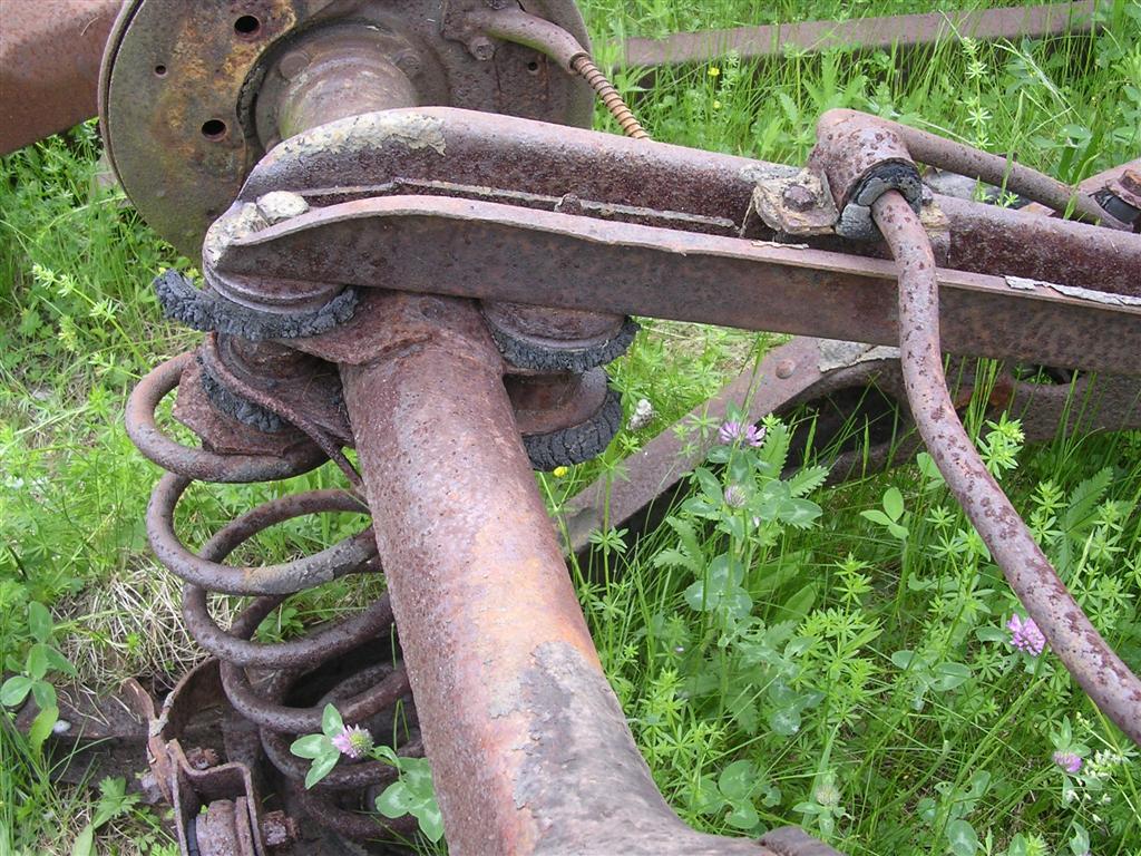

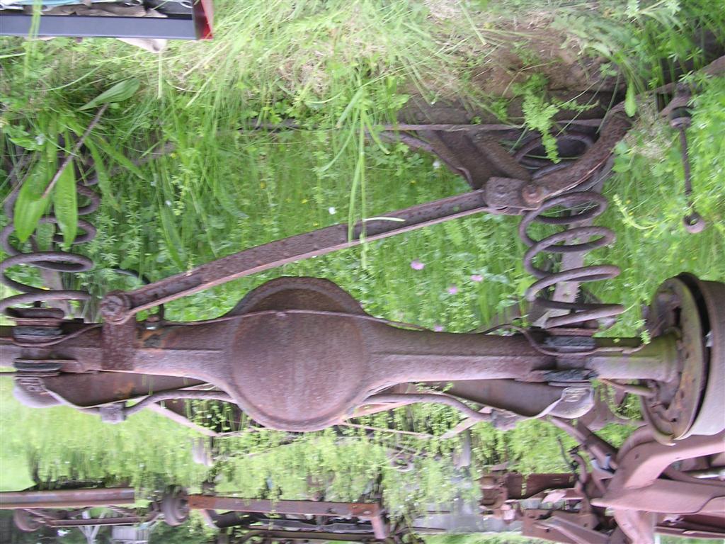

    Hey Dave, we went to look for Olds ebrake parts today for your coupe.
    The owner showed us the 49 Chassis, but when we got the drums off, the shoes and the flat crossbars are missing.
    But we scored the 2 ebrake levers that hook to the cables and anchor on the shoes. I guess that's a good start. Maybe you can get those 2 flat crossbars from auto parts store, in the "help" brand? or get some from any 11" brake setup? Must be close enough?
    Broke my camera so I can't put up a pic of the 2 levers we got for you.
    The ebrake cables were junk, but you can get NOS ones from Pease, I paid $25 each for mine there last year.
    Check out the stock suspension and bar mounts. Sure beats welding the trailing arms to the axle tubes. You need any of this stuff to set up the coupe? The bars are not rotted, the front cross piece to mount the arms looks good, too.
    Found a very souped up 371 there too, I might be getting soon. Pop-ups, solid cam, McGurk adj rockers, Stick flywheel and clutch.

    Frank thanks for the pics it explains exactly what they did and how, they used the olds rear and trailing arms. And thanks for gertting those pieces I will trade ya for the 371 :p that you got... I`ll talk to you soon.

  19. F&J
    Joined: Apr 5, 2007
    Posts: 13,289
    F&J
    It looks great, with the old or new tires, engine color as it was or as it is. The car itself is still the same to me.
    It looks so much like what I recall 45 years ago on the streets. It has the small quirks that I remember, because these were built in different times by different goals and standards. Old builds are are a joy to look at, even if they get changed up a bit...they are what they are.

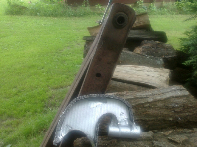

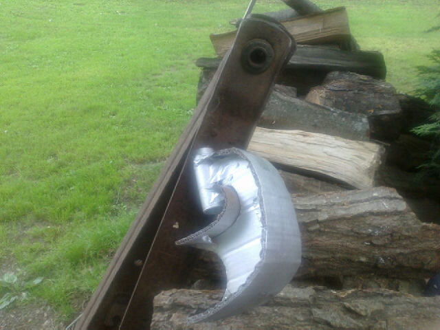

    Dave, here is a crude, out of scale hanger style. Yours would need a taller J maybe. 1/4" plate?
    Don't laugh at my cardboard skills. :)
    those are truck arms in the pic; 60-72 Chevy, I like using those bushings, rather than heims or tierod ends. They last forever and allow some twist.
