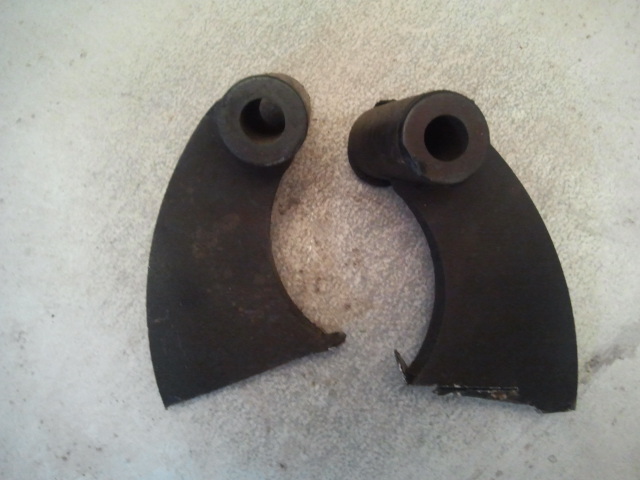

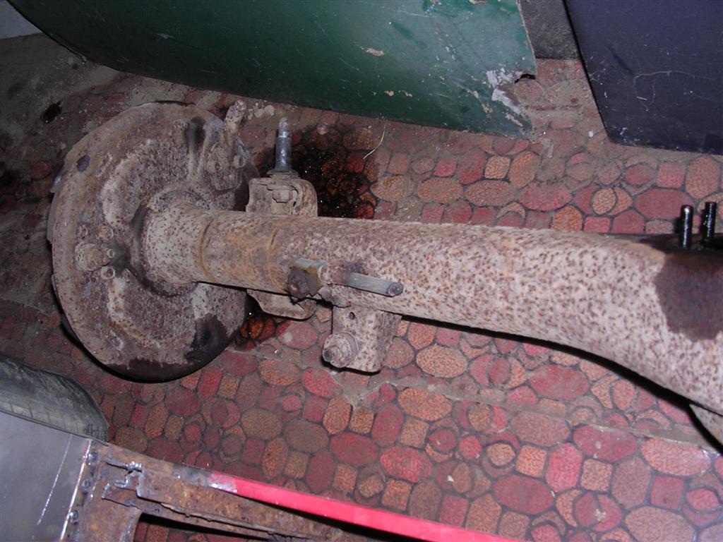

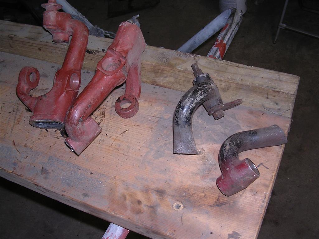

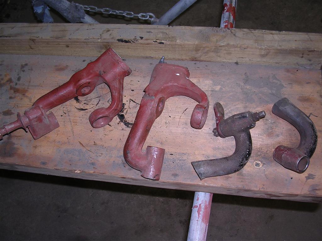

    Dave (or Frank), can these be used or salvaged? I cut them off my old rear end. I dont have the shacles though, just the perches!
    Theyd be about 3" on center to the hole from the top of axle

    I would try to use them. Even if they can't reach where he needs to go, then just use the sleeve part and add to it. That Ford stuff welds nice.

    Thanks Lars trying to save some things
    Frank all good suggestions and as when we talked last night I think we`re close to a plan now just need to find the parts and get to work...
    Slickwilly i would like to try those they may work or may be able to use them as shock mounts? Thanks for offering them up appreciate it.

    Dave, Here is aftermarket Chevy arm setup. Note that the U bolts sit diagonal across the tubes, therefore the U bolts need to be a bigger ID than the axle tube.
    The arms sit on normal looking spring pads that are welded to the underside of the axle tubes. Those pads also sit diagonal, so you can't just cut some off of a donor rear that has them mounted 90 degrees, like a twin leaf setup, because they won't be long enough and bolt pattern will be too narrow. Either find some Chevy angled plates, or most likely have to make your own pads.
    You don't need the bent-up hockey stick shape like the Chevy back ends. Also, those round mount washers in front of the axle are where the coil spring would fit.

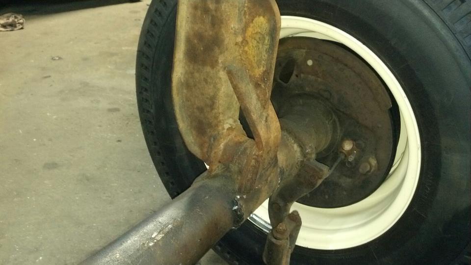

    More of the mess.. Now to figure out what i want to do going to be a long weekend i guess.

    Frank thats some good info need to think about this all and make a plan :confused:

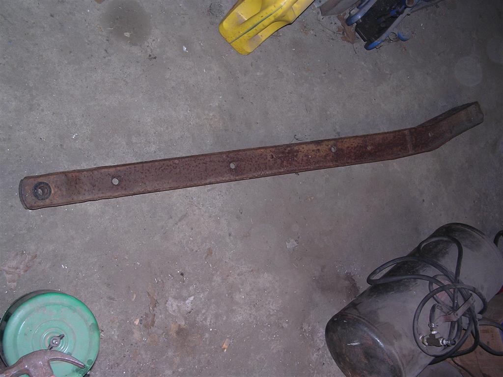

    No way I would put the trailing arms back in running parallel. I have been thinking about that all day long, since you called to say you were just patching for now.
    I am 99% sure it won't last the season unless you move the fronts in close together, and set up the rear part with a U-bolt, or some sort of bolted connection.
    Here are those Ford bars that were on some sort of Ford 3 link, maybe a Mustang two rear end? It was the upper link. Anyways, see how the profile is sort of like your Olds arms? And they have BIG bushings which is 100 times better than aftermarket small, stiff ends.
    Just find a donor that can be blended to your arms.
    I have a pair of used Chevy truck arms if you are desperate. Not sure if I would have the big U-bolts, but truck shops make those in any size. Chevy arms may be the quickest way out for the season?, because they might not need to be modified unless they are too long. You'd just need to make some sort of simple crossmember up front.
    I know you worried about the exhaust, but that's not a good excuse to not angle the arms. :D
    Or, see how much the guy wants for the stock 49 Olds arms? These would need mods to back part to use U-bolts, so it will add more time to the job.:(
    I dunno.
    If you are stuck, at least fix the spring hangers while you think about the arms. That would be getting something important finished.

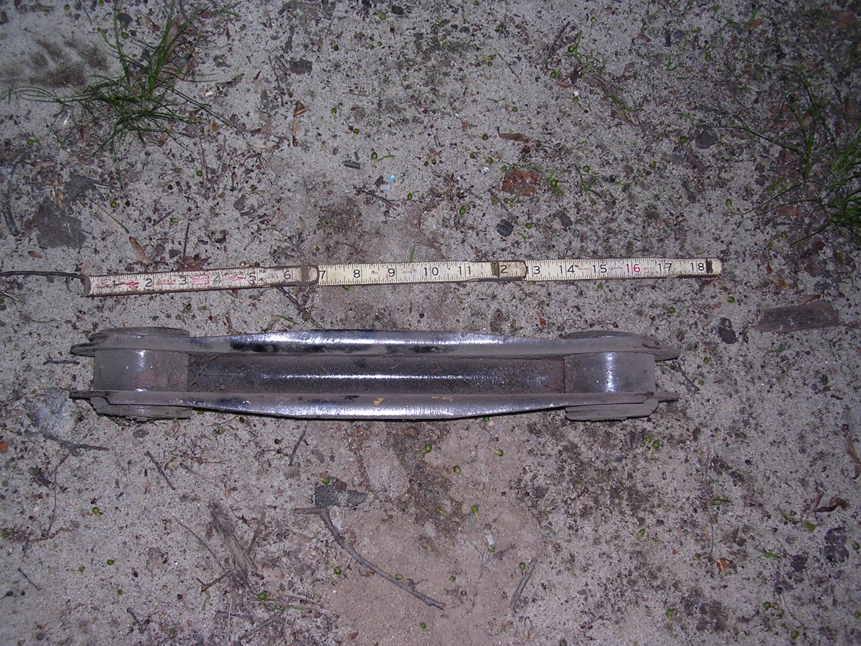

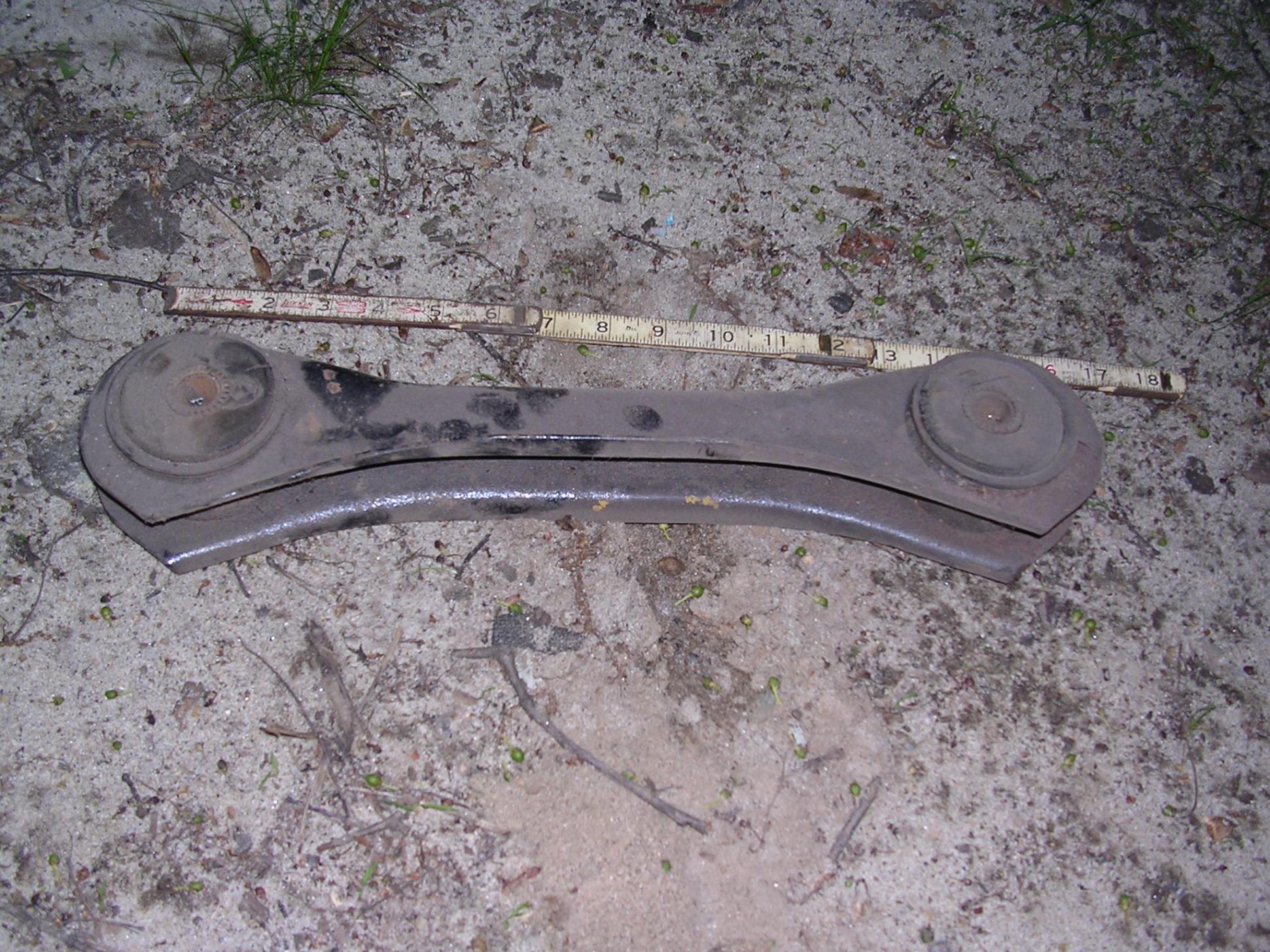

    51" from center of front bushing hole, to the axle centerline where it will lay on top of the angled rear part.
    If you can maybe see in the pic; when the two halves were riveted together, there are pressed u-channels that now become the through holes for the U bolts over the axle tube.
    Then you need to make 2 spring pads. They sit angled on the tubes. Nothing fancy, just to keep the differential from spinning inside the U bolts.
    As I think I recall, there were plates under the U bolt nuts, that reinforced it, but also were shock mounts...I think, not positive,..
    I can look in the barn in the AM but I don't recall seeing any, but there are plenty of boxes to look in. Or just make a flat plate with a stud for the shock. easy

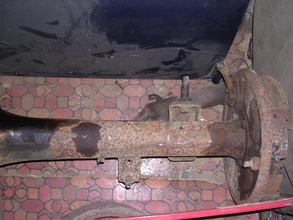

    here are some things I have:
    I don't know if your 32 spring is 2"? If it is 2", here are some front 2" hangers, the red ones are 46/48, the others are 40 I think. You could add some steel to these to reach? Make it look kind of like my cardboard deal with straps of steel, to look like an I-beam profile where they weld to the axle tubes.
    Also a 1956 Olds rear housing with less***** to grind off? This rear is 59.5" from drum flange to drum flange. Should be what you have? Check your ratio; I have a 3.42 stick chuck that a hamber out west wanted, but it weighed out too heavy to ship cheaply. I have the parts for a complete rear with axles,drums, backing plates and all else.

    Jeff, when i first looked at the car, it looks like it just will not work with the arms parallel. As one wheel dips in a turn, or body roll, there is lot of stress right at those joints. Yes, it could be welded solid like that, if the arms were angled in at the front IMO.

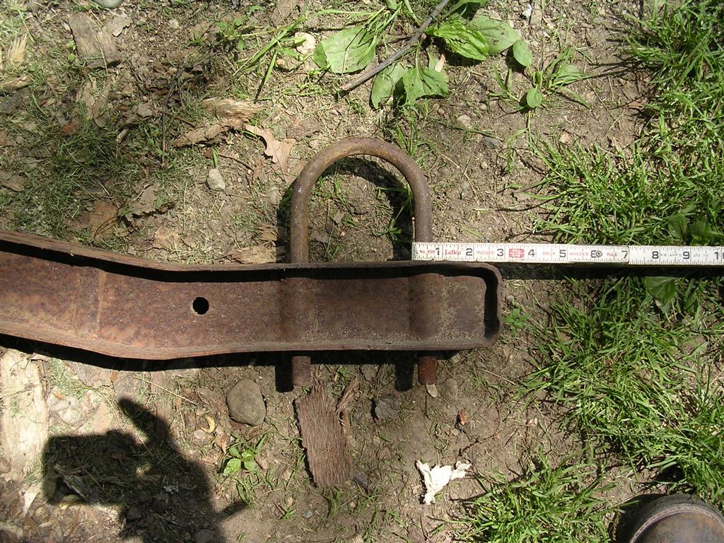

    I just like the simplicity of the chevy truck attachment, It works and is servicable, if you want to remove the arms for some reason later..
    Dave, I only found one original Chevy U bolt, but at least have a good sample. I can't find the lower plates, but they'd be ugly I think. Just make a stiff 2 bolt plate with shock stud mounted forward, to put the shocks ahead of the axle.
    3" of the arm sticks out to the rear spring area, but that can be cut off and just weld a flat back plate on instead if you need more clearance.
