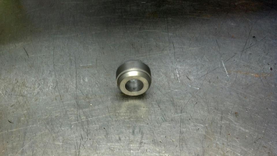

    Whipped this up quick to get Jake back on the road. I made some bushing with the right taper for the tie-rods so they will tighten up and not float in the torched hole in frame.It use to chuck back and forth and you could hear it moving back and forth...I boxed the trailing arms so they wont keep breaking. Hope it last the summer will have to redo it this winter.
