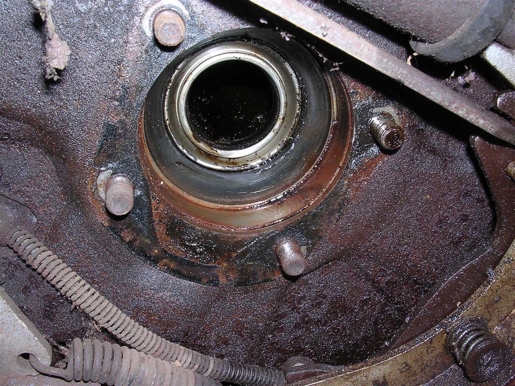

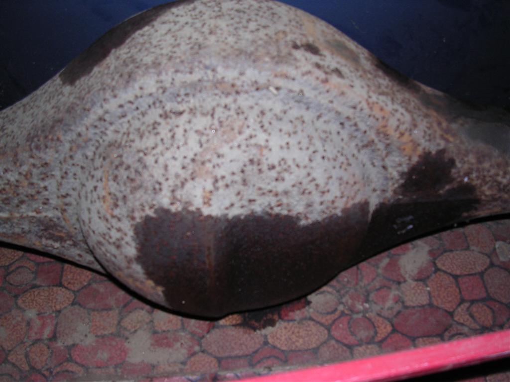

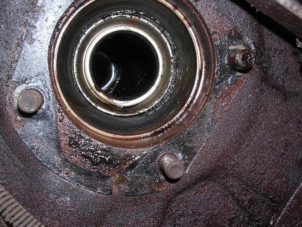

    Dave, here are pics of 55-56 axle seal area. I don't see a seperate cone part that you talked about. It looks like all part of the housing.
    and a pic of the back of the centersection..
    You may have to start a "olds rear end ID help" thread to get people to notice. I am finishing customer job right now, so I can't scour the archives for spline counts and axle shaft lengths.. Call me if you figure out what year. I'll have the contact info on that guy who has the Olds stuff.
    in case anyone is wondering what this is about....Dave snapped an axle shaft last night and we can't match it to one of my spares. 32-1/4" total length to tips of lug studs to other end at splines. 10 splines.
    My 55/56 stuff is 2" shorter :confused:
    I thought maybe he has a 57 up rear, but a rough measure on the carrier OD sounds like pre 57:confused:

    Frank that is a retainer in there and it comes out mine looks the same

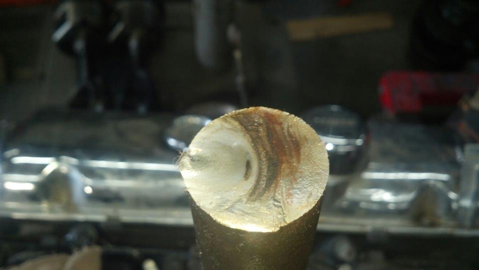

    Heres a pic of the axle it has been cracked for a long time and just happened to break on me i wasnt on it hard :)
    1956 and back have 10-spline axles. 1957-58 are 29-spline and 1959-1964 are 31 spline ruiner

    Well, something is not right with the ID thread? Because my 56 axle I had in my hand while on the phone today is 16? spline.. I forget:eek:, but it was no way 10 splines.
    And...duh on me, I put the 56 carrier in the 55 housing with 55 axles, so they are the same spline count (55 and 56).
    both of mine have yokes that are held on by a nut, not a bolt.
    EDIT: can you get a good pic of the back side of a backing plate? My 55/56 are one piece plates. That 49/50 rear end on that old frame, had 2 piece plates, some sort of flat shield at the outer edge.

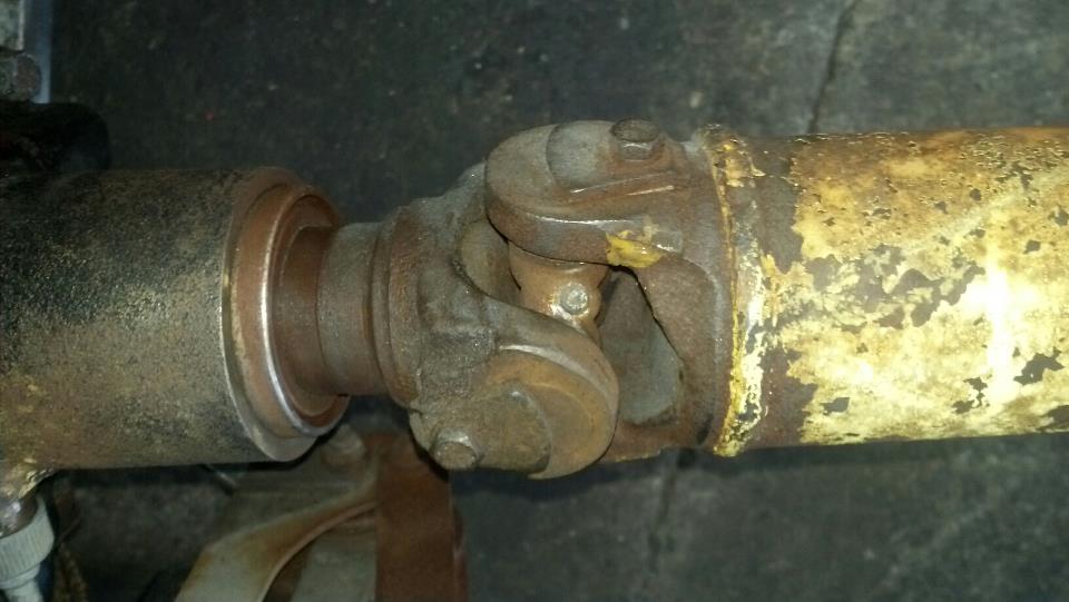

    Pic #1 shows a two piece backing plate; see the lower dust shield? That's a real early rear I think, because that chassis I showed had the same setup. Maybe they changed axle design with the new bigger body in 53? I think that's when they changed.
    The front joint looks exactly like my stock 55 stick, and a 53 stick i have here.
    The rear joint is similar to my rear one, except yours has internal snap rings on two caps. My bolts are 5/16" fine, but can't tell if yours are bigger.

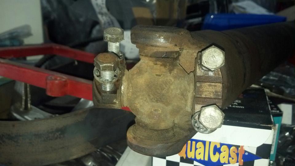

    Look at the pics i am posting of there mess witht he crossmember I need to remove this and make a new mount that is removeable, This is redicoulous!!
    The front joint is the one that came with the B&M******* the yellow piece.. I thought it was special as it is big and beefy guess not. The tail shaft is huge i dont see me breaking that.The one on the slant pan (ld*******) is quiet different.
    Yes the rear joint is 5/16 fine bolts i think this will be a weak point even with the little 303 but idk for sure??
    This whole deal is going to take some time, the rear gear looks good so far with just a quick look... So i need a axle and asap! I can slip this one back in and roll it around i suspect dont see a reason why not. Need to make a new driveshaft and crossmember etc I hope this******* is good!! :eek:

    Even with bigger HP, you will never break those 5/16" bolts. I know for fact that the cross would break first. My huge Diamond T 10 wheeler had the same setup, and when the first buyer wanted me to drive it up sharp ramps on a trailer, it made the articulated tandem rears go too far beyond the angle capacity of the rearmost Ujoint. It blew the cross out, across the street, but the bolts were fine, because of that interlocking square center deal thing. The square piece takes the load, not the bolts.

    The axle was cracked for along time before it broke i think it looks it if you look at the pic in the previous post. But yes i am thinking that the rear may be bent i mean how can it not be i guess with all there welding...
