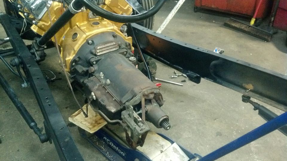

    Patman Thanks Buddy appreciate it I am trying Yes its solid mounted for now atleast we`ll see. They had broken mounts and the front had a very thin rubber piece mud flap?? I cut a old racing tire up and folded 2 pieces together and used that it keeps splitting pancaking so idk yet what i am going to do but i am not going to let it sit while i rdo the whole thing thats a winter project.

    Dave, If you don't have any other crossmembers besides the F&R spring crossmembers, you need to keep that rubber center engine mount IMO.
    That ch***is will twist with body roll, and with solid bell mounts not tied to eachother, there will be a lot of stress on the 4 new bell mount bolts screwed into the Hydro. Keep the front on rubber until you see how that new mount setup holds up.
    Before you put the body back on, I'd jump on one rear corner of the ch***is with your full weight, and look at the motor/trans to see if it's taking a beating from twisting.

    Frank i am no ch***is expert or fabricator but i did all the above, It does tie in the frame rails and stiffens it up for the better as for long period idk, but i have to make a plan and see what if i want to change it I guesss it would be the right thing to do but we`ll see. The front is on rubber but it isnt right keeps pushing out I will change that this winter with the hurst mounts and rubber puck style ford mounts or somethingelse havent got that far. This is just for the summer. The jumped on the rear and the ch***is shows it works as suppose to IK i have to see what happens and put some thought into it but want to drive it not be building it all summer Ik i need to becareful though gotta run ttyl

    I meant that the stock Olds trans mount crossmember, ties both trans mounts together. That takes a ton of stress off of those 4 bell mounting bolts, because the eng/trans weight is sort-of just pushing straight down.
    With 2 seperate bell mounts not tied to eachother, the stress on the upper bolt is towards the center of the car, and the bottom bolt is stressed to the outside of the car. Kind of like a hinge effect, if that makes sense.
    Being solid mounts, that complicates things from an engineering standpoint, because the bolt shank strength becomes much more important. Like a flywheel bolt has a tight fitting shank above the threads, so it actually acts like a solid dowel pin.
    If your 4 bell bolts have threads all the way to the head of the bolt, or, if the holes in the new plates are a bit loose, those mounts will "work" as the car twists. A crossmember under the trans, to tie both mounts together, completely eliminates the m***ive stress on those 4 bolts, "if" that crossmember is strong.
    If it was a 283 chevy with a light 3 speed stick, it would be plently strong as it is, but these Olds engine trans combos are so overweight

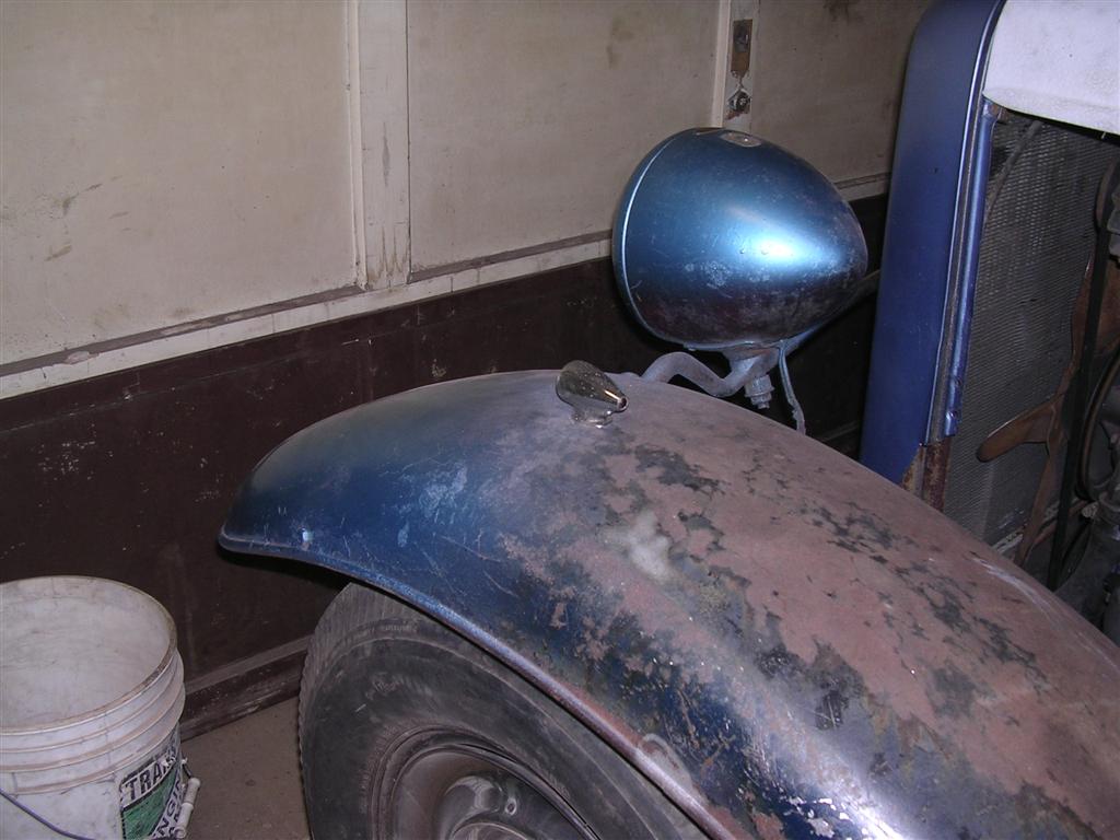

    Here`s some pics Idk if these cool little gems i scored are to antiquey for my car bit am thinking they would be cool for turn signals. And notice the hack job they did to the front subrail, and how it is going to interfere with the shifter need to change that hmm may replace the wholse sub and notch it for shifter wheres Frank when you need him :p. Had to notch the new trans mount added a bit of character back to it:D

    What are those lights frank i have tyhe buckets aswell no markings . I am not going to cut a gennie i am going to adda filler piece or bend up a new one.
    If look in pic the ****** dipstick tube wouldnt clear i didnt think it would but was hoping, with the channel it just is to low

    Ditch the light little lights, you dont need them & they kind-of dont match, turn signals are totally 80's, your arm out the driver side window more traditional. You need shorter headlight stands too.

    I ben thinking that i just picked them up for a deal and liked them. I wanted to change the stands aswell but its the way they did it back then so be it,i woulda liked short stands with 32 big ugly lights:D

  28. Lower lights would take away from the original build ( me thinks ) Also, I would prefer turn signals. Hell, probably 90% of the clowns on the road wouldn't have a clue on hand sigs and I'd want them at night for sure.
