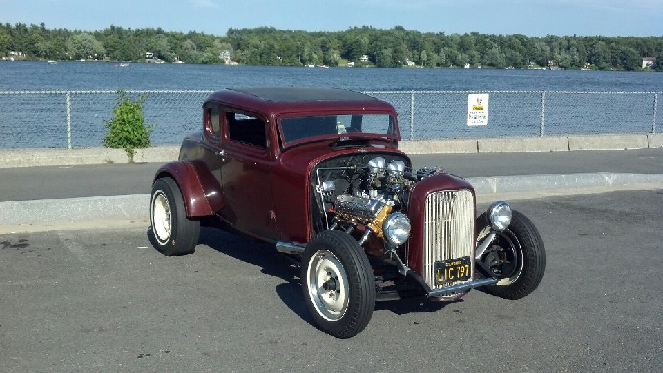

    Met up with Dave today at Kimball's Farm for a little 4th of July celebration. Lobster rolls and onion rings then we had birthday cake!! Check out this pair of deuces. Quite the difference in profiles. :cool:
