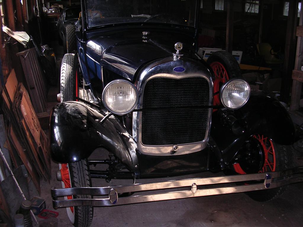

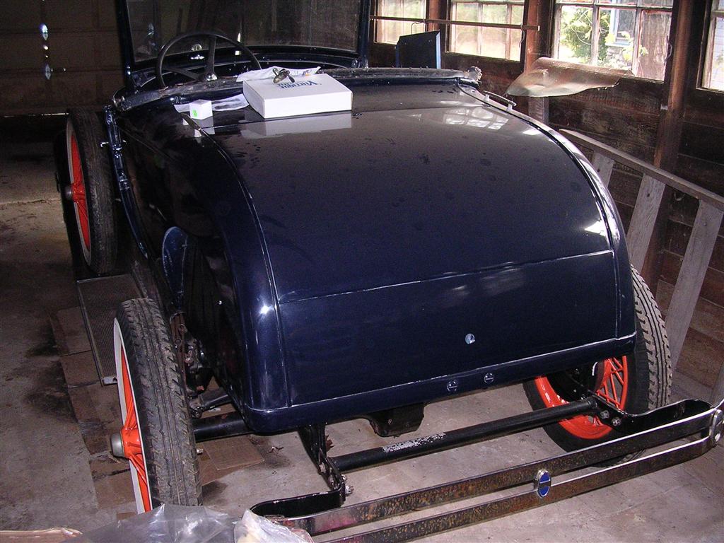

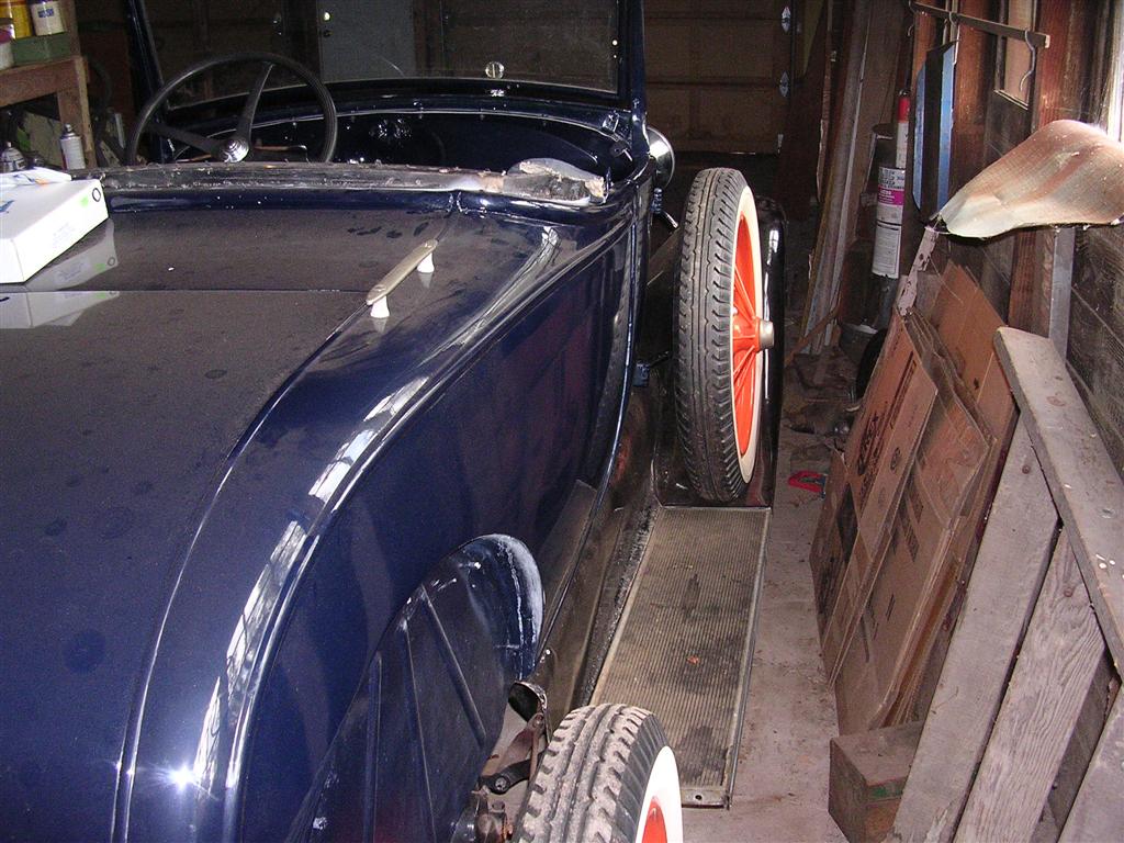

    Back to work for me; here is the A that just came in. It's in the upper barn, and I may get it in the shop quick.... after I fix my sons truck door sunday:rolleyes:
