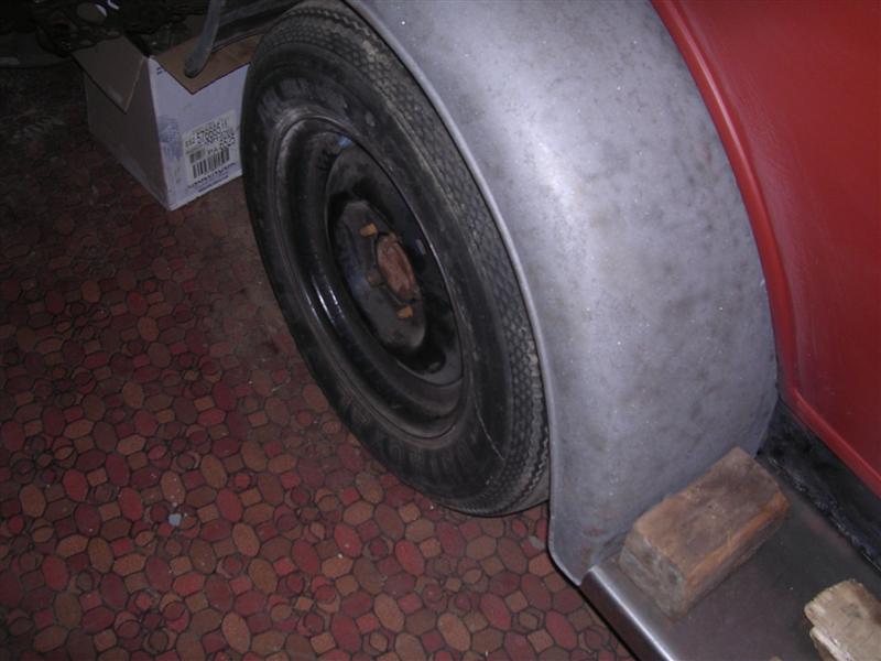

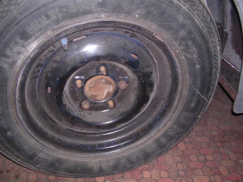

    Too hot to go check my 55 and 56 rear end numbers...but i maybe can remember to take a pic of my offset wheels..will I forget when I go in the shop? It's a tad bit warm. But it's cooler in there, than here in the house.
    edit: here are pics of the Studebaker 16" wheels. I should have cleaned off the dust because it makes the shape of the center look wrong. I think you can see that these tuck under a 32 fender all the way. I need to weld up 3 hubcap clip holes on the dome.

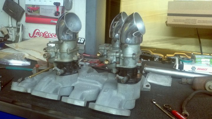

    Well I got a update for you guys i got some parts today Air scoops,couple nuts and bolts etc from the HOT ROD COMPANY here on HAMB. So i fiddled with them and carbs, I need to do some more tinkering with them. So i decided to pull the door latch on the PS it was sticking needed a good cleaning. I found the spring broke as usual My friend Sheldon knew this and sent me a good used 1, everything was great until i went to put the latch back together and i went to bend the tabs over to lock it together and 1 on each side cracked :mad::mad: So now i have to find one of these probably going to be expensive right... I think he told me to use a little heat to bend these tabs and i forgot until after. So here`s some pics if you have this piece let me know thanks. Its coming along good hope to have it running by the weekend!!

    The throttle shaft extention could flex being br***..I like using stainless steel, much stronger..
    I don't know for sure if the plenum is open so you can make progressive linkage..Remember, use the bases only so you can see the throttle plates move..

    I can't tell if your Edelbrock is 303 or 324 port size, or what your heads are. I kind of think you said no number, so it should be 303 heads with small ports. You should measure the height of the ports to get the right gaskets. I think it's 1-3/4 to 1-7/8 for 324 and 1-5/8 for 303.
    If you use a 324 intake on a 303, use 54-56 324 gaskets. A 303 intake on a 303 needs 303 gaskets; those are 49-53.
    Trans link from carb: There should be a bell crank on the drivers rear water port cover on the head. One link goes down to the trans, and one short link goes to the carb. You need that trans link hooked up and adjusted properly to get the trans to work correctly.
    If you are pushing for Milltown, you might want to consider the single carb because the linkage is already set up. If the top cover gasket is good and not shrunk, you probably don't need a carb kit for now. The accel pump should be leather, just soak it in gas or atf, it will work fine.

    I got all the brake parts in and on the car finally! I got the linkage for the 4x2 set up close to being done. I got the PS door all back together it works great. I was just looking at it after i broke the tabs and i said i`m not paying $200.00 for a new ***embly when all i need to do is tach weld 4 small tachs on the piece that was broke and wallaaaaa its better than henry`s way. I need to do the DS but thats not a priority right now. Tied up some wireing and fixed some of it aswell. Cleaned the interior again it is filthy. I also ajdusted the back window it was sagging and cut kinda short and had a gap in one corner. I removed the door gl*** as it was broke and i am putting new gl*** in. I still need to get a chance to work on radiator but not feeling that right now... shouldnt be a big deal just need to be in the right frame of mind if you know what i mean. I am forgetting some stuff i am sure but i wanted to reply to you guys and Ik you like the updates as i do on your builds. I am looking for original floor piece under the seat for my 32 mine is good i just need under the driver side pan piece.

    Update I made the bottom outlet for radiator that was rotted out they used some water pipe or something?? Sam said it always leaked.. I hope to have it done later today. I got the intake and carbs on I got the linkage set up but i dont like this eelco linkage at all. As Stromberg97 stated the br*** extensions flex quiet a bit and i will change this over the winter. I rewired some more stuff and replaced the fuel line, cleaned the pick up and made a new gasket for it, cleaned the gas tank out was a little varnished up ;), I cleaned the outside to and painted it wth some flat black crinkle paint it looks good in the trunk and almost like I never touched it. Got the T-stat and gasket, I am waiting for the fuel block I may just make my own to get it running for now. Got the screen cut for air scoops. Ran the spark plug wires through the looms on V/C but driver side doesnt look like it will work, gonna have to make a new set or leave them out of the loom. I changed the bulbs to 12v and the new battery is in and starter works. I am getting damn close to fireing it up and cant wait!! Going to change the oil and pour some kerosene through it prettyy sludgy. I may just pull the pan IDK yet see what comes out of there but then will have to wait for a gasket. Milltown is tomorrow and i doubt it will be ready but i am trying just to get it fired up and to move for a couple hundred feet lol. I need to see if the motor and ****** have any problems or major leaks. So thats all for now i will get some pics up asap my damn puter wont upload from camera so i have to upload them to F/B then to my puter:( Who`s going to Milltown is there a meet and great?

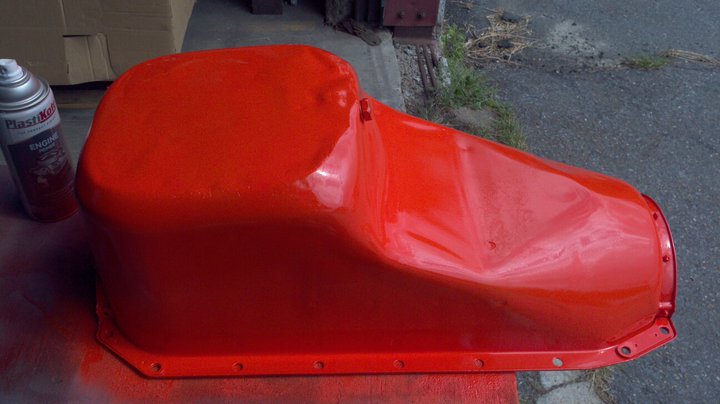

    Pulled the oil pan after i tried draining it nothing but sludge so pulled the pan and am Hot tanking it and gonna clean pick up. Added pics

    LOL pswchuh i been thinking about that but getting eager to get it running Heres some more pics of the pan all cleaned up will post more later
