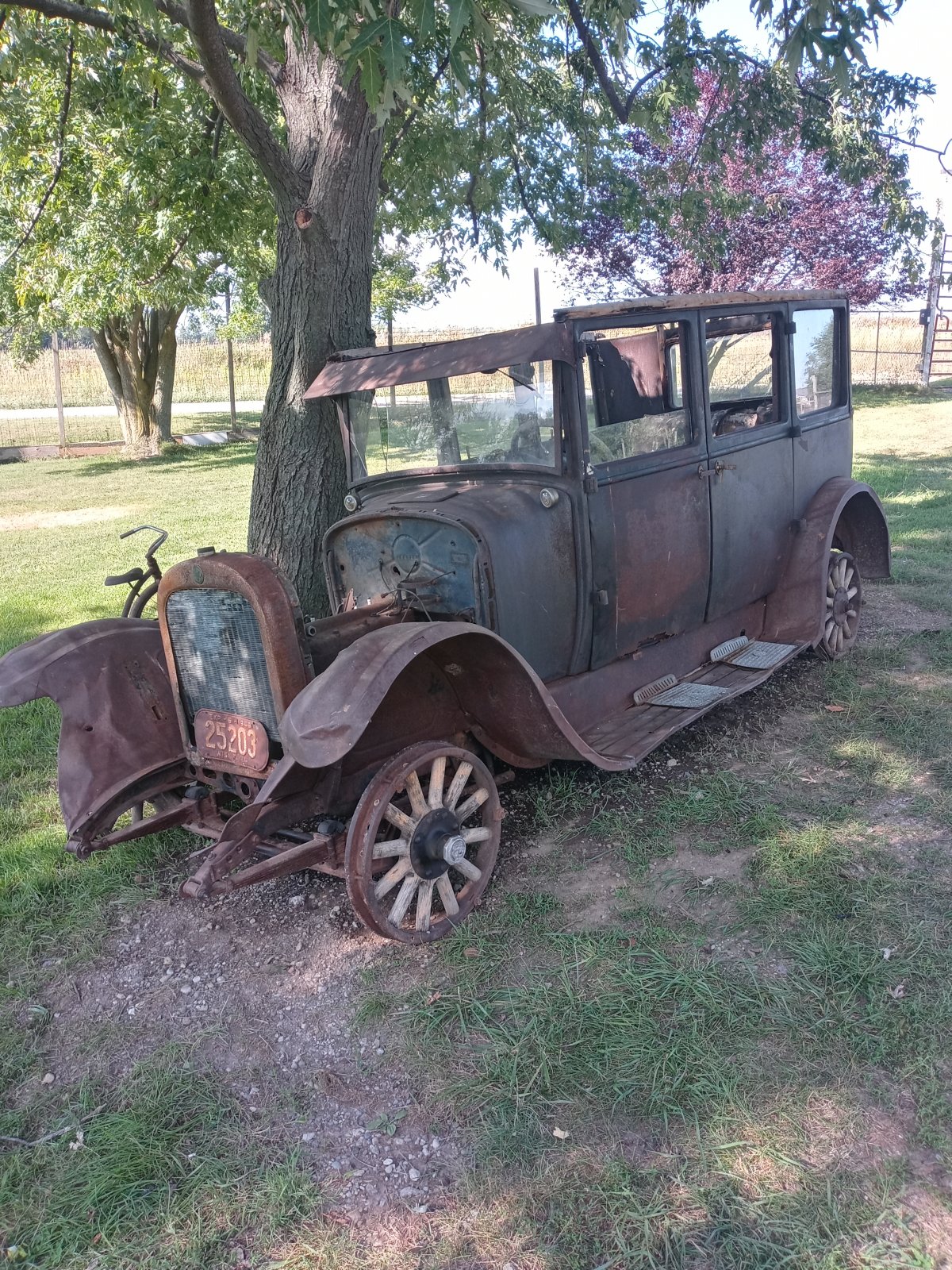

    So, remove the section of the body between both rear doors.
    Then move the rear of the car to just behind the back end of the front doors.
    Then add your turtle deck behind the back of the body.
    Then cut as much out of the frame and the running boards as needed, to put the rear axle where you think it should be with your roadster body.
    The photo shop guys would need a straight side shot of the car to be able to move the parts where they need to be to give you a picture of what it might look like.
    The next cheap way to get an image is to take a good side shot of the car, and make a lot of copies of that picture. Then take a pair of scissors and start cutting the pictures up and tape them together.
    Its really easy, until you have to actually do it...

    Joined: May 23, 2008

    Rickybop
    You've got the idea, Gene.
