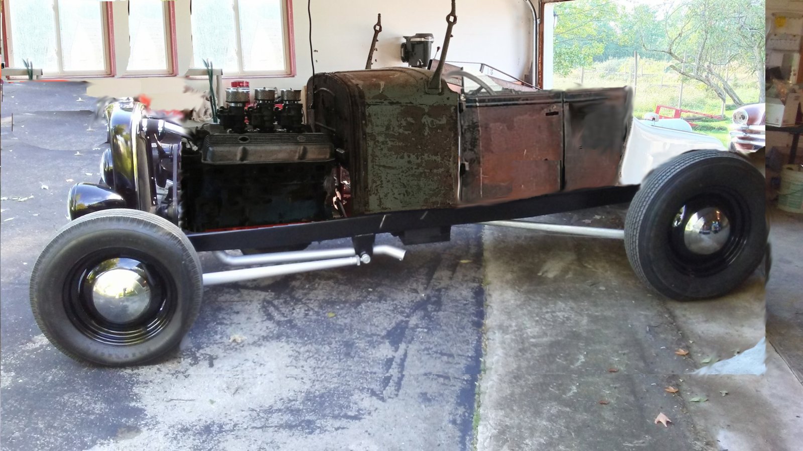

    I had to hack up some rather dis-similar pictures to put this together so it's extremely crude but here's a rough photoshop of the body in one piece. Looks like the sedan doors would work on the Chrysler cowl just fine, I'd probably use just the front door bottoms and the bottom of the tail of the sedan body to fill in the rest, I think the doors look less "sedan-ish" if there's a little bit of a rocker panel below the door. Turtle deck could sit right on top of the frame rails. The scales and angles are a little off here but if you squint you get an idea. I think it'll work fine.

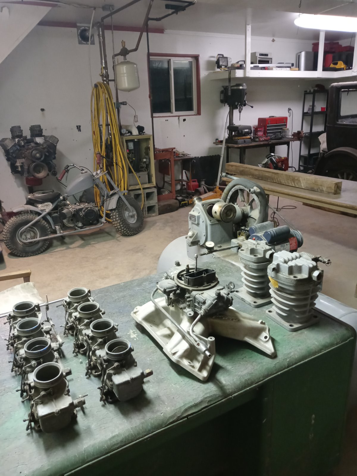

    Used aftermarket 4 barrel intake just for testing.
    Looking at getting some Stromberg 97s to replace the Holly 94s.
    Gotta test-run the engine. Install some speed parts. Detailing. Then the 6x2.

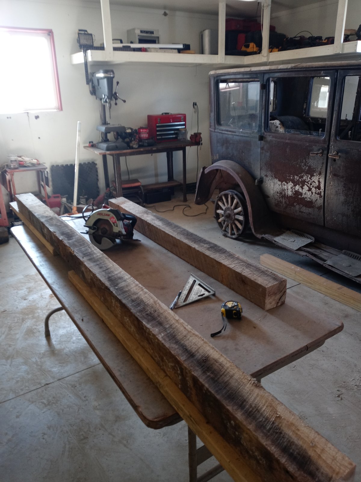

    Building an old-fashioned kind of test stand for the 440 from old oak 4x4s and scrap metal.
    Working on the air compressor.
    Bought a used aftermarket intake for a single four barrel for initial start up and tuning.
    Also bought a gaggle of Stromberg 97s. We'll give the Holley 94s and the Strombergs a chance. See how they do. Share my findings with you guys.

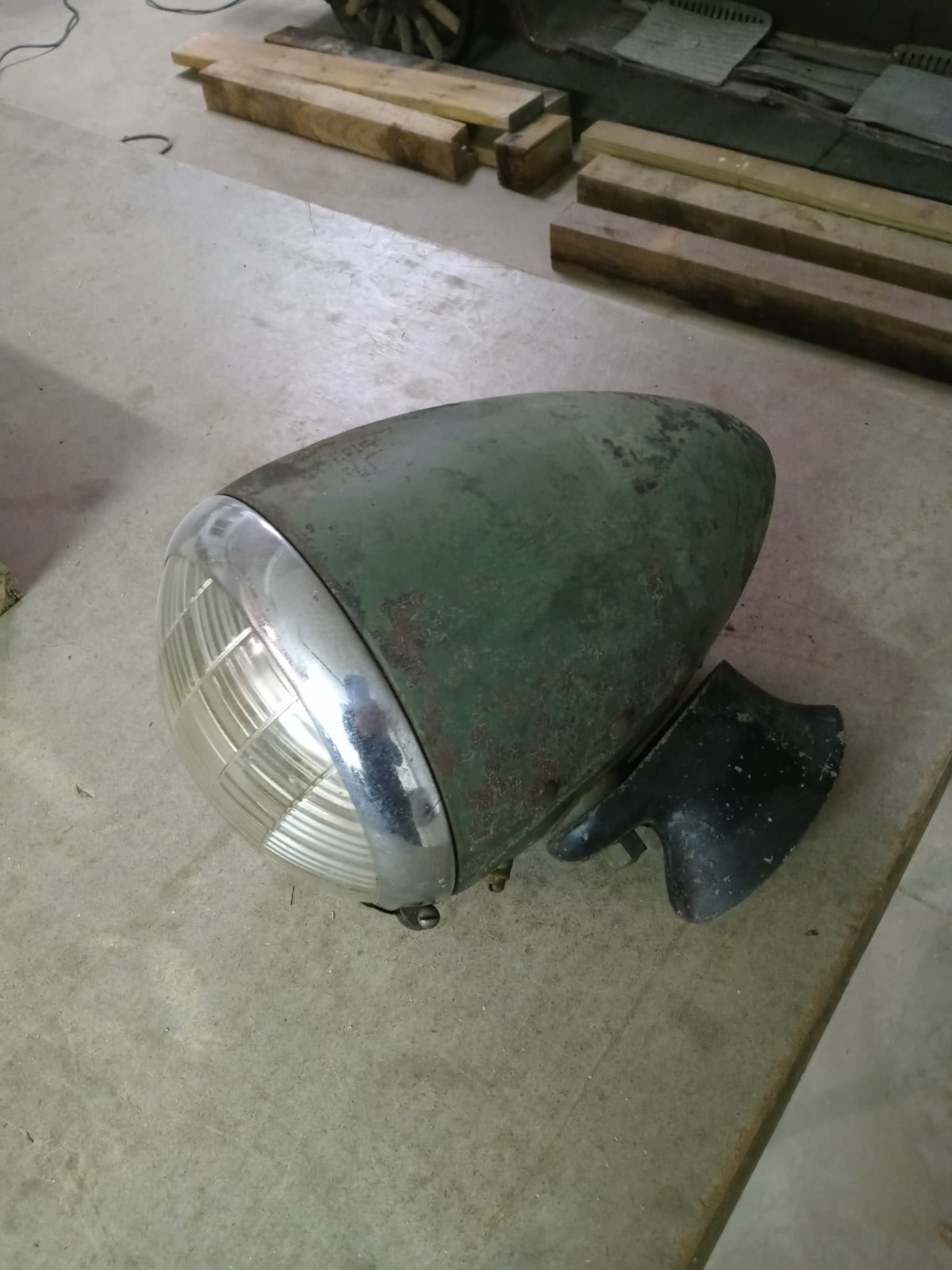

    Picked up a pair of 1935 Buick headlights. Might use them. Might not.

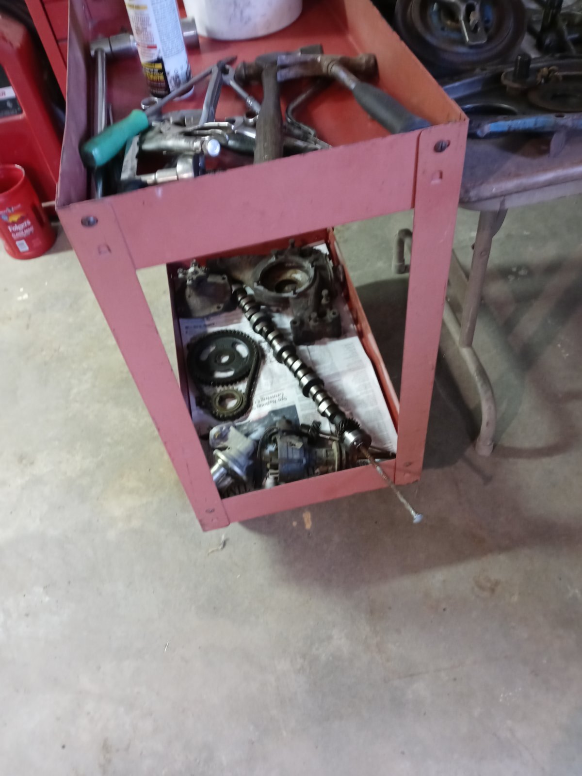

    Disassembly for inspection and upgrades. Looks good. Pretty much what I hoped I could expect to find from a motorhome engine with 33,000 miles. Quite clean internally. It's been sitting here for a couple years now. A few bugs got in it and made nests. But once in a while, I'd spray it good with WD-40, and that luckily counteracted any icky stuff.
    Just some normal carbon buildup in the combustion chambers. Debris from the bugs. Cylinder walls look good. Some cross hatch remains. Almost no ridge. Cam and lifters look great with a nice light wear pattern. Water pump feels like new. Timing chain is looser than I expected.
    - Still have to remove rods and pistons so I can lightly hone the cylinders. Inspect the crank and bearings. I expect minimal wear.

    I don't think the aluminium heads weight saving will be a big issue in a light roadster (Yes, I know I spelled it with the extra "I"). A 440 cubic inch engine with a high torque cam and all the extra tricks to match will be more power than you will be able to make stick. Man, am I happy to see you on your way. Can't wait 'til you start on the frame/body.
    rmcroadster, Stogy and Rickybop like this.
  14. gene-koning
    Joined: Oct 28, 2016
    Posts: 5,422
    gene-koning
    If the heads you have are in good condition (are they motorhome heads, or regular production heads?) and don't need a lot of work, I'd stick with the iron heads, but if they need stuff done, the aluminum heads might be a less expensive direction to go. At least that is what I've heard.
    Aluminum heads will help keep the under hood temps down in the summer.
  15. Rickybop
    Joined: May 23, 2008
    Posts: 10,521
    Rickybop
    That's right... I don't really need 500+HP with the aluminum heads.
    475HP will be fine.
    LOL
    It's also absolutely true that you can come out ahead by just cutting to the chase and buying aftermarket heads instead of refurbishing the old ones.
    But I might have access to equipment to do the refurbishing myself.
    I expect to find that the original heads are in very good condition. I may decide to use them and not worry about bumping up the compression. Good flow does more than high compression. The cam change is going to make way more different than a point of compression.

    I've heard there might be some weird motorhome heads out there, Gene... but not on all motorhomes. Something to do with the way they connect with the water pump. But these are the same as on passenger vehicles. Nothing weird about 'em.
    Stogy and oliver westlund like this.
  18. gene-koning
    Posts: 5,422
    gene-koning
    Back when I was playing with Mopar big blocks, most motor homes had normal heads, but towards the end of big block era, motor homes got special heads with added cooling around the exhaust ports. Strange looking and heavier.
  19. AmishMike
    Joined: Mar 27, 2014
    Posts: 1,332
    AmishMike
    Do not remember & can not find year of your engine. Reason I ask, do heads have hardened valve seats for “modern” unleaded gas? If not, believe you can get by with gas additives & low mileage.

    Given my druthers, I'd opt for the closed-chamber heads, w/tight squish, like ~ .040-> maybe .060". Helps w/combustion events, & is artificial (free)octane.

    Good quench with a closed chamber head and hardened seats or not. Definitely two important considerations when I'm deciding which heads to use.
    Thanks, guys.
    Yeah, nobody's gonna know what it is. So they'll figure it's a Dodge. And they'll be right.

    This engine is from a 1978 Dodge motorhome. So yes, the stock heads would have hardened valve seats. And that's a good thing.
