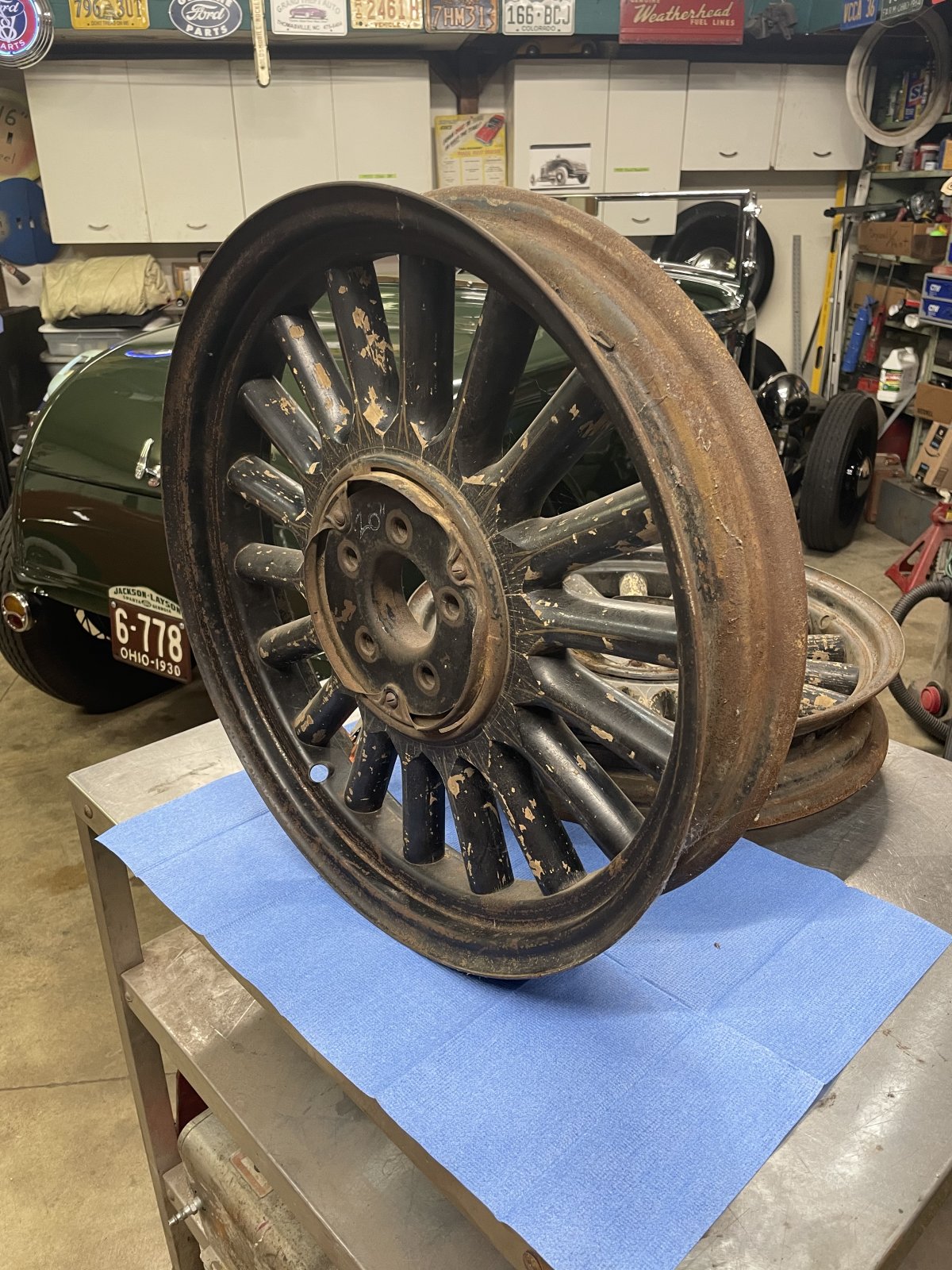

    Special racing wheels coming

    Them some nice chariot wheels - how many ponies ya got

    Hey, Ricky;
    I forgot to mention in the ?-wheel thread, the proper paint goes a long way to keep these things alive. I'd use the same type of enamel(iirc. Which absolutely exact version - idk.) to refinish them. Oh, don't forget the cool pinstriping. I'm sure it's a requirement for long life, + those long cool stares from the hot chicks... :D .
    Marcus...

    Thanks, wiz.
    I was wondering about that.
    In fact, I've often wondered about the feasibility of applying automotive primer and paint to wood and if there are better options.
    Actually, I'm most likely to let the beauty of the wood show through. Strip, dark stain and clear. I'll have to research to find out what type of clear is best to use in this instance.

    I would recommend this. Used it many times on exterior wood, and it works great, but typically only last two years. Might last longer it you don't park your buggy outside year round, though. Don't go any glossier than Satin IMHO, and it does smell pretty bad, being oil-based:

    Yup. Thanks, Mr. Pinkerton.
    I've always used urethane on my nice wood projects.
    I'm just not so sure it's the best for wet environments.
    Water can sometimes leave temporary or even permanent white spots on a nicely urethane-finished table.

    Start thinking "wooden boats".......

    Ford used some kinda enamel that wore forever. Look at the early teens stuff, think they may have used JapanDrier also, but it was a "flow-the-paint-onto-whatever-&-let-it-run-off-into-trays situation. Then let it harden, but it couldn't have taken too long, just due to sales volume. Wheels done similar, but ahead of time of course.
    I've read of other mfgrs doings, of course, just don't remember where, whom, or what. The old car mags that covered this historical stuff are long-gone-dead. Cars n Parts was one, Old Cars was another. AACA probably has some good info on this. I'm not altogether convinced that new products/materials are *always* better, in every case.
    I suppose you could put a resin coating that soaks into the wood(boats, decks, house frames[imposible-to-reach-locations] to offset the rot/decay - which I realize those wheels don't have, but would seal the pores/grain up real tight, 'till it starts to fail. One of the problems I found w/that stuff is, that it soaks wonderfully into soft/damaged wood, but hardly wets good wood. Endgrain soaks no matter what) on there, but I'd guess that it'd get hairline cracks from the flexing & w/o a solid paint to protect from UV, would die back quickly. & you'd be worse off than you were when you started. Before I used urethane, I'd use Caseys' gun-oil, or furnature tung-oil(lots, as in many, coats of this stuff - & that's a load of work. ;( ), anything that can be renewed as needed - 'cause they will. Maybe another type of paint would be the tar-based stuff, like used on some roofs, etc. No idea how long that would last.

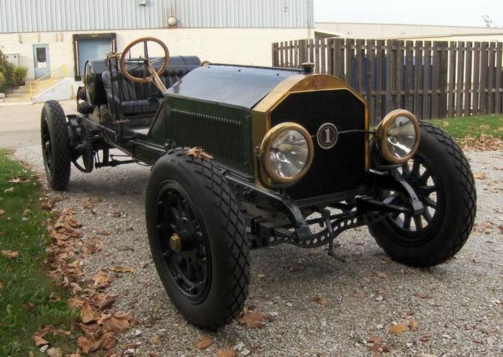

    "Gas buggy"
    Probably not. LOL
  25. Rickybop
    Joined: May 23, 2008
    Posts: 10,758
    Rickybop
    More like...
    brEad, chryslerfan55 and twenty8 like this.

    hey, Ricky;
    The antique mill makes it. You can always do/re-do/finish the body to a later-era rod. Keep the 440 for a streetrod.
    :D .
    If you're real-careful-like, w/just a few extra parts, you could end up w/2 hotrods outta this.
