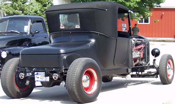

    Like this?
  2. Rickybop
    Joined: May 23, 2008
    Posts: 10,697
    Rickybop
    Basically, yes. A little bit longer in the doors and body. Chopped top, lower seating position. Longer front frame rails to accommodate the big engine and parallel leaf springs.
    1922 Dodge Turtle deck Roadster

    I do like the shape of a Ford Model T turtle deck. And no rusty expensive unavailable quarter panels or decklid needed. Maybe a little easier than building a whole body. And rear wheel position won't be dictated by a wheel well.
    I've been looking at this one. I need good metal. There's plenty enough to do... I don't wanna spend a lot of time doing rust repairs. It's in great condition. Spoke with the seller, got a good price. Going to get it Saturday. Only a 2-hour drive this time.
