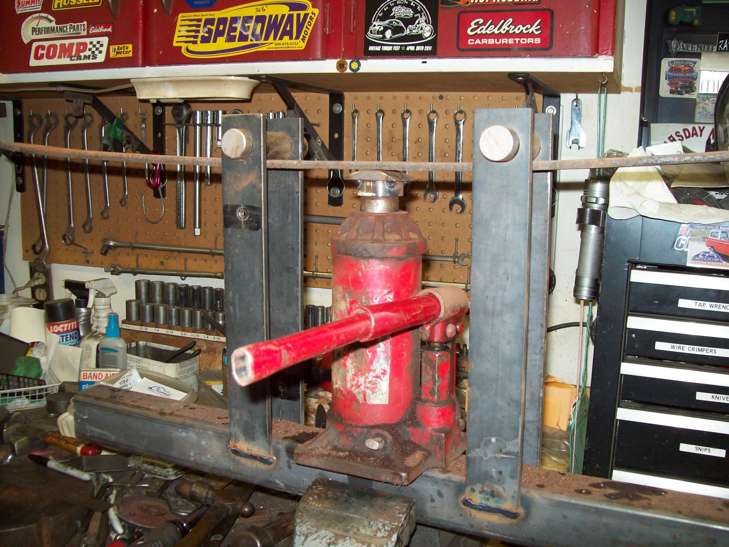

  10. blue 49
    Joined: Dec 24, 2006
    Posts: 2,052
    blue 49
    from Iowa
    Here's a simple press that does the job.
    Blue

    scrap metal 48
    How big a bottle jack do you need to do it yourself???

  15. "How big a bottle jack do you need to do it yourself??? "
    I did mine with a 3 ton but I think all you need would be a 1 1/2 ton.
