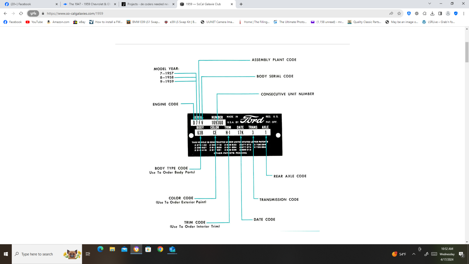

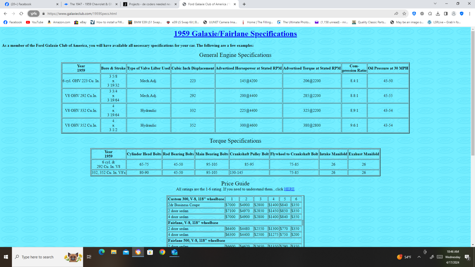

    Could be a 332. https://www.galaxieclub.com/1959Specs.html
    This is the page you want, All the nitty gritty on a 59 Galexy
    https://www.so-calgalaxies.com/1959 Screenshot (1245).png Screenshot (1246).png

    Ok first part of the sn is B9KS does that help any? The nitti gritti site won't come up thru that link.
    Thanks for all the help

  10. Yep, a 332 and a 2-speed Fordomatic. Both of these are orphans. The 332 was only around for two years ('58-59) before being discontinued, the trans was a '59-early '65 piece when it also disappeared. With a 2.91 rear axle ratio, this was ordered with fuel economy in mind, not performance.
    The 332 may be a solid-lifter motor as Ford added hydraulic lifters to it midway through '59.
